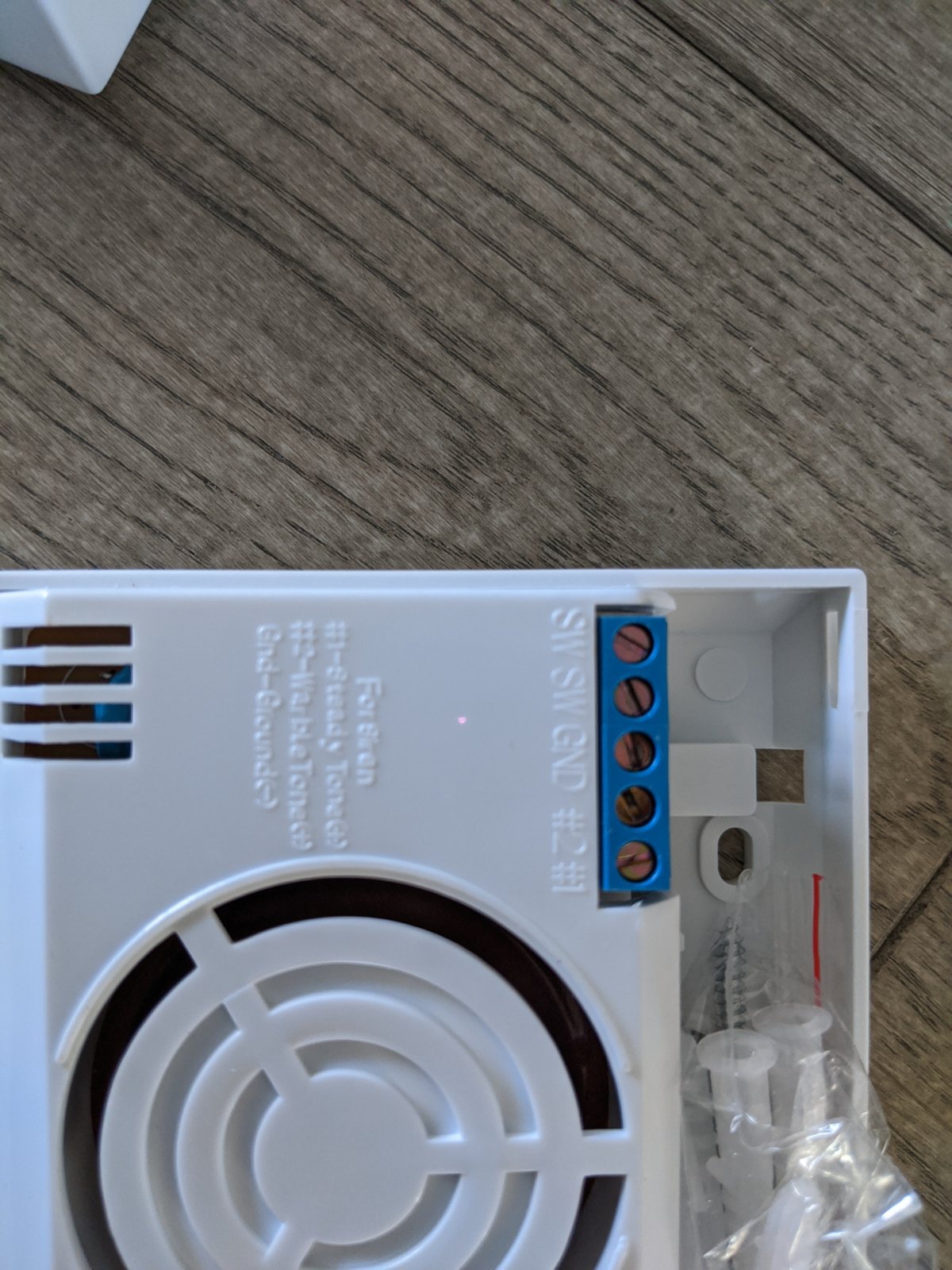

Hi
I would like to wire a internal sounder to my Honeywell g2-20 alarm.
It's a CQR SO/ALTO/WH/G sounder
I have attached a pic of the terminals
Please can someone tell me which wires on the internal sounder go to which terminal on the Control Panel
Any help would be much appreciated
1 to +12V at the panel for steady tone and the GND to the bell connection (symbol of bell on panel pcb).

I just wanted to double check that the GND goes to the bell symbol for the SAB Connections below.
I already have an external sounder so I am guessing both the external sounder and the internal sounder will both have a wire going into the bell terminal.
Also is the Loudspeaker Negative terminal not used for the Internal Speaker at all
Yes to the first question. You didn't show a speaker. A speaker goes to +12v and the other speaker connection to the speaker output on the vertical block of terminals.
