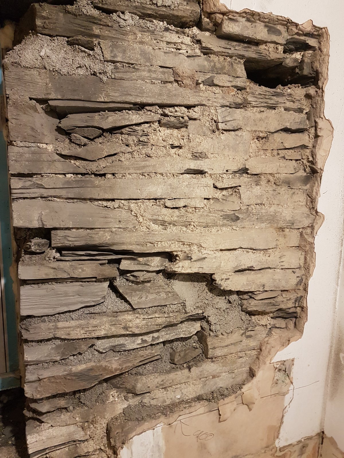

I own a fairly old house, built around 1900. Solid stone (slate) walls, approx 12"-18" thick.
I want to improve the EPC of the property and was advised internal wall insulation should help keep it warmer, reduce bills & improve EPC. Currently have 300mm in loft.
How effective would this be on an old building with thick solid walls? I was thinking 60-70mm Kingspan k118 (with plasterboard attached). How would I apply this to solid stone walls? Via battens mounted on a breathable membrane?

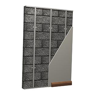

I've worked on a few refurbs of Victorian buildings where the internal PB was mounted onto Gyplyner with an air space between the wall surface and the back of the insulation. The Gyplyner system uses channels located into floor and ceiling tracks and held off the original walls with little folded metal brackets. This shows a close fitted version, but you can space a lot further off the original wall with extra insulation between the channels:

How would you insulate this wall? Cost is a big factor, as well as the amount of work/time available to do the work.
