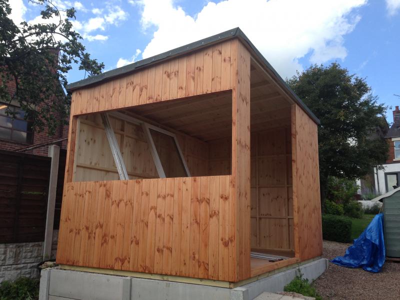

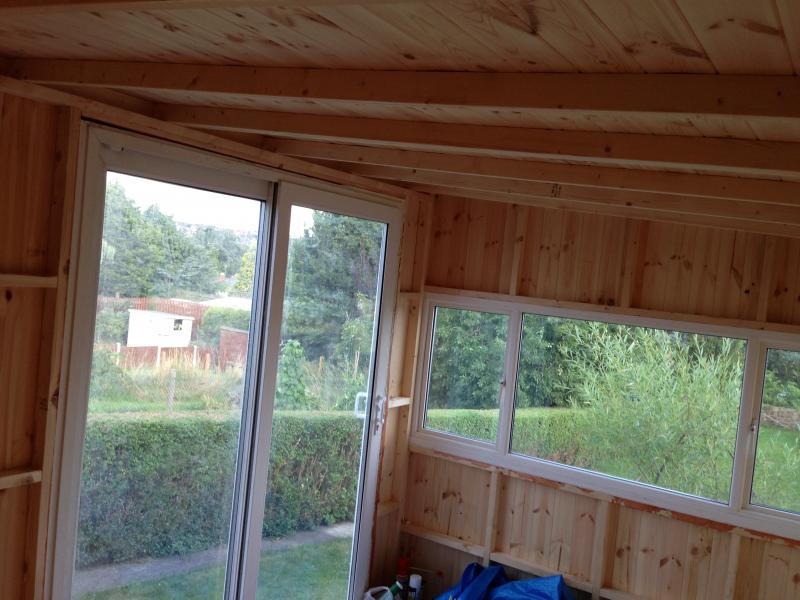

Construction wise it’s a simple timber frame (2x4s) clad with ¾ inch vertical boards (approx 4 inch wide). No waterproof membrane or anything hence my concern over the standard plasterboard. I was intending to keep the insulation boards off the outer wall with a thin section of beading.
I’ve uploaded a couple of images (sorry for the quality but I think you get the idea).
[/img]
Not ideal. Any moisture getting past the cladding will need to go somewhere. It's fine as it is, its basically a shed. But you should consider adding insulated plasterboard over the internal walls, this will leave a good sized airspace behind the cladding but will eat into your roomspace, and leave deep window reveals. Not perfect, but it's what I'd do.
Oh, and use a breathable treatment on the outside. No gloss paint or varnish!
