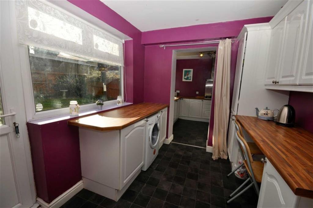

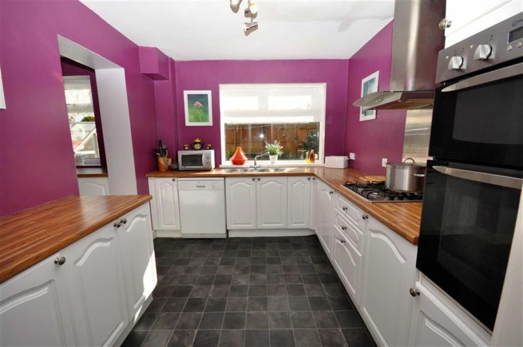

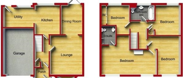

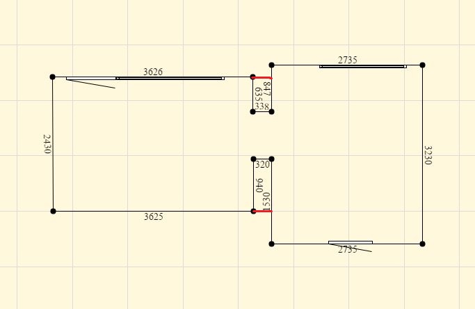

Hi All,
We're looking to have our kitchen/utility room redone but before designing the kitchen etc, we would like to open out the existing kitchen/utility to create more space.
There is already an opening that i'm assuming was done by the previous owners of the property.
Attached are some pics showing the current layout and I've marked with a red line where we'd ideally like to remove to.
Just after some advice on how big a job this could and what would likely be involved?
The house had a 1st floor extension above the garage/utility so the wall were looking to remove is below the old external wall of the house.
Hope the pics are clear enough?
Many Thanks in advance
There would be steel involved, propping (acro props), knocking out of walls, making good ceilings, walls, floors, re-hashing plumbing/heating and electrics and a chunk of money. You'll need a structural engineer and BC approval.

Is this bread and butter stuff for a competent builder or is it a complex job?
Not especially. Easy for an inexperienced bod to get wrong though.
Would you imagine there being any disruption to the bathroom above? We're having that redone soon and I'll have to change the order around if we'd have to rip it back out again.
It can depend upon which way the joists are running and whether you want the beam to be visible or hidden in the floor space. Otherwise no disruption to the bathroom. The kitchen ceiling is best being sacrificial in terms of access rather than lifting floor boards upstairs.
Aby idea of a high level estimate for the work? 1000s?
£5k ish depending on where the cut off point is and what finishes you have in mind.
