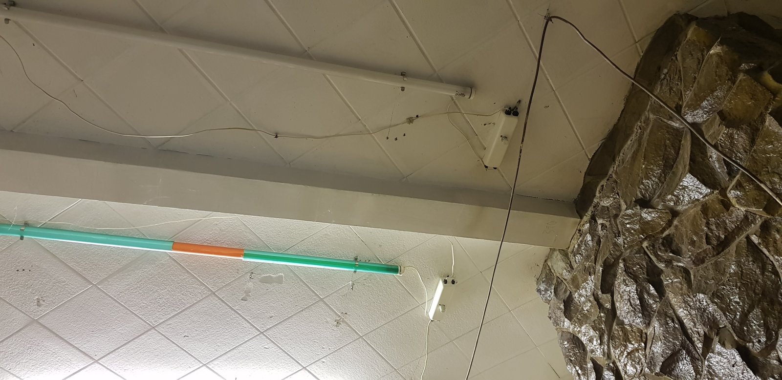

We've now moved in and have removed the fake ceiling in the front room to reveal what looks like a beam going through the chimney breast. I think this is directly below the wall separating the bedrooms upstairs. I attach a picture of the beam and the floor plan. Can we assume this is supporting the wall above?
I cant understand how this can be going through the chimney breast. Looking in the attic I can see the chimney seems to possibly go all the way through from the ground floor through the wall next to airing cupboard (?) and then into the attic. However the size of the chimney in the attic seems to be much smaller than the chimney breast in the front room. Is this normal?
Yes that's normal. The chimney breast downstairs is usually built wider than the fireplace and flue enclosure itself, for aesthetics rather than anything else. The beam going onto the chimney breast will not be in contact with the flue brickwork.
It might be holding up a partition wall upstairs, and/or possibly the floor joists - no-one here can say - only you would be able to check by measuring, and lifting carpets.

If the beam does support a load bearing wall upstairs does that mean there was originally a wall downstairs too?
Just to add to this, if you look at the picture of the beam you can see it's on top of the polystyrene tiles. Not sure what this means..
I wonder if it is a ventilation duct rather than a beam. Measure it and tap it. Plasterboard? plastic? wood?
And please get rid of the polystyrene tiles - fire risk!
Seems to be solid wood, not hollow at all! Polystyrene tile removal in progress
