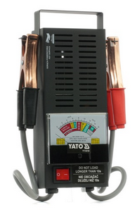

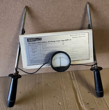

I used one of these 1720059137285.png for years, I am sure well over 10 amp. Also dangerous, as the spark could ignite any gas, then these 1720059291078.pngcame along, so pressed a button after clips firmly connected, but these
have come along since, and we tend to select well known makes, with a long pedigree in the auto trade, so Durite or Ring, the others may work, but can you trust them? But some are rather expensive, this one
