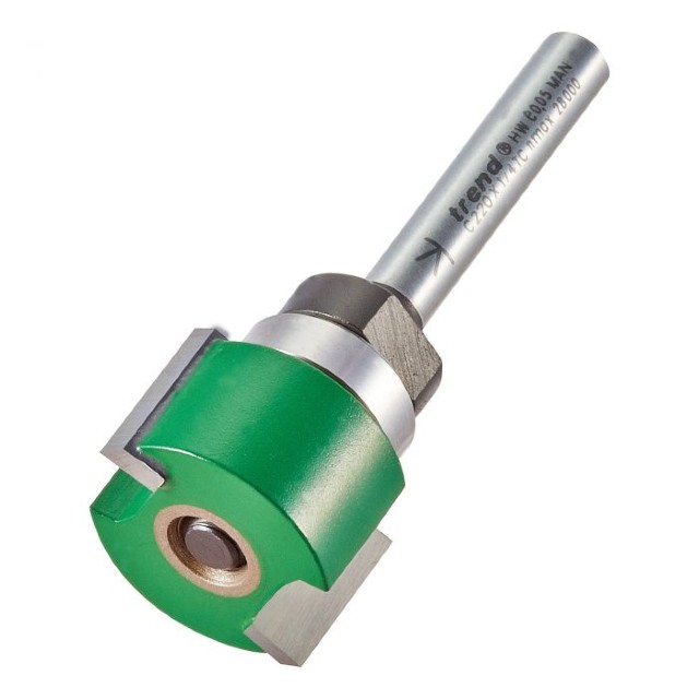

I'm afraid that's completely wrong. The combined cold smoke brush strip and intumescent seal has got to be centred on the door edge and is installed in a groove which is 4mm deep so that the intumescent part of thr combined intumescent/brush strip is flush to the door edge, not above or below that level. These strips have self adhesive backs. The best way to rout these in is to use a cutter designed for the job, like this one:
These intumescent cutters are available in 10, 15 and 20mm widths to match standard intumescent strips (which in the UK are mainly 4mm thick). 15mm is probably the most common width of combination strip we come across

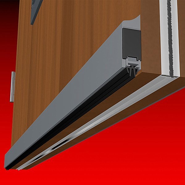

An alternative is to fit a close fitting hardwood (not metal, plastic or softwood) threshold on the floor which restricts the gap to 3mm or less
Instead of using a combined brush and intumescent strip you can fit a flat intumescent strip in a groove plus a "batwing" smoke seal in the corner of the rebate:

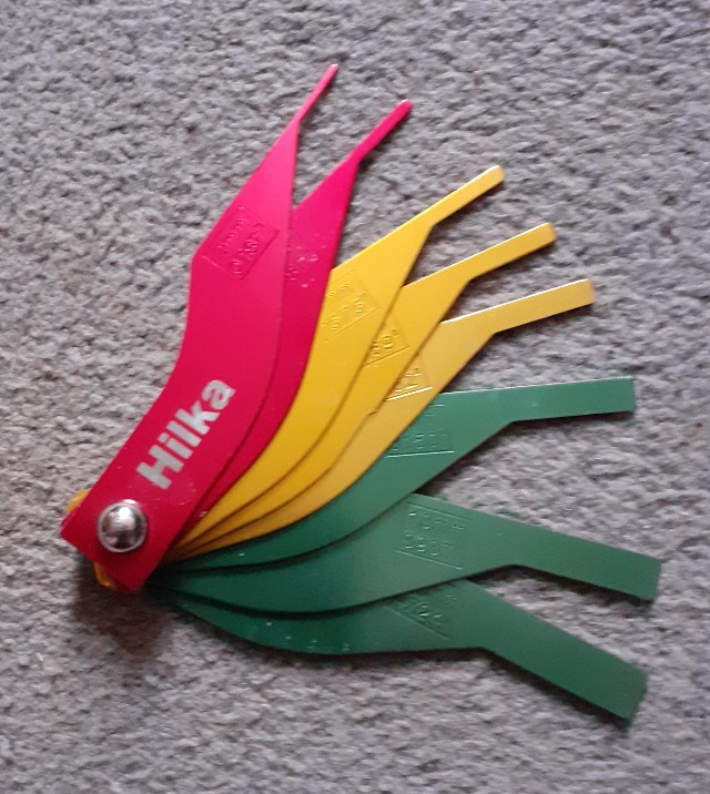

As an aside, for basic gap checking I have a set of Hilka brake calliper gauges:
Mine were checked with my Mitotoyu digital callipers and found to be within under 0.1mm of the stated sizes. I have tried taper (bore) gauges, but they tend to be really inaccurate and they always need to be checked when you buy them using something like engineering accuracy callipers before use (many are too inaccurate, you may get one in two or three good ones if you buy the Silverline ones, for example),. They should be discarded when they get bent (and they can get bent a lot checking gaps!)
