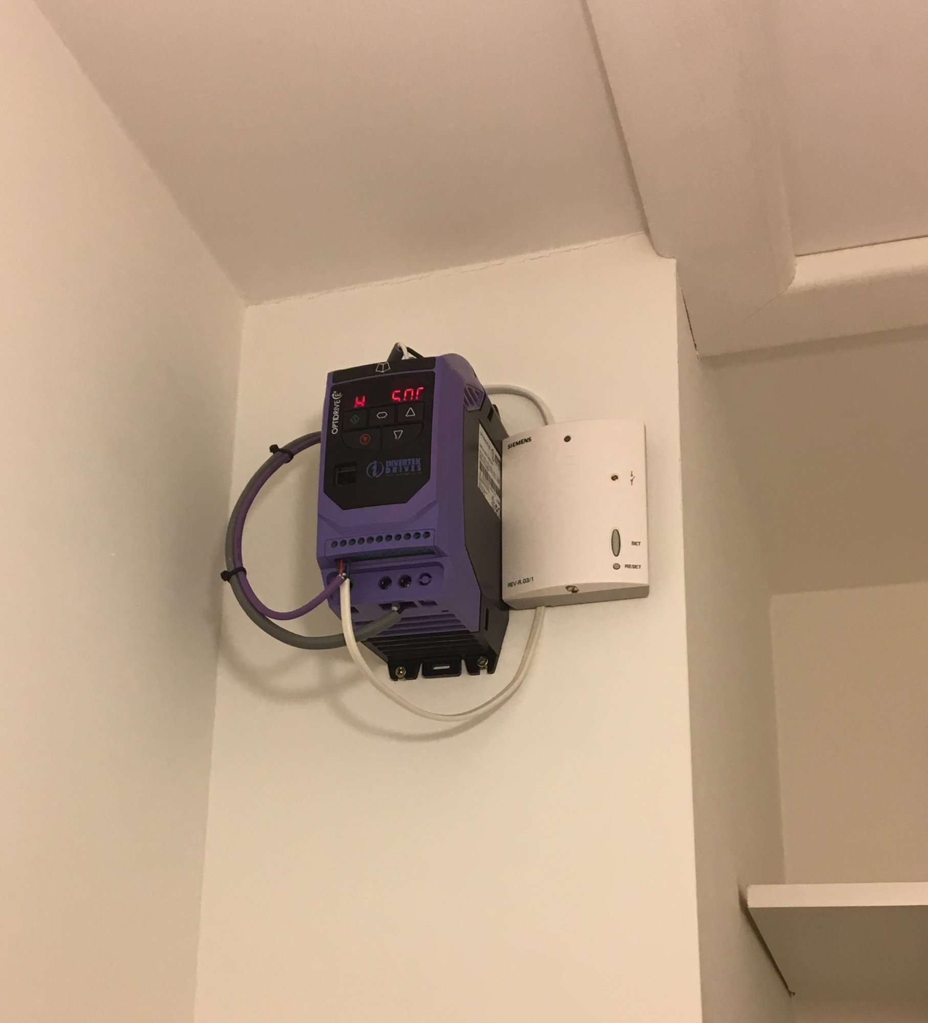

Missing its enclosure, I caused a problem at Uni, I was given a project, and it asked for any health and safety implications, I thought it was a prompt and the lecturer knew there were some and wanted me to identify them. I found the Alan Bradley PLC's we were using were designed to be mounted inside an enclosure, you could access live parts without a tool, and there were holes over 1 mm diameter on upper surface. I included the BS7671 reference and the manufactures data saying how the units should be used in an enclosure.
