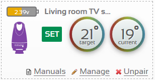

Mothers house I used the reading from the TRV head, Flat Battery TRV.jpg it current over target closed a little and if under opened a little, after of course it had been running for some time. With the modulating gas boiler this worked spot on, not sure how it will work with oil boiler?
