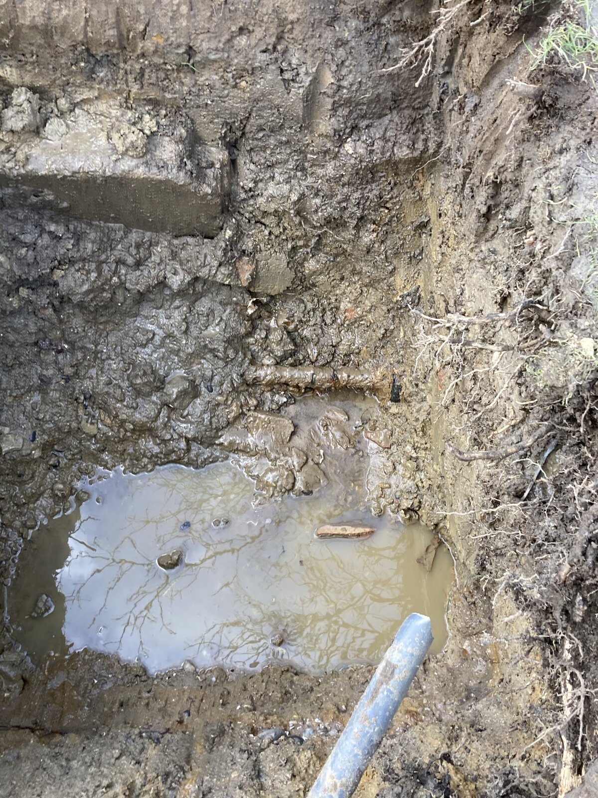

Other than a transition coupling, any recommendations for adapting to heavily pitted iron (1”)

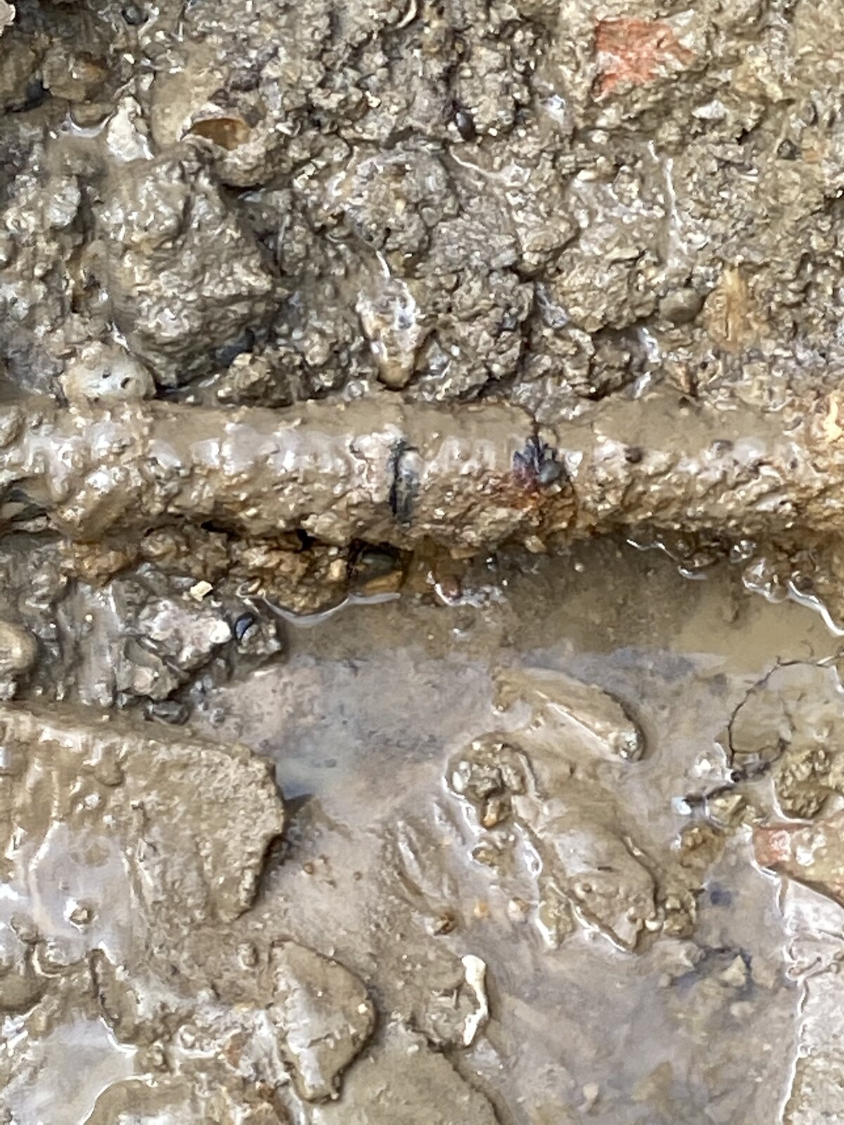

I suspect the slightest movement whilst cutting the leaking section out & it will just fracture further along.

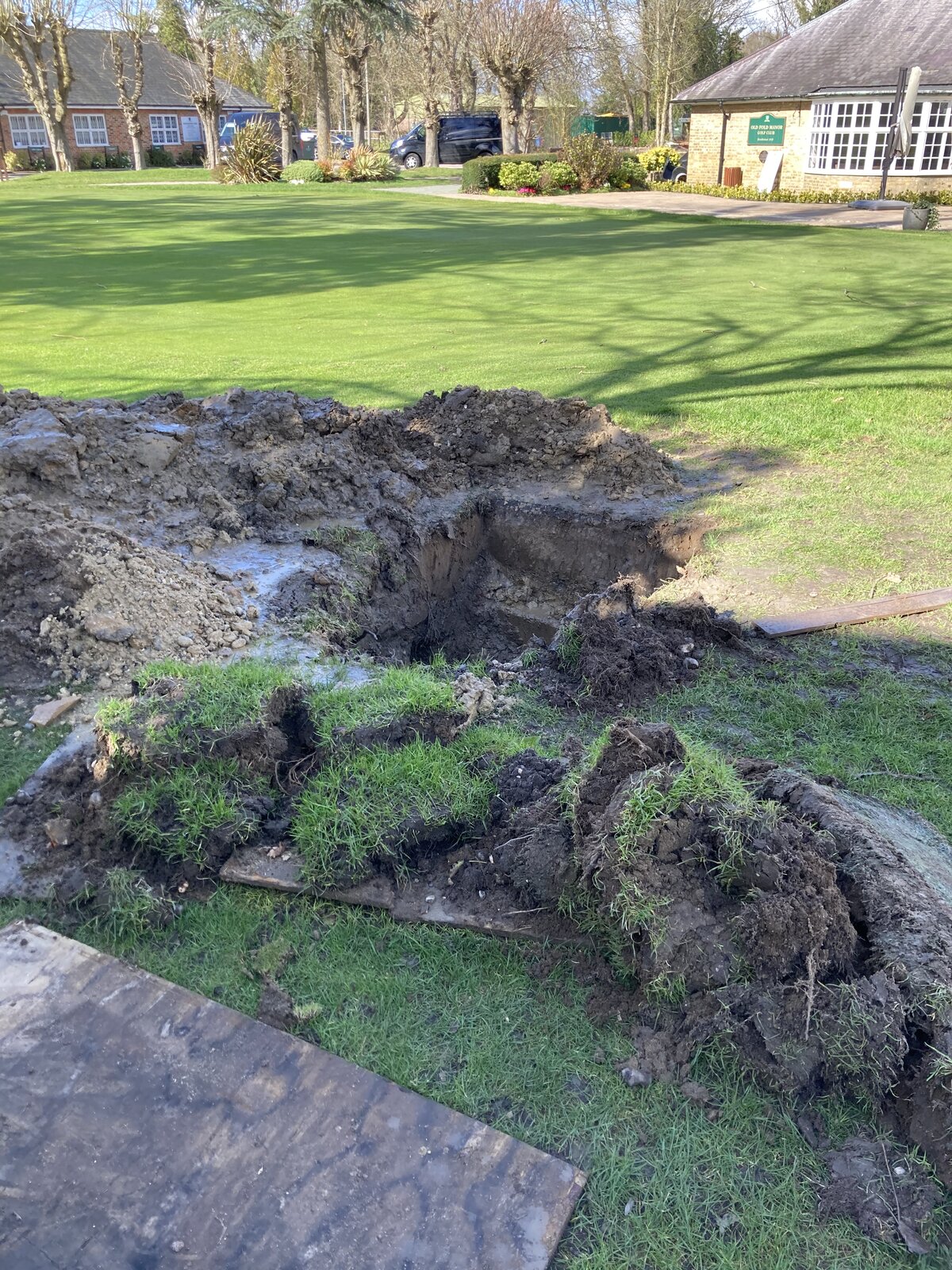

Nightmare at a golf club.
Not a chance short term.
We can’t work out what it’s feeding yet.
It’s either a clamp repair or cut & cap & see if it cuts anything off.
There are branches everywhere but I’ve asked if anywhere has occasional discoloured water & it’s a no. The trouble is, once I’ve cut it & if I do need to reconnect, there will be issues of fracturing.

You can normally tap all the crust off with a brick hammer to leave it clean enough for a connection with a Plass4 or whatever. Horrible stuff though, look inside it after you cut the section out :eek:
3rd pic looks like it’s gone on a joint so you might be lucky with the pipe either side.

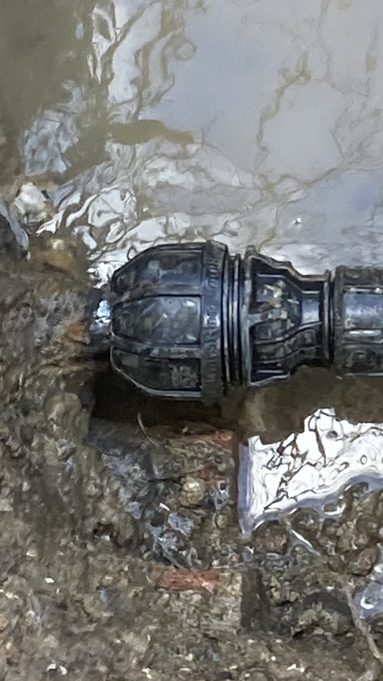

Did it today (finally) ground down the external until smooth, transition coupling (27 - 34mm) & capped it.

Btw, Ian. Yes you were right, it was on the socket.
