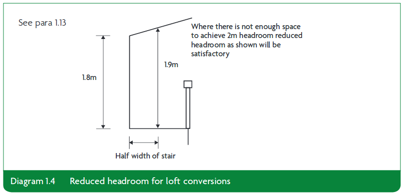

Just found the 2013 Part K documents online and it appears a reduced headroom of 1900mm is acceptable at the midpoint of the top stair, down to 1800mm at the edge of the stair. This is assuming the stairs are parallel to the ridge of the roof. Mine will be 90° to the ridge line, however there is scope to introduce a landing at the top of the stairs which would be within the existing brick stairwell. This would mean the headroom at the top of the stairs could be maintained. There would then be a small step into the bedrooms on the left and right.
I suspect your stair issue re. the headroom could be solve-able; there is a Code of Practice (BS 5395-4:2011 Stairs for Limited Access -- google it) which is more flexible than Approved Document K, and just as acceptable. There are also ways of arranging landings which side-steps (no pun intended) the guidance.
But your headroom of 1900 is very restrictive in the amount of useable space you could obtain.
