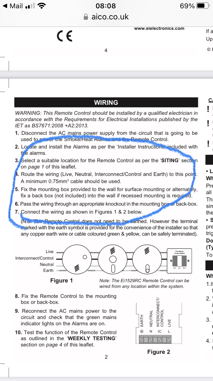

I have six Aico smoke alarms interconnected with 4-core cable. I would now like to add the Aico alarm control / test switch (Ei1529RC).
Would 3094Y cable (4-core 0.75mm²) be sufficient?
Doh! :oops: I had downloaded and checked the data sheet, but didn't think the install instructions would have helped! It seems obvious now ...in hindsight. Thanks TTC!
