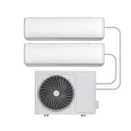

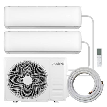

Have you considered air conditioning? A split system will cool two rooms with minimal noise, it can also be used to heat in the winter and takes both pollen and humidity out of the air as part of the process.
That would be nice, but that model costs the best part of a grand, whereas it looks like I can get a positively-reviewed purifier or combo purifier/dehumidifier for around £100-£150.
