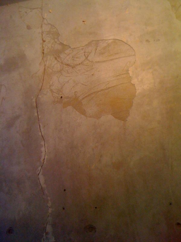

Hi,
I stripped all my front room Wallpaper away at the weekend with a view to tidying the walls so I can paint directly onto them.
Unfortunately a fair bit of the Skim Coat came away, some of the patches being around 50cm wide.
The walls are made up of Cement & Sand render with around a 3mm skim coat
Also as shown in the pic below, there is a worrying verticle crack around 4mm wide running the full length of one of the walls, this in the same area a Chimney breast was filled, I think it has settled after the work had taken place.
I was looking to patch this all up with finishing plaster such as this
http://www.wickes.co.uk/Finishing-Plaster/invt/224542
Then lightly sand after
From reading these forums I take it I would be wasting my time and effort as it would always be noticable after I painted??
If so would my best bet to get a Plasterer in to skim the entire room even though large parts of the existing Skim looks OK?
Also there is a lot of WallPaper Paste and Polyfilla (which is above the level of the Skim) still on the walls,
Would I have to wash the paste off and chisel the filler off (its rock hard) in preparation for new Skim Coat?
Thanks for your help,
Chris
Probably not a problem & is almost certainly salvageable; but its work that requires stripping back to the blocks & a reinforced repair if it’s not to crack open again in 6 weeks

I would knock off the skim coat either side of the crack and apply some scrim tape to the crack, you Will need to apply the scrim with neat PVA, just brush some on the crack, stick scrim on then brush on some more PVA.
The missing plaster and the crack can now be filled with plaster. In an ideal world the wall should be covered with a watered down PVA and Multifinish plaster.

Problem with using steamers is they will “blow” the skim coat off a render base if you apply too much concentrated heat; this may have contributed to your problems.

Regarding the crack in the wall, out of interest, how does a builder go about reinforcing? This crack must have been there years would it not have settled by now? it will still appear even after it is filled?
Is that an internal or external wall? Given the age of the property, I assume the external walls are solid construction & not cavity? If it’s an external wall, are there any corresponding cracks visible on the outside?
To make a decent repair, all the plaster & render base has to be removed at least 200mm either side of the crack to asses how bad it is. The repair itself generally involves fixing stainless steel reinforcing mesh overlapping the crack by 150 -200mm either side, re-rendering out to the surrounding wall level & then re-skimming the entire wall so you won’t see the repairs. Success rate is high but there is no guarantee the crack won’t open up again if the wall is still on the move.

Scrim will work if the crack is restricted to the fishing skim but with cracks of that nature, my experience is it’s through the base coat & often the blocks are cracked as well; local repairs & a large lump of reinforced mesh over the lot is the only cure in this case & even then it may crack again if the wall is still moving around.
Thanks for the suggestions , the crack is on the internal Party wall, it is where a Chimney breast once was and has been bricked/blocked up and rendered & skimmed
I'm no builder but would have guessed this crack is the where the edge of the new brickwork is (used to fill in the breast). I think it has settled and cracked the render and skim.
I've removed some of the skim coat and the crack is in the render too, although not as wide, only about 2mm

I would be quite tempted to run a grinder down either side of the crack and knock the reder off to examine the brick/block behind it. Then as mentioned mesh and re render then skim

That's your next move but I usually do it by hand using a hammer & bolster chisel. An SDS breaker creates a lot of vibration &, on an old wall, this can loosen the surrounding render & even cause further cracks to open up in the mortar joints.
Another method I’ve used if the wall is cracked & I think the chance of a successful repair using mesh would be limited is to first repair the crack with mortar, dot & dab a complete sheet of 12mm plasterboard centrally over the crack & tight to the wall, then dot & dab out the rest of the wall, tape & skim. You loose about 15mm but if the crack does open up in the wall again it won’t transfer through to the PB - if you’re lucky. :LOL:
