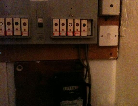

I've just bought a 1950s semi that needs a bit of work. The wiring to the sockets and light switches consists of red and black cable and an earth clad in gray PVC.
I need to add a couple of extra sockets and replace the old push button fuse box with a new CU. Does the whole house need to be rewired to do this so that the whole system is in the post 2004 blue and brown colour code twin and earth?
I've included a picture of the fuse box that the builder looking at the house took it's not the best picture but I'll try to get in myself to take some more.
Doubt you would "need" a rewire, would be worth having a Periodic Inspection done on the house to see what needs to be done though.
You can mix the cable types, just needs an extra warning sticker on the CU stating mixed cable types.
If you are going to be doing major renovation work and have not yet moved in, it's probably a good idea to get it rewired anyhow.

Don't let anybody talk you into a rewire unless they demonstrate quite clearly it's required. Check to see whether the lighting circuits have earth wires with them, you can do this by taking off light switches and seeing what's behind them. If no earth then you might need your lighting circuit rewiring if you want to put a modern CU in.
There is no reason to rewire a lighting circuit just because it doesn't have an earth, but you should not use metal fittings on that circuit.
Probably need to see if the water pipe has a wire going back to the CU.
But don't let anybody talk you into an unneccessary rewire. As cortinaV8 has said, you need the whole system checking out, and if they recommend a rewire come back here with the results of the test and see what people say.

Get a 'good' electrician to quote for a CU change, ask for a fixed quote including main earth, main bonding, meter tails and new CU, I always spend a good hour looking/testing before doing a quote for a CU change.
By the time you have paid £200+ for a proper periodic inspection your half way to paying for the CU change!
