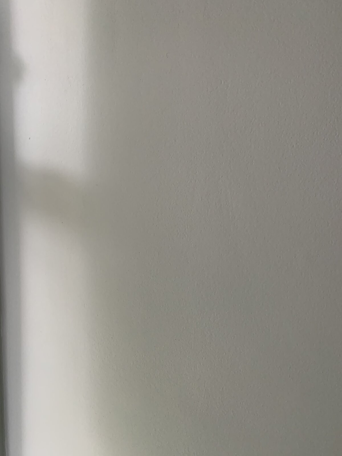

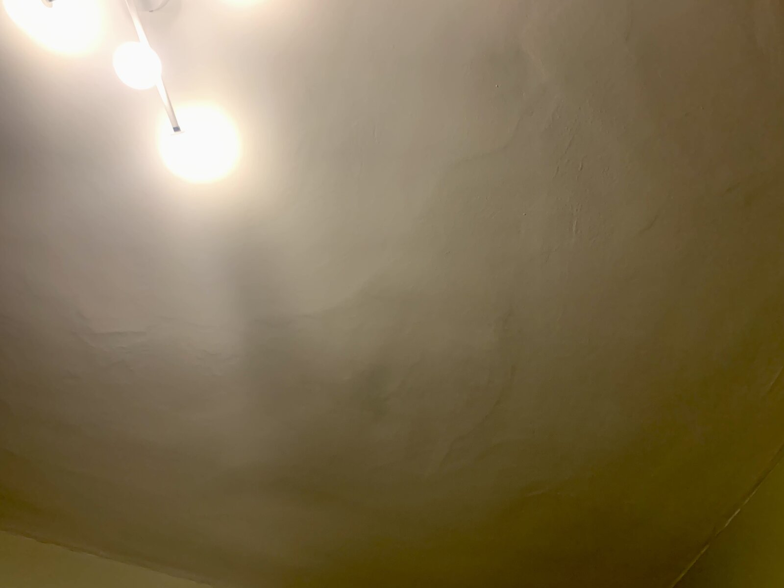

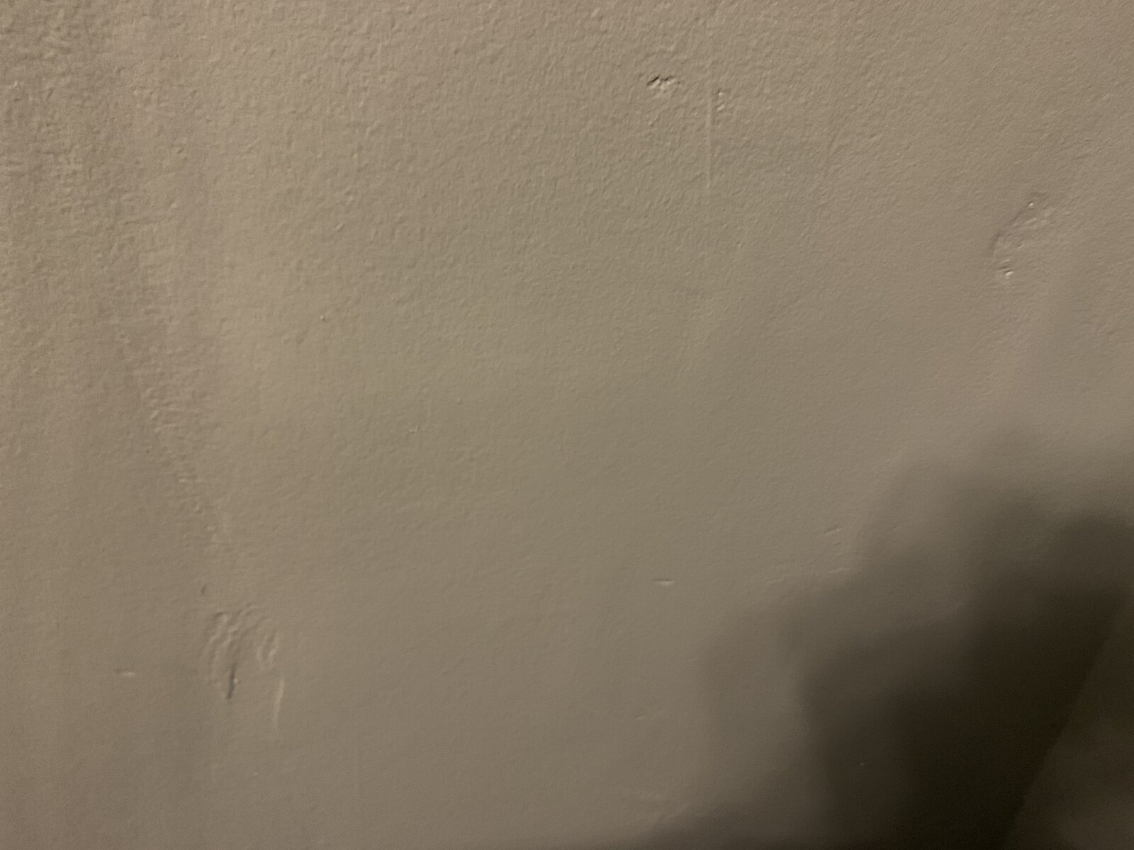

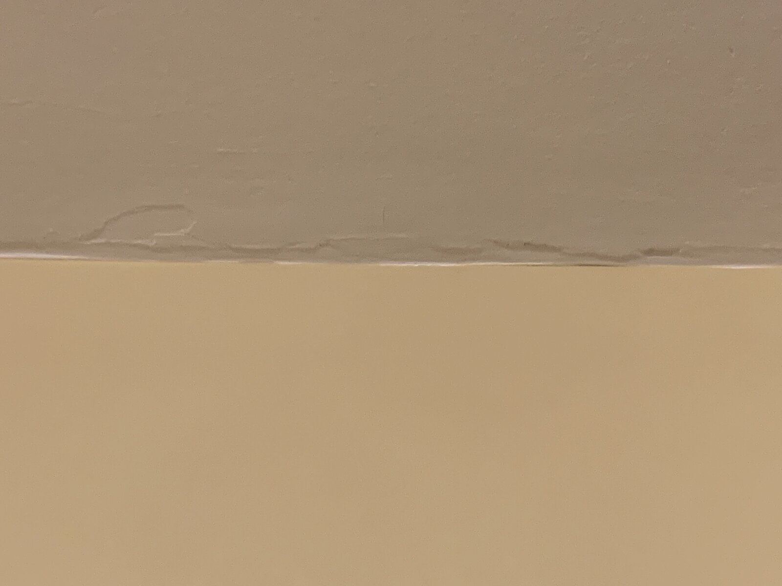

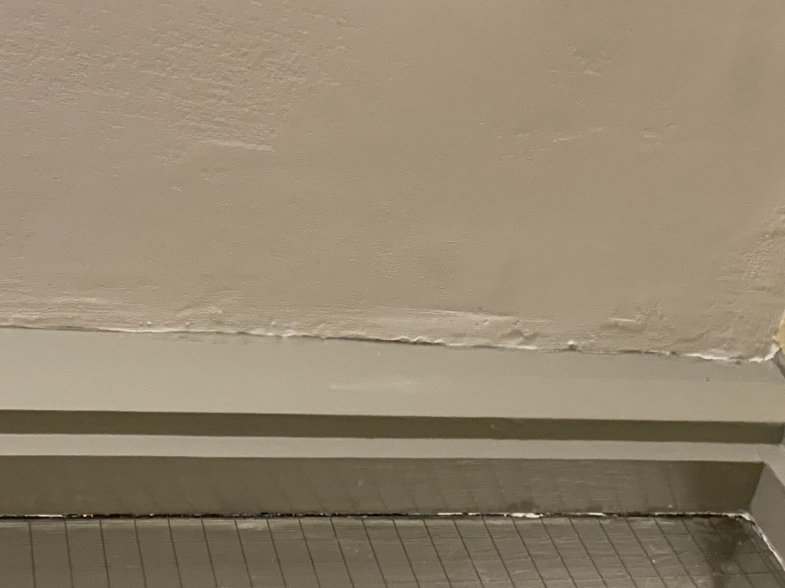

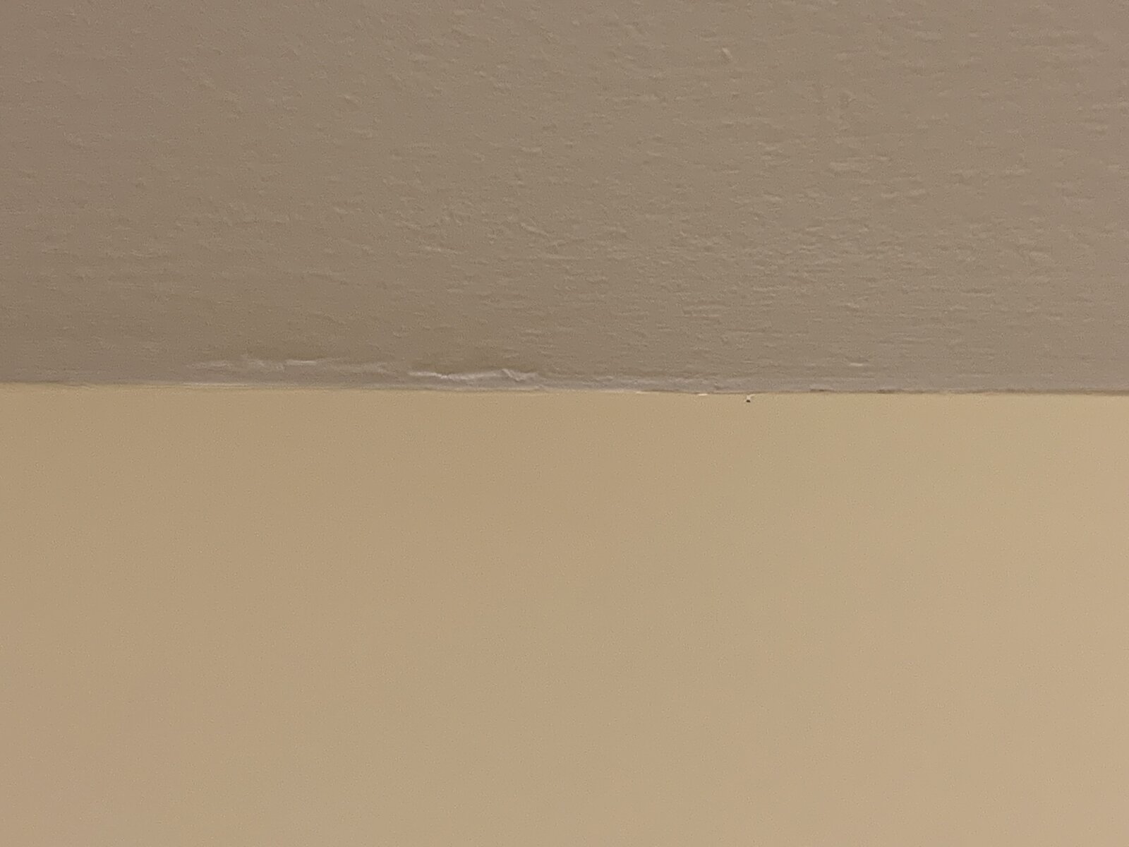

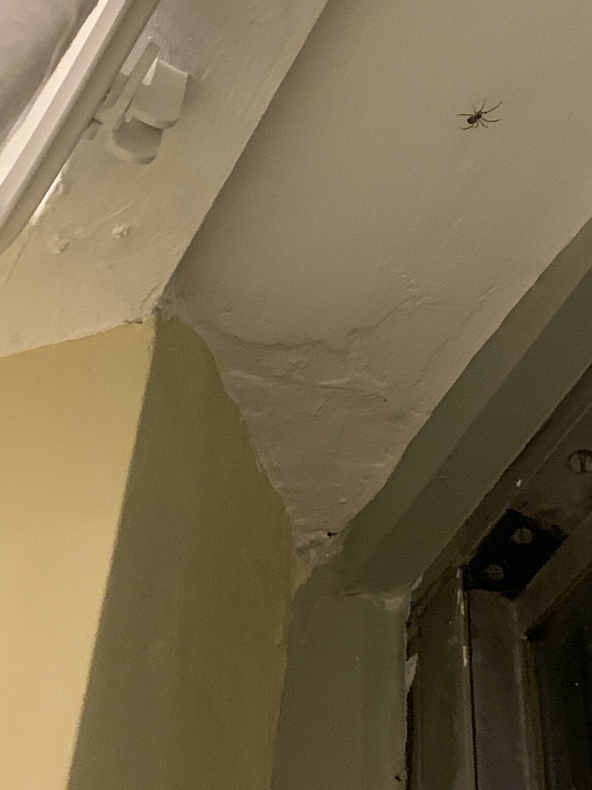

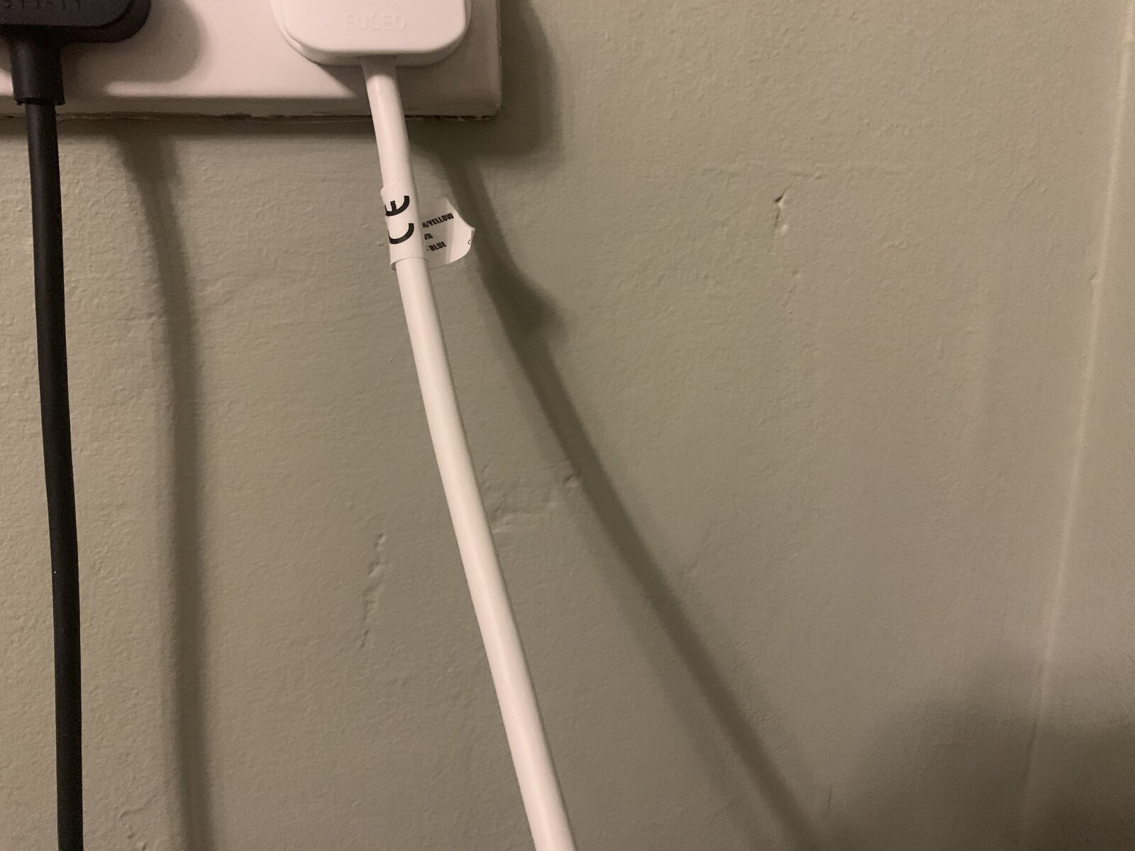

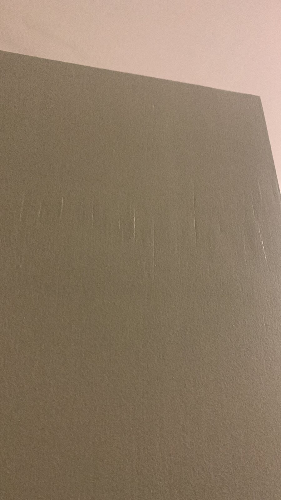

Hi everyone,
What’s your opinion regarding quality of painting and plastering on the photos below?
Not everything was replastered, only the ceiling on the first photo actually
Is the painter responsible to fill and sand everything or not? Is it ok he didn’t paint behind the radiators?
In case of plastering+painting, where does the job of the plasterer “ends”? He insists that the painter should fix all the imperfections after him?
What I see is quite annoying for me but maybe I do have inadequate requirements? Nobody wants to take responsibility that’s why I decided to post here to hear some independent opinions. The painter came and tried to sand few spots on the ceiling (after everything was painted and I complained regarding quality) and they now look even worse:(

Obviously it depends on if you asked the painter to fill all the holes visible before they quoted.
Plus is that first photo the newly plastered ceiling? That is awful. It would be the plasterers job to leave you with a nice flat ceiling. That looks very uneven.
When did the decorator give you the quote? Was it before the ceiling was done?
Is the plasterer saying it's the decorators job to fill and level that ceiling?
The decorator gave me his quote when the ceiling was already plastered but still wet
But somehow I couldn’t see it was uneven up until it was painted (I don’t know if he could, is it possible that it wasn’t before painting??), so I didn’t ask the plasterer to fix it before painting started and the decorator also said nothing to me when doing the job like “you need to redo this ceiling otherwise it’ll look ugly”
Yes, the plasterer is now saying it’s the decorators job to fill and sand the imperfections. He also did some ceilings and walls in other rooms and all is ok everywhere, so can’t say he’s generally not good at it
Yes I did ask to fill the holes before they quoted and they defo filled some on the walls, not all of them though, and forgot to fill the ceilings…
If you've asked the decorator to fill holes before painting and they haven't then it would be the decorator who needs to put this right.
However, that newly plastered ceiling looks terrible and no decorator would be able to just fill and sand that to look flat. It looks like it needs a whole new skim! Unless it's the photo making it look very uneven. I mean, just look along the edges. How is a painter supposed to cut in to that?

The plasteres done a crap job and the painter has done a crap job.
It all looks an utter mess - how much did you pay for this work ? I ask this as it is important, if you have went for really cheap then you have got what you paid for, good tradesmen are not cheap and don't leave a mess like what has happened, and good tradesmen won't agree to do a half arsed job for less money.
I take it someone has skimmed plaster over an old knackered ceiling ? I would be surprised any decent plasterer would have agreed to do that, it probably need pulled down and re-boarded then skimmed (but we're getting into money there)
Obviously I'm not talking about general holes and repair. I mean the painting itself in some of those picture is terrible. Is that a finished job around the window frame?
There's holes and then there's the above! The whole walls are uneven. To fill and sand it all to look flat would put days on the job and if that is what the customer wanted I would advise a skim!
I do agree in this instance it looks like both parties are cowboys!
Must admit I only looked at the photo of the green wall.
Looking at the others yea it would be a lot to ask to fill them, the decorator would have to put his on skim coat of filler on.
However if it was me as the decorator I'd have said I'm not painting the walls in their current condition. It'll be this much extra for me to make good, or I'd advise they get the plasterer back to redo it.

I mean, just look at that 4th picture. If that is the finished job wtf! Look at the green cutting in. I wonder if they had their eyes shut!

Actually green walls in general are not that bad
There are not so many holes in them, up to 20 all over the room
That’s why I believe it’s decorators’ job to fill and sand them because it’s not “days”

Just look at pic 4! You can't be happy with that painting!
I said days as in getting the walls perfectly flat and smooth. Filling some small holes is slightly different! Sounds very much like both parties have done rough jobs!

I am a decorator in London. I like to think that I provide an exceptional quality of finish. I seldom ever charge more than £200 per day (normally less- which explains why I am normally broke..) and I would never expect to repaint a whole room in 2 days (unless it was a room that I had recently painted. That said, for 2 smallish rooms, I would have probably charged between £800 and £900 (labour only) for each room but that would include sanding the newly plastered walls flat (using sanders connected to dust extractors) before applying any paint. It would also include sanding the previously badly painted woodwork flat as well.
Frankly given the quality of finish, I would not recommend your decorators. In their defence, the waves in the ceiling are down to the plasterer. I would ask him to replaster it. Minimising waves on a wall is one thing, it is much harder to sand them away on a ceiling because of the working angles.
Image 4 looks like the plasterer didn't apply a thick enough coat of bonding. Personally, if it were my home I would have asked for plasterboard (with the high spots of artex knocked off first).
