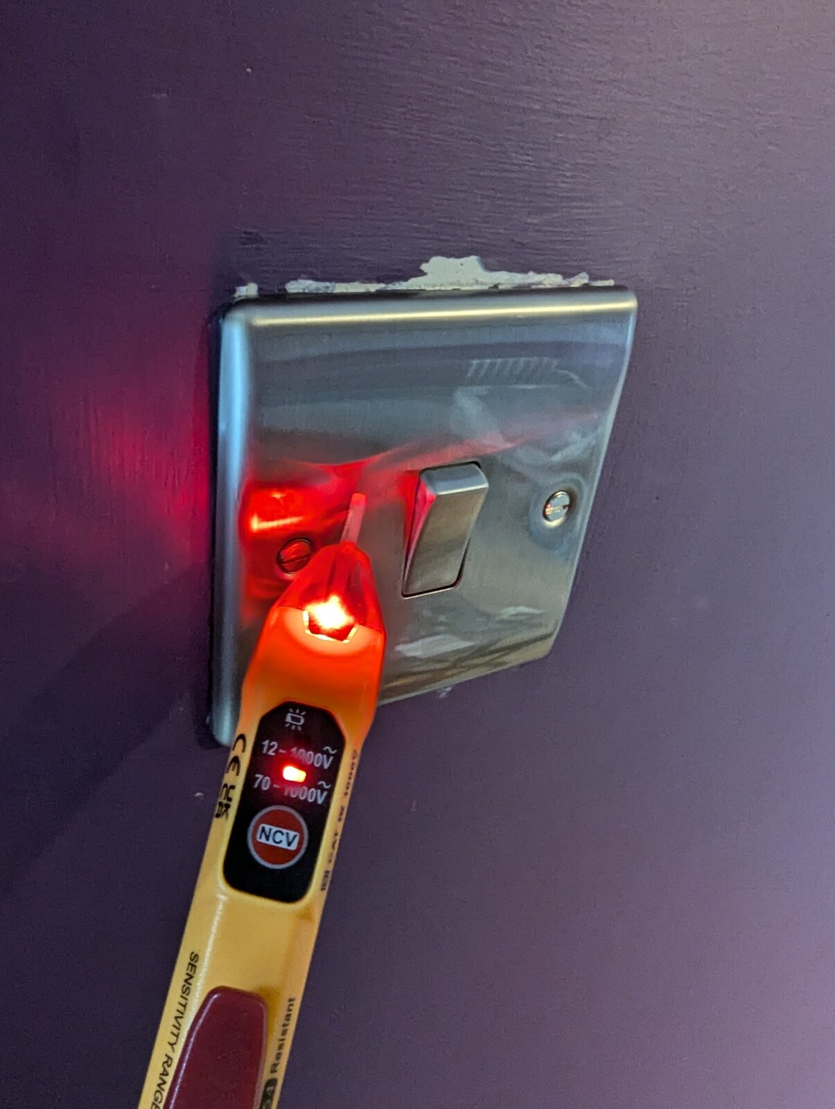

Is it normal to have a red light when the light switch is turned on?

Is that switch plate metal, or is it plastic pretending to be metal, I can't tell.
If it's metal, then the switch plate should be earthed, which should stop the non-contact detector picking anything up.
If it's plastic, then it's not something to worry about. By their nature, non-contact detectors can pick up live conductors without direct metal to metal contact.
Thanks that's a relief. Yes it's plastic.
I've touched the switch plate and screws with my fingers and no shocks
Just to say the detector would still light near the Line conductor if the switch was off.
It detects Voltage; not current.
NCVT shows green and not red when light switch is turned off. Does that mean I might have an issue?

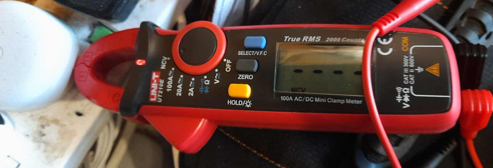

In my case, it is part of my multi-meter. What we often want is to test if there is likely power at a switch or socket before we remove any screws, contact voltage testers can't do that, be it a neon screwdriver or Avo Mk8 they all have their uses.
Shown is my NCV detector showing all four - so maximum voltage which it will detect as no contact volts. I would consider this as multi-meter, but in this mode doing the same as the pen tester shown by @iron1899 I have in all four testers with this function, the instructions for one as said, gives each - a voltage.
