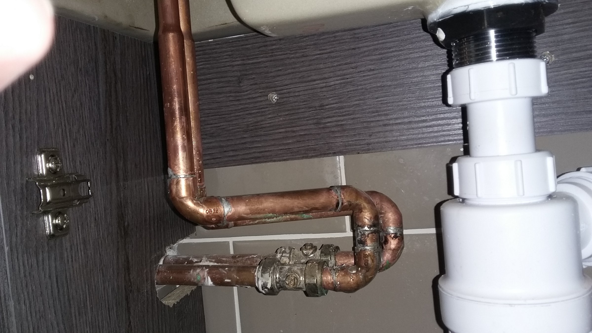

Is it normal to not use flexible hoses under sinks?

The plumber has used flexible hoses to connect up the taps everywhere else, but not for the downstairs WC sink.
Is this normal?

Depends on what comes with the tap, some come with flexi's some come with copper. He'll just use what's supplied.

If it wasn't for you men on the internet I would have thought this work below was good work.

As stated, either system can be used - although some taps come with flexi hoses that go into the tap directly as you have to use those flexis.
I personally think copper is the 'gold standard' -although it is more work (although shouldn't be hard for a pro)

I'd be more concerned by the lazy plumber not wiping the flux residues off the pipework :rolleyes:
