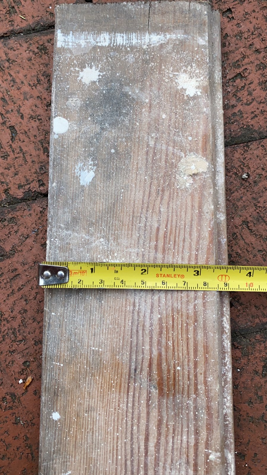

I’ve recently plumbed in a new rad upstairs and damaged a few floorboards getting to the pipes.
I need to replace them but i’ve measured and they’re 18mm thick 85mm wide, i can’t seem to find anything smaller than 119mm.
any help would be greatly appreciated
Have a look below to see what i’m talking about
Floorboard size

Looks closer to cladding dimensions, you could always replace the entire section with 18mm floor panel [chipboard]. Or cut back a larger section and replace with a wider board.

yeah i was thinking of cutting back a larger section and putting a wider board in, god knows wheres these tiny boards came from
I'd be looking to find a local timber supplier for 18mm thick timber - it doesn't need to call itself floorboard!
Get the right thickness and rip down to the correct width with a portable circular saw and clean up the edge with a sharp jack plane. It isn't that difficult

Decent timber merchant (not DIY sheds) will sell you PSE and rip and plane it down to the right dimensions for you. A really good timber merchant will tongue and groove it for you (but at a steep price- the rip & plane are usually free). A cheap router and some patience and you can T & G it yourself (done it several times to link old floorboards to moderns of the same thickness but different tongue and groove dimensions)

Yeah i did think that as my next option, i just thought if i could buy it ready done its easier isn't it
Yes, but I'm a chippie and so i sort of expect to have to do this sort of thing all the time. 85mm finished isn't really a standard width for flooring - anything that size would have been machined from 4in (102mm) sawn stock, so allowing for kilning shrinkage and machining loss the nearest you'd get would likely be 18 x 90mm finished, or more likely something like 18 x 112mm (ex-5in wide).
