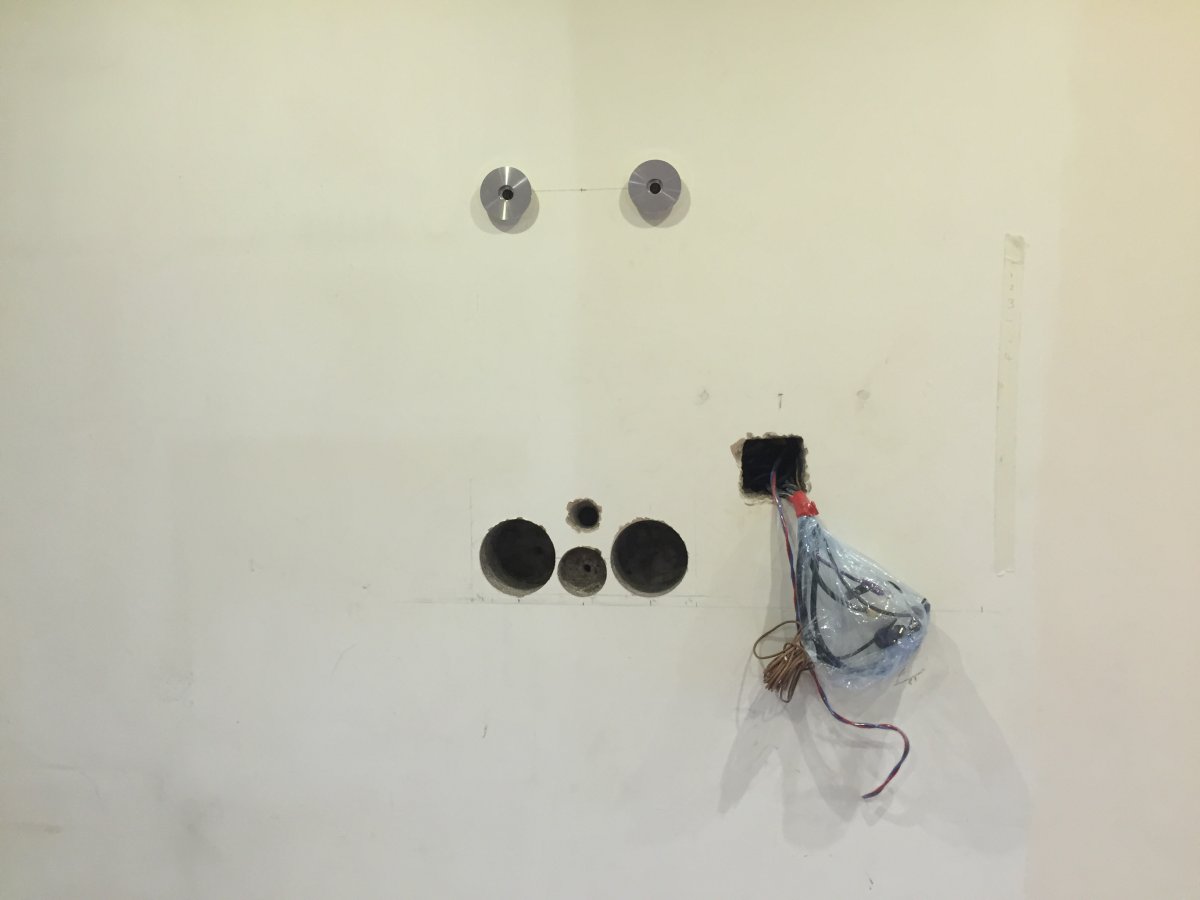

I am looking at doing the same - was even thinking of core drilling the speakers into the breeze block (for TV centre speakers/tweeter/base port) foaming the cavatiy to seal an air tight enclosure between the holes to form a block work speaker box. Probably would not have much bass but supported by front and rear ceiling speakers together with a sub - hopefull would sound ok for dialogue. The centre speaker seems the most important to get in the wall and not a ceiling.

Ok, I finally did it. Flush mounted a centre speaker behind the TV. I know this is a compromise and will never sound as good behind the TV but it certainly sounds better than the TV's speakers. Mids and highs sound surprisingly good
I formed the 'box' in the cavity by cutting rock wool slab into strips and blocking top, bottom and sides. Caulked round the speakers and found the bass port worked pretty well.
This will be teamed up with decent point-able ceiling speakers and an under floor sub to form a near invisible surround sound system.
