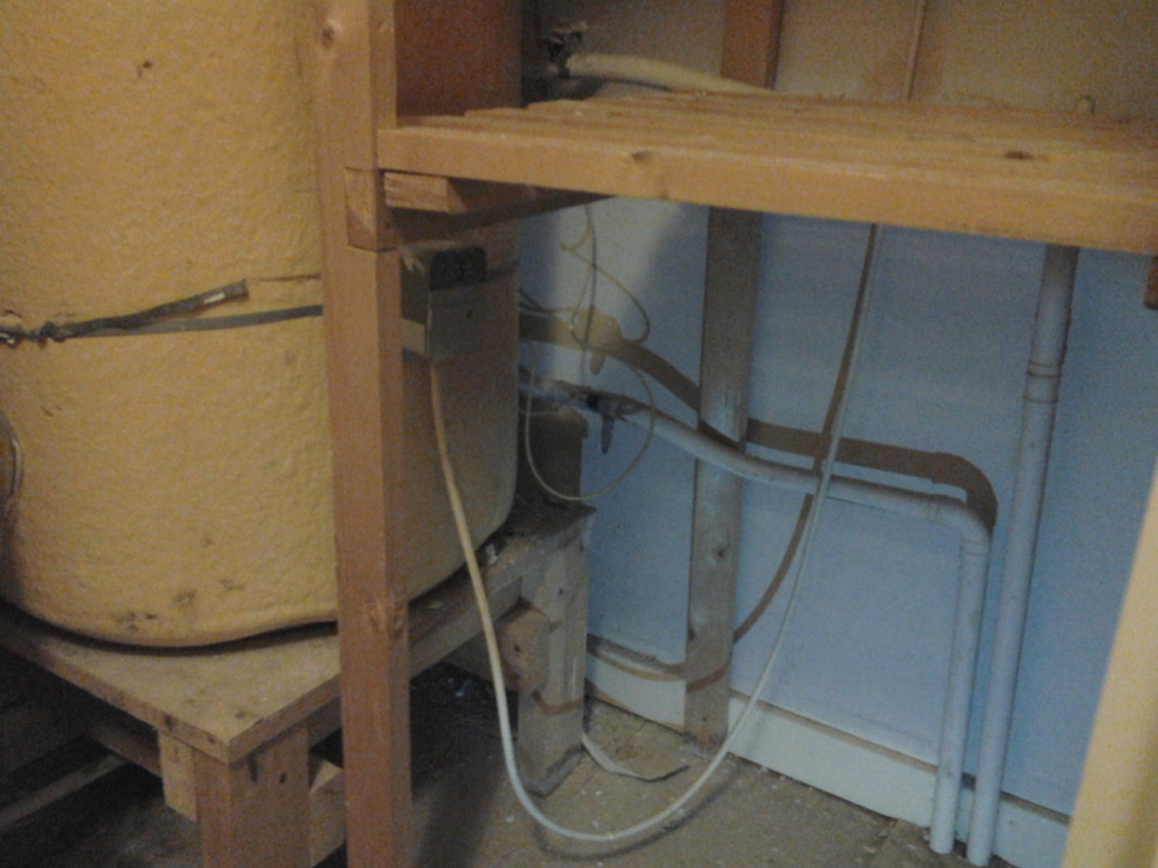

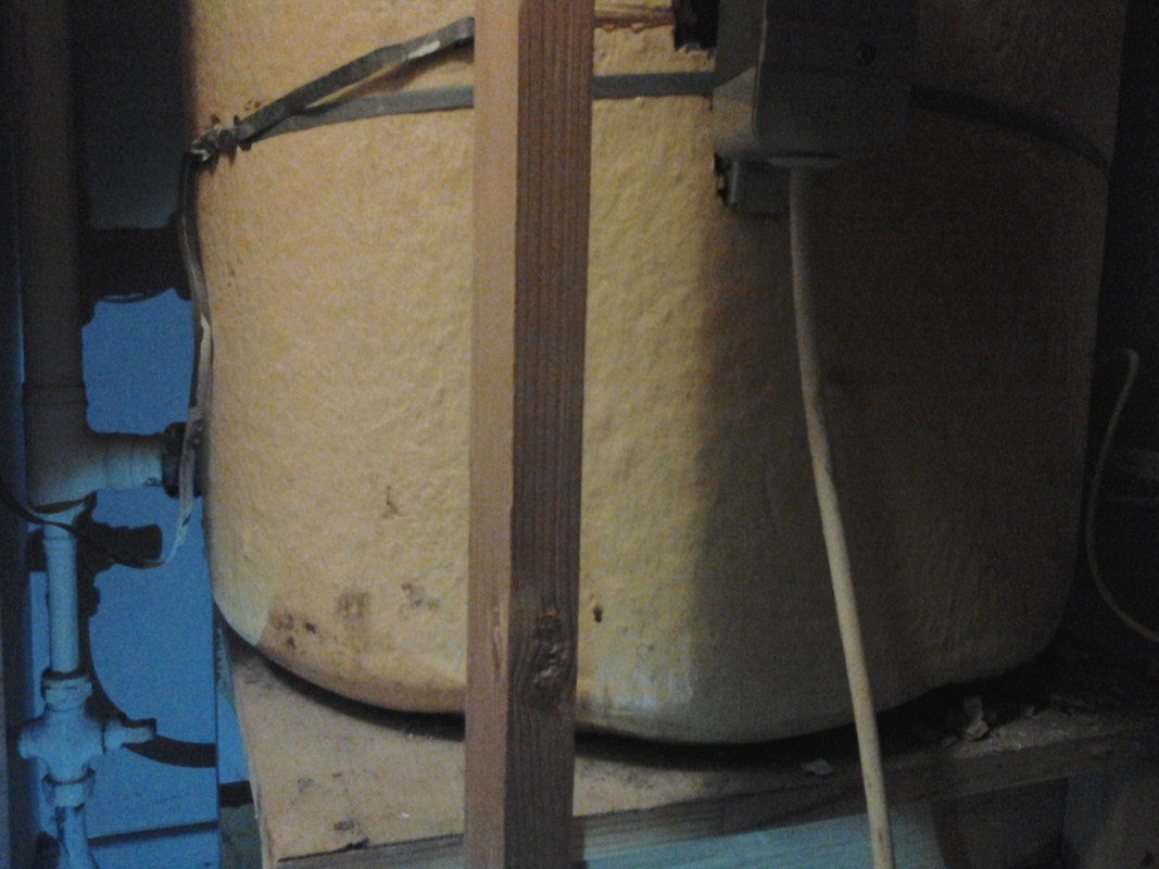

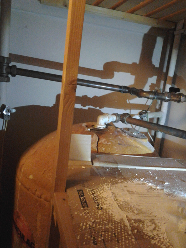

Difficult to tell, possible (and I seriously hope so), the left side are the HW Primaries, and the right side feeds the central heating. Possibly zoned for upstairs and down, but without seeing more of the system it's impossible to tell. What is the arrangement at the cylinder? Photo would be ideal, at least we can tell if you have a vent if nothing else!

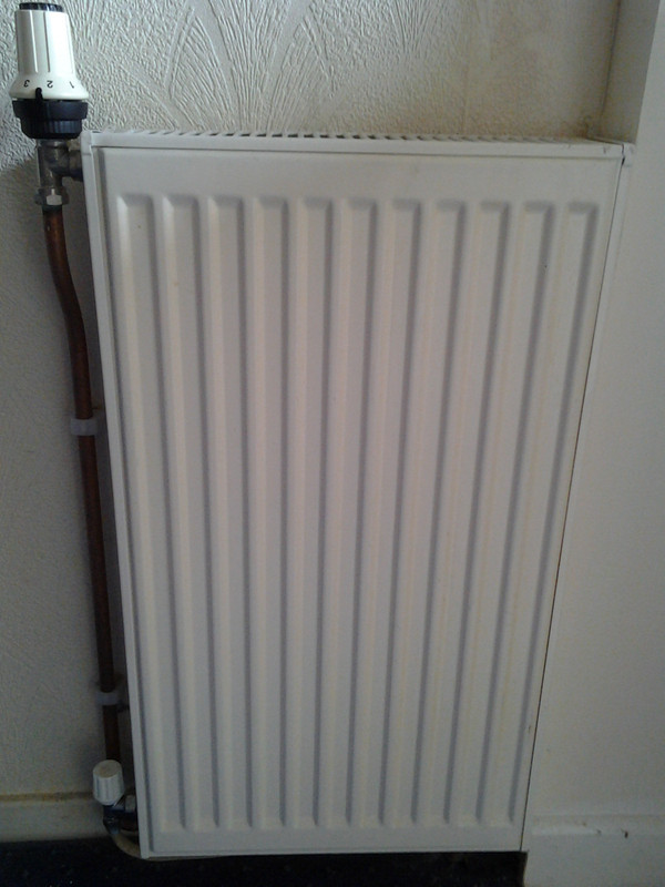

I also attach a picture of a radiator, maybe this can help wrt the 2-pipe vs 1-pipe CH question:
Thanks in advance!

System looks to be fully pumped, but possible you have 'Microbore' central heating, whereby all the rads are fed individually from a central manifold in small bore pipework. Are all the radiators connected in a similar vein?
Pipework from L/H side of the boiler may well be the Vent and feed, have to wonder if it's an old Gravity HW/Pumped CH system that's been converted to fully pumped.
Yes, this makes sense. I measured the outer diameter of the pipes feeding the radiator in pic above. It is 8mm, I think. I don't like that.
I have a question: would micro-bore imply a two-pipe CH, or can you also find one-pipe micro-bore systems? I cannot figure out how the latter would be possible, but I'm asking because that could help settle my questions.
Most, but two of them look a bit different.
One has a larger pipe with an additional adjustable valve. I think the larger pipe is the output one, since it was colder upon testing:
A second one has the usual smaller pipes, but again with an additional adjustable valve on the output:

If it is microbore then definitely 2 pipe.
The other rad is only piped T B S E for wall space.

Another question, sorry (I'm learning a lot:): what are the names of the radiator valves in the last picture? Is the one on the right a TRV? What's the name of the other one?
You have what appears to be a 'S' plan system, with Separate valves. If HW is calling for heat, then the HW valve must be open, providing a path for the water from the boiler. With CH, it is possible the room stat may still be calling for heat, but individual Rads with Thermostatic Radiator Valves (TRV's), are shutting down, thus restricting the path for the flow from the boiler. To prevent system damage, the bypass would allow a path for that flow.
As to the pic, yes, Right valve is a TRV, left is a standard rad valve. If TRV's aren't fitted then a standard valve is fitted at either end of the rad. Normally one end would be fitted with a wheelhead, (as in the pic), which allow the valve to be closed off if the rad isn't needed. The opposite end would have a 'Lockshield' cap fitted, Basically a protective plastic cap that doesn't alter the valve position is moved. The Lockshield should be set by the installer to 'Balance' the system, basically a procedure to ensure all the radiators get the required flow of water from the boiler to ensure even heating across the property.
Which brings me to another question (sorry, if I ask too many, just ignore me :) ): do TRVs for one-pipe systems exist? Are they different than ones for two-pipe systems?
TRV's are standard, they're quite simple in operation, simply adjusting the opening of the valve to regulate the flow into the room according to ambient temperature of the surrounding air, with One pipe systems relying on convection and gravity somewhat more than a Two pipe system, I'd have to question the need or effectiveness of using TRV's on such a system.
