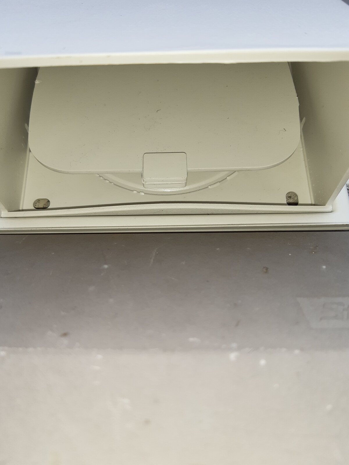

Depends what it is connected to. That would seem good to me for a bathroom or WC extractor. Infact often it's less than 2 cm, but it depends upon the fan it is connected to. Extractors have varying rates, a cooker hood may extract 300m3 to 400m3 per hour, but a fan in a WC or bathroom only 20m3 to 40m3.
If it's a cooker hood / chimney I would expect it to open to its full extent when on max.
A few metres of straight ducting should be ok, say 3 to 5, but bends are more of an issue. Centrifugal fans are better than axial fans in overcoming the resistance of the duct.

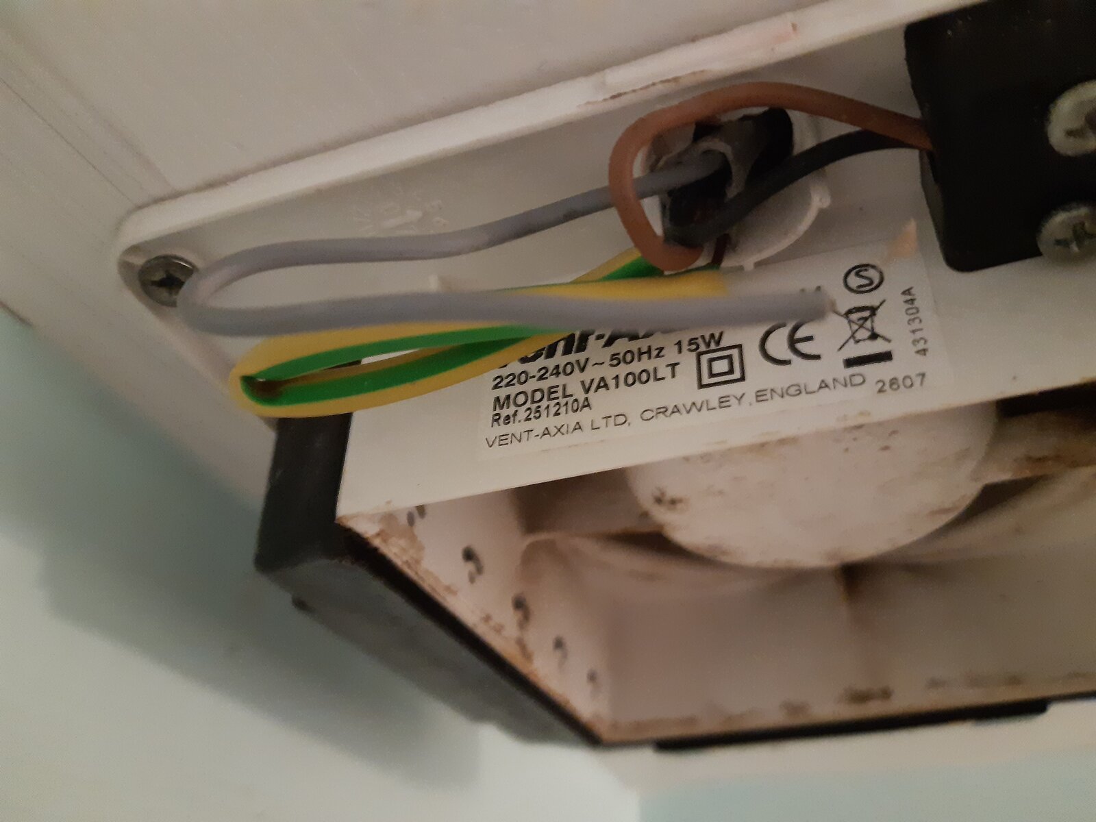

I wonder what sort of fan you've got, and if it is ventilating a steamy bathroom.
When im next at the property ill look what model fan it is, its from a bathroom.still wondering.
Hi, its a vent axia 100LTstill wondering.
