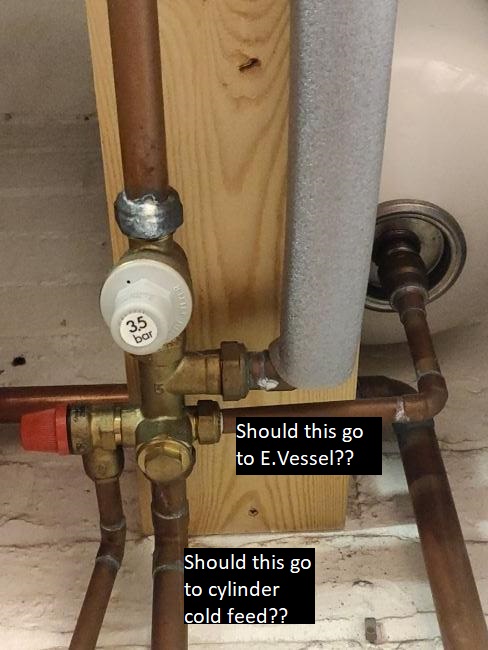

I have a Vaillant system boiler and Vaillant hot water cylinder, when someone runs a tap anywhere in the house the shower changes temperature and the pressure drops. I am wondering if this is due to the location of the pressure reducing valve.
The mains water goes straight to the PRV, from there it splits to the boiler and also back to the rest of the house to feed everything else including toilets, sinks etc. Should everything in the house be at this reduced pressure or should only the boiler be at this lower pressure?

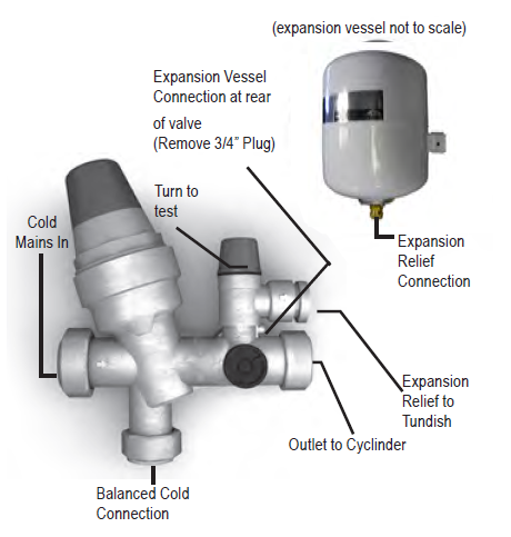

Can you post a few details from the PRV.
If you have a expansion vessel on the unvented cylinder see if it has a pressure gauge and note its reading with no demand fror water and with a demand, if no pressure gauge try and get hold of a "car" type P.gauge or pump with a P.gauge and attach it to the schrader valve on the end of the E.vessel. to get a few readings.
Can someone comment on this?.

Hi @Johntheo5 can I suggest that the OP doesn't play with his unvented? It needs a qualified engineer in to look at that. I appreciate it's just pre-charge readings but if the the OP doesn't get the connection right he could empty the EV, potentially causing more problems.
As far as the combination set is concerned then yes, the pipe out the bottom should be the cold mains feed to the cylinder. I would also think that the EV connection is correct as the NRV will be between that and the balanced cold feed as is the PRV.
The mains connection looks a bit strange mind you, usually everything on the valve is compression so nothing gets melted/burned if soldering.
Shouldn't the EV be conected to where the cold cylinder feed is now even though both downstream of the NRV, wondering if designated EV connections have a very small port, smaller than the takeoff bore which would have a huge effect on the pressure drop in the cylinder when HW drawn off. (If connected incorrectly to the cold cylinder feed).

Some use the blanked off EV port on the valve, if there is one, they usually are part of the Pressure Relief Valve section so they are both downstream of the NRV, not all combination valves have one IME. Some just tee directly off of the feed, others have even fed the EV from the HW outlet side. That 15mm pipe that's heading right is heading into the bottom of a White EV. Some combination valves also have a gauge tapping but you're right, no reason why they should have a gauge in there as standard, guess it's a cost thing.
