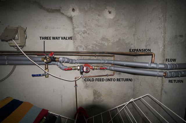

He plumbed in the new system (I think) pretty much as it was before but, I think for ease, moved the pump from the flow side to the return. What really worried me is that I asked him if a tank I'd seen in the UK would be OK to add to the system to do my hot water and he said yes, this was a vented two coil tank (I was going to add solar later) The tank was ordered and delivered with the rayburn.
He did all the pipework but was going on holiday and left me the tank to fit, leaving me with four flexi hoses, one for the three way valve one for the return (see pic), one for the tot of the cylinder into the hot water pipe and the last for the cold water fill direct from the mains (here in France about 6 bar) he told me to buy a PRV from the DIY store and install it between the fill and the tank.

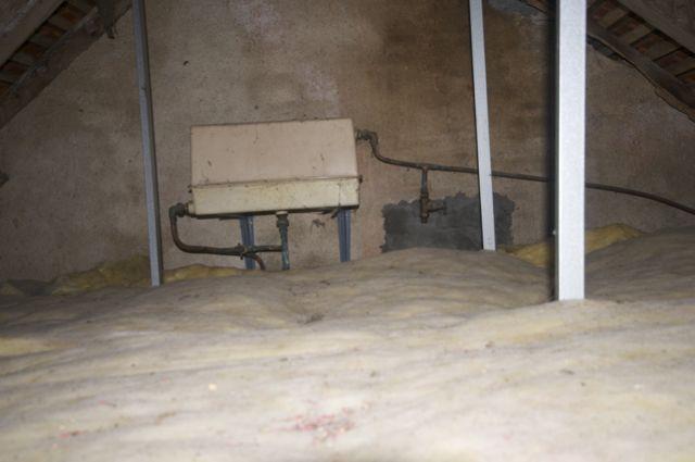

Something must have clicked in my brain and I did some research on the net downloaded the rayburn installation manual and found that you need a header tank for this kind of tank, which we don't have. We do have what I think is an expansion tank in the loft (see pic). Given then I read stories of tanks exploding and taking down the gable end of the house I'm getting very worried that the plumbing he's done for the heating is all wrong and potentially dangerous. The cold feed is turned off and if it is on it runs out of the overflow in the roof, he didn't say this was wrong but looking at some other stuff shouldn't this be on? Stuck ballcock? No ballcock Also both the cold feed and vent pipe are as hot as the flow and return pipes, normal?

Yes a Rayburn needs an open vented central heating tank in the loft like any solid fuel type
heating boiler. Sounds like your plumber doesn't know what he is doing.
Get someone else.
A Rayburn isn't suitable for an unvented hot water tank. You might want to
check on the Rayburn website for advice on that one. It would certainly
need a zone valve to cut off the heat to an unvented cylinder.

I think the third photo is an expansion tank, no?

If the third photo is a feed and expansion tank with an overflow then it seems to be OK, my mistake as I didn't really notice the third pic.. As long as the water/steam has somewhere to go safely in the event of an overheat then you'll be fine.
I take it that the expansion tank is sealed apart from the vent that runs onto the roof.... Don't forget to crack open the top up valve now and then..
Corgigrouch, it's dificult to tell as the the second floor has a suspended celling and I can't get to it to have a look without the risk of falling through the celling!
I do know that the pipe to the right of the photo goes out through the roof as when I turn the cold feed tap on it over flows out through the roof.
Are the vent, pump and fill in the right place at the moment? should I be worried about the vent and cold both feeling hot?
thanks for your time in replying, and sorry if these are daft questions
Looks like no gravity circuit to a hw cylinder and probably no hi-lo stats in combination in control.
It means its not installed as per the MI's.
Hand your plumber a copy and instruct him to start again or get someone else.
