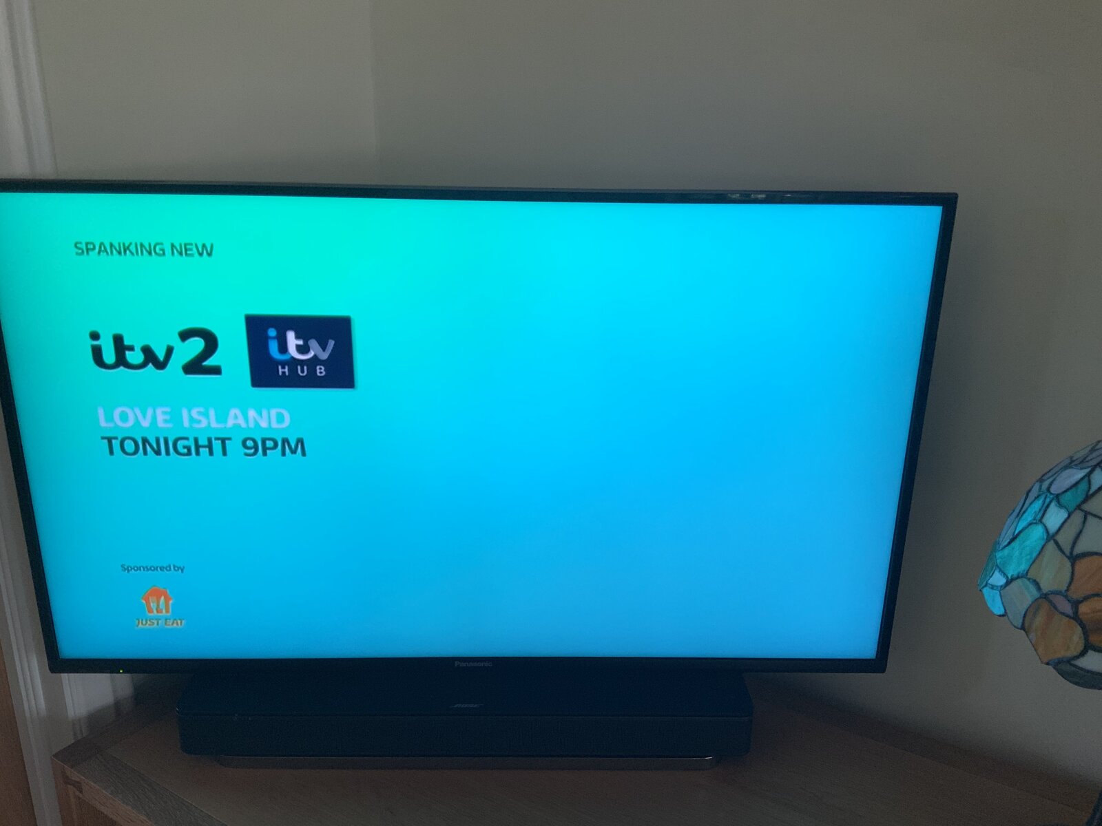

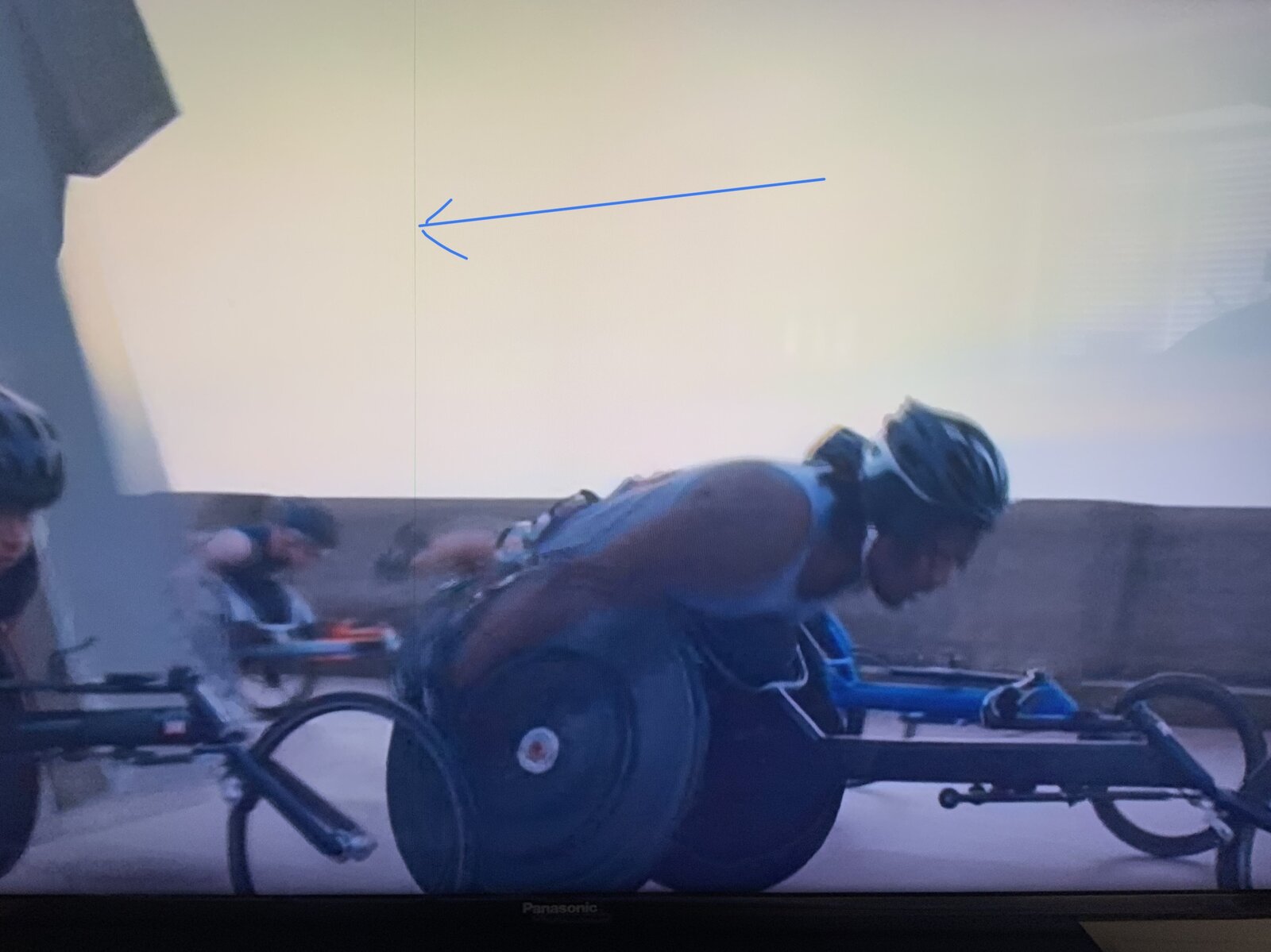

Today I noticed that I have a green line from top to bottom on my TV. It’s about 8 years old. Is this a sign of it on the way out? I certainly hope so as it will give me an excuse to replace it! Our current one is 40” but I don’t want to go bigger than a 43” as Mrs Mottie doesn’t like telly's that draw your eye to them. Would prefer one with Freeview play.
The difference between 'normal' BBC and HD BBC, while noticeable is not that much to my eyes so is there much point in me spending £1k plus compared to one for around the £400 mark? Will a 100 Hz tv really be that much better for me than a 50Hz one.
Any and all suggestions welcomed!

Had a few lines on a friends tv, took the back off and remade all the connection around the edge of tv and lines went away, lots of guides on youtube.
Glue coming unstuck on the edge connector ribbon cables around the screen.
I have seen people recommend using a hairdryer to reset the glue. I haven't tried it myself though.
