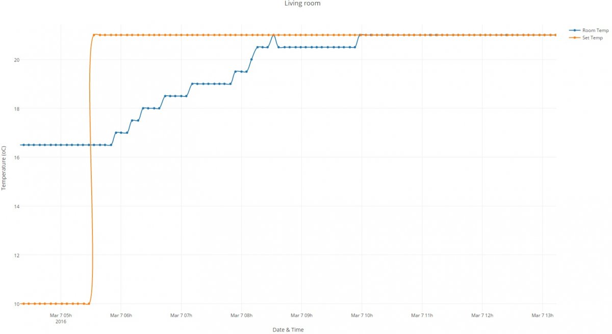

Hi all, i recently managed to get my Rapsberry Pi setup to automatically log room temperatures (target and actual) from our smart heating system (Evohome) and plot graphs on Plotly, which has led me to confirm what I've been feeling for a while now - the living room takes ages to warm up!
The following graph shows how the set temp (red trace) and actual room temp (blue trace) changed over the last 24h:
As
you can see, the target temperature changes from 10C to 21C at 5.30 am, but it is 8.30 before the room is nearing 21C, which seems long to me. Other rooms seem to heat up much quicker.

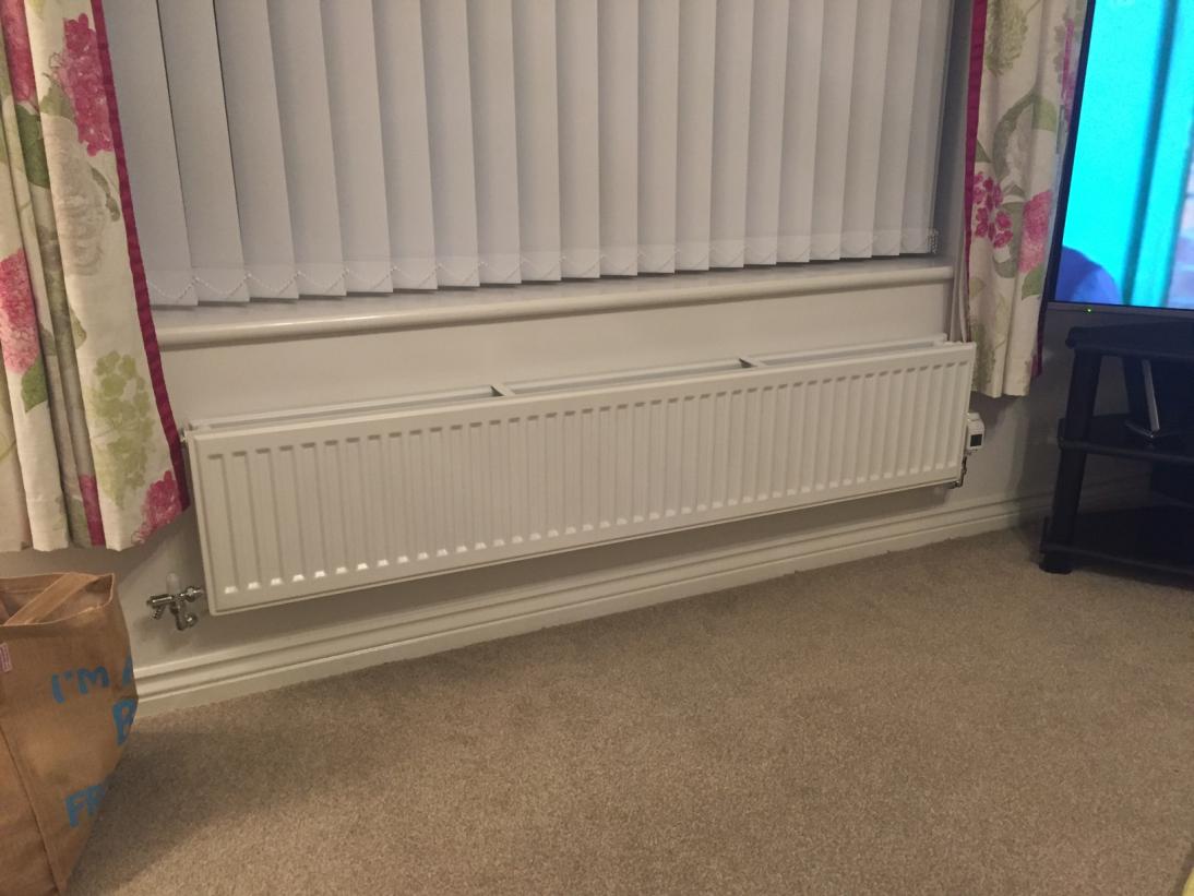

The radiator seems to get plenty warm, almost too warm to touch. Rad dimensions Are 1500mm X 300mm double (which according to spec, is rated at about 5000 BTU/h) but is under the window (see pic). The house is a new build, so should have good insulation, and the living room is 3.9m x 4.3m (ceiling standard height):
What do you think, am I being unreasonable to expect it to heat up quicker? Is the radiator sufficient for the room size?

You guys are reading the chart wrong. The house temp is 16.5C @ 05:30 and 21C @ 08:30
It is taking 3 hours for a 4.5C rise.
OP this is quite excessive. It should be in the region of 1.5Kw given off from the rad where as you should be looking at closer to 1.8Kw - 2Kw so it is a little undersized.
I would also look at the EvoHome HR92 position as your picture shows that it is in quite an enclosed position around a lot of media equipment can you be sure that this is not operating causing the rad to shut down during the warm up period?
I'd experiment with removing the head from the valve to start with and see if this increases warm up time.
Also how many are external walls and what is the temperature like outside during these tests?

Jon - I found the position of the HR92 to be poor, but I was limited as to where I would locate it without having to drain the system and swap the valves on the radiator. So I have a Y87RF room thermostat which does the temperature measurement, which I've found to be much more accurate.
I'd be happy to increase the rad size, but due to its location I reckon I'd be limited to a relatively small increase.
There are two external walls (modern cavity wall and dry lined though), room faces north so gets very little heat from the sun. I haven't done a heat loss calc, will do!

Your area is 16 sq metres and that should need less that 100W / sq m or 1.6 kW.
But your rad is rated at a flow temp of 70 C and that would not be possible to touch at all.
So you problem will be the rad temperature. The boiler may be more efficient with a low flow temp but that is at the expense of the rad outputs.
To know what is going on you would need to measure the flow and return temps using a contact thermometer.
Another problem you may have overlooked is that the curtain must NOT cover the rad otherwise the heat does not get into the room.

@garmcqui If you could get a 400mm x 1600mm in there that would push you up to about 2.1Kw
