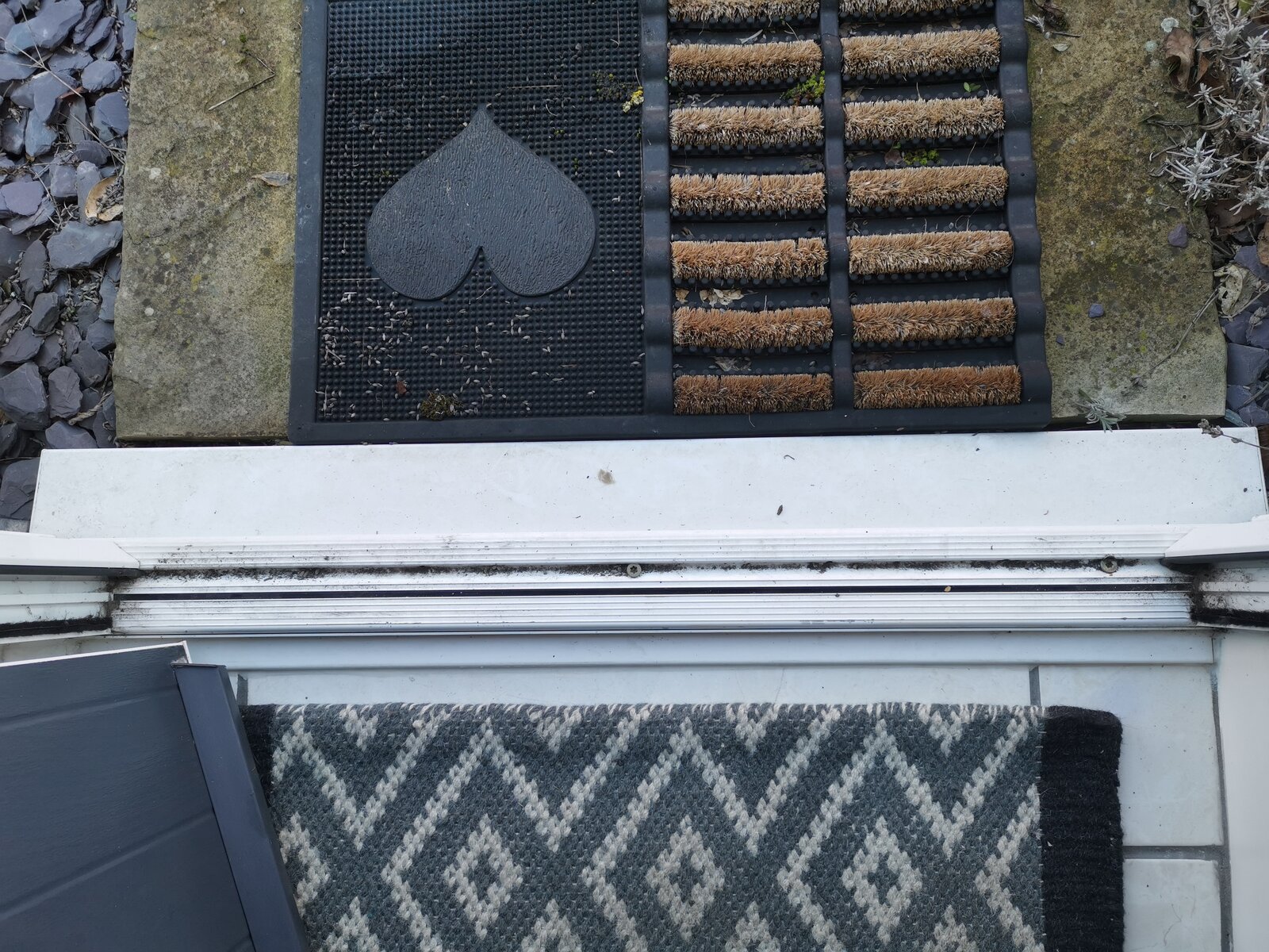

I'm not saying you should need to do this, however if you get nowhere with them, and assuming the existing threshold isn't integrated with the rest of the frame, could you not fit a new threshold yourself or get a local tradesperson to fit it for you?

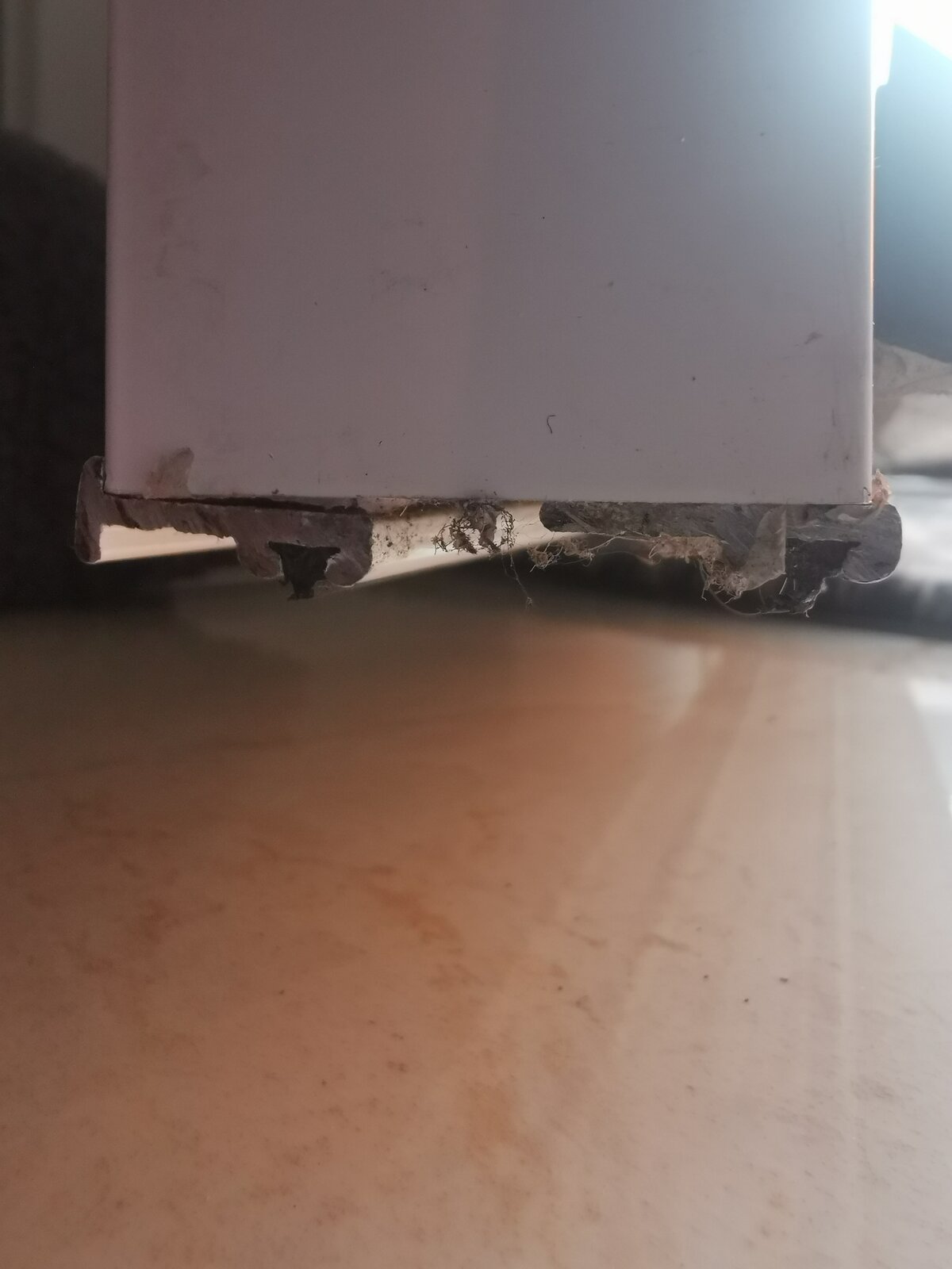

Here's a pic currently of the seals on the door lol and the bottom frame where it always seems to be catching towards the right side.
That's not a door seal.
It's an accomodation for spiders, bugs and critters of all kinds. o_O

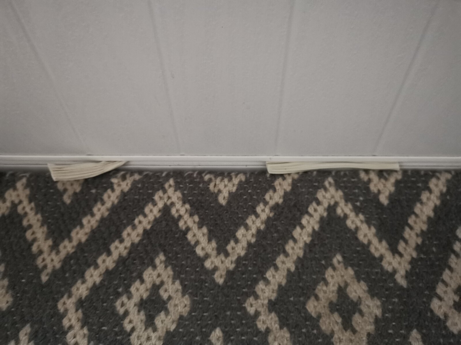

Well I've been messing with the door tried to put some stormguard weatherstrips underneath they've lasted 2 days with the door being open and closed 3 times in total before starting to be ripped off.

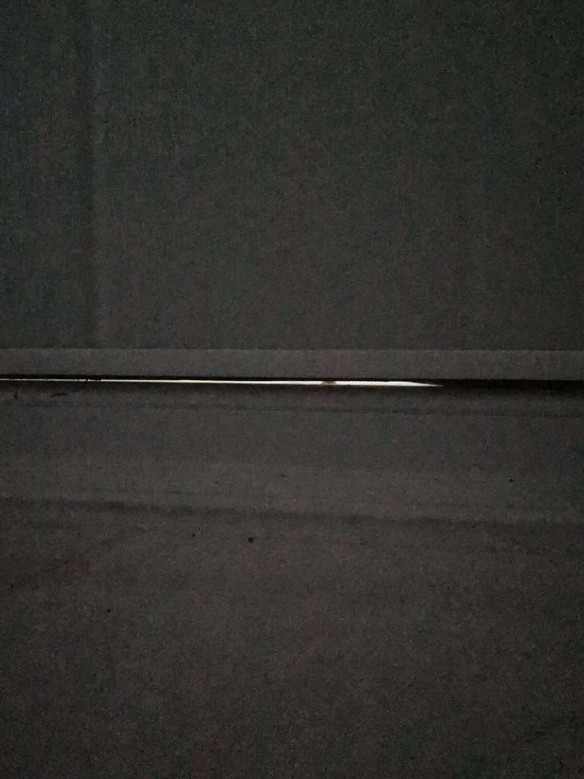

Theres also clear daylight all the way along apart from the right dropped part of the door.
I've bought some brushed weatherstripping from toolstation but don't hold out it's going to last.

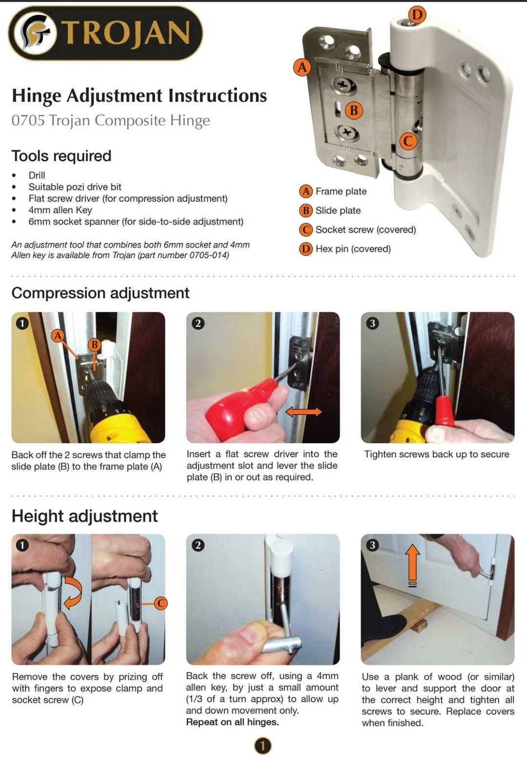

I've been looking at maybe trying to adjust the hinges from what I can gather there Trojan hinges and you take out the 3 middle hexs which enables you to move the door up and down I'll need to get a mate round to help and some wood to lever the door.

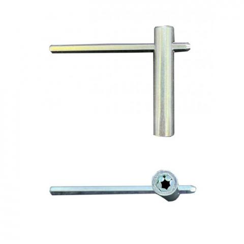

Can you used any screwdriver attachment or would it be best to buy this https://upvcspares4repairs.co.uk/tr...Ls2NALzb12OgSJQdABXOiwR7j1wWhpQRoC6dIQAvD_BwE
