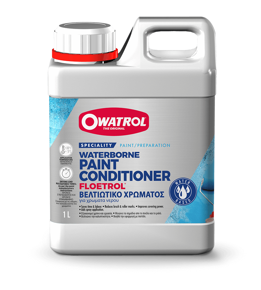

I started using Dulux trade Satin Diamond finish water based on the woodwork in my hall. We sanded and primed prior to putting this on over old paint. It became tacky within minutes making it difficult to blend from dry to wet paint. This is not a paint to use on top of other paint regardless of how well the old paintwork is prepared. I abandoned painting and will wait for it to dry, sand, prime and start again with another product. I have painted for years and never come across this issue. I have new wood in areas and will try the paint again in a discreet area, but what a mess it has made!
I am not a fan of water based coats, but if you use something like Floetrol, it will help the paint to flow.
