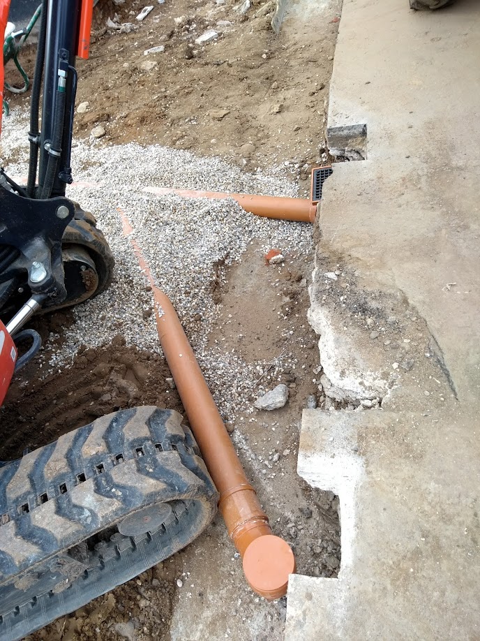

Is the second pipe that is closed off at the moment for the soil stack vent? I assume so. These are for the new kitchen but connect with the WC too.
Main drain top - what is the lower thing? Vent?

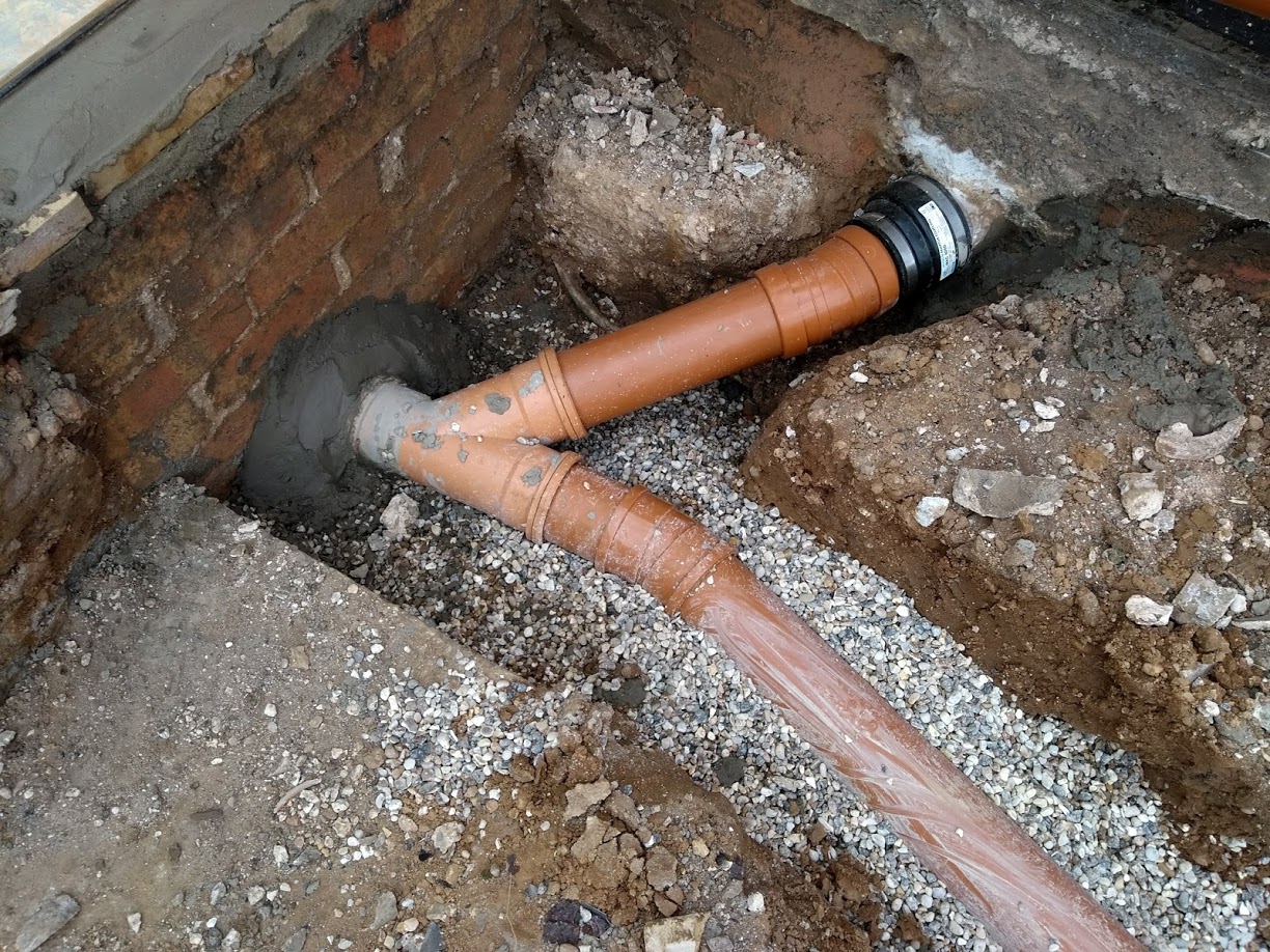

existing WC top, new kitchen sink bottom:
Vent or soil stack.
Maybe even rainwater, some people use a rest bend instead of a gully on rainwater downpipes.
That layout looks a bit crap.
A bend, then a junction, then a manhole? WTF?
And is that a backfall or the camera lens distortion?
And if that is a soil stack, then it looks like its got the wrong bend on the bottom - not a rest bend. Also looks like effluent flushed down the soil pipe will suck the trap out of that gully.
well, the loo pipes run the same way they have for a long time, old cracked clay pipes just replaced. That sticky up bit is just a for the vent.
