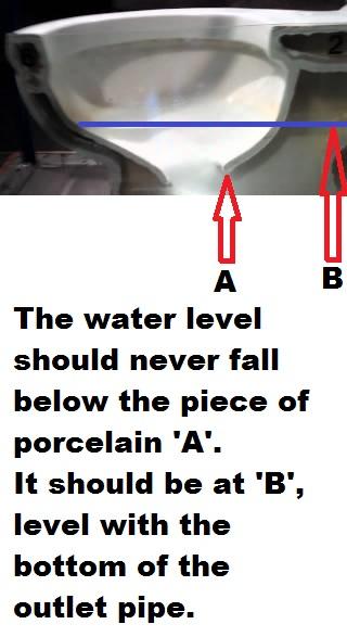

Just fitted my new toilet and I feel that the water level in the bowl is too low. There seems to be a rim in the bowl that the water level should rise to but it is well below this line. Any ideas?
The water level in the pan is governed by the spill over level at the back of the u bend. If the pan is level and is not faulty then the level is what it is and you can't change it.

Just phoned supplier and they said that the toilet does have a low level that's just how theu come now. The cistern not filling properly is because of a limescale filter which I have been advised to remove as up here in scotland we have clean enough water not to need it.
If there is no limescale to filter, the filter could stay in place without causing a problem. It may cause the cistern to fill a little slower but it won't be the reason that the cistern only fills half way.
There sould be adjustment on the float height and a mark on the inside of the cistern to set the max level to. Modern toilets are designed for a maximum flush volume of 6 litres so will almost certainly contain less water than your old toilet.

if the cistern consistently fills half way, the float must be wrongly set.
A picture speaks a thousand words...Charnwood's picture should tell you all you need to know
