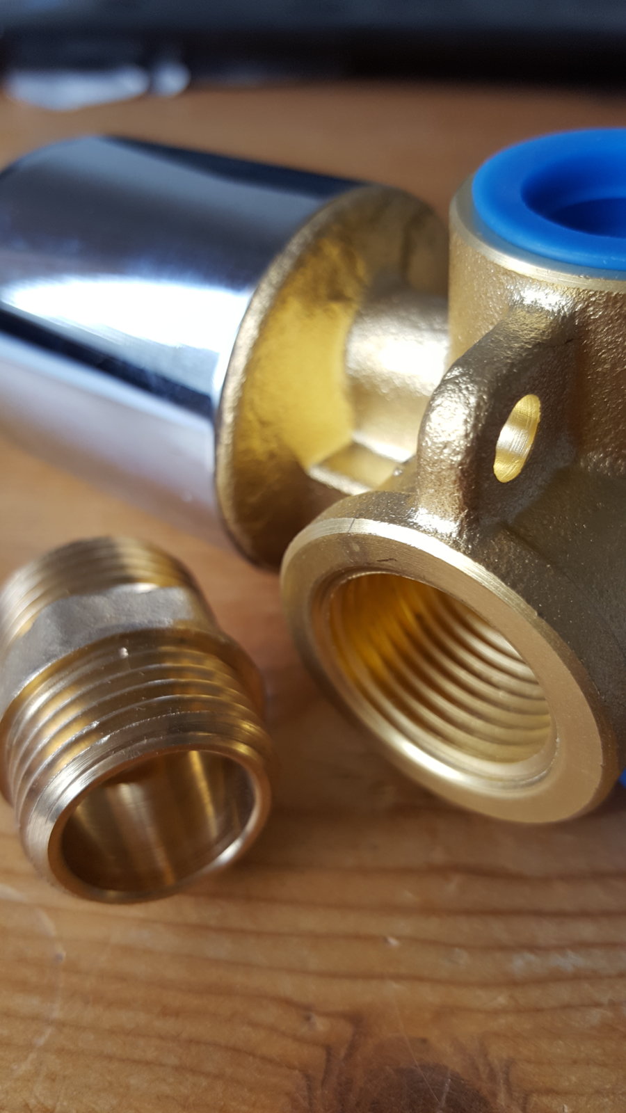

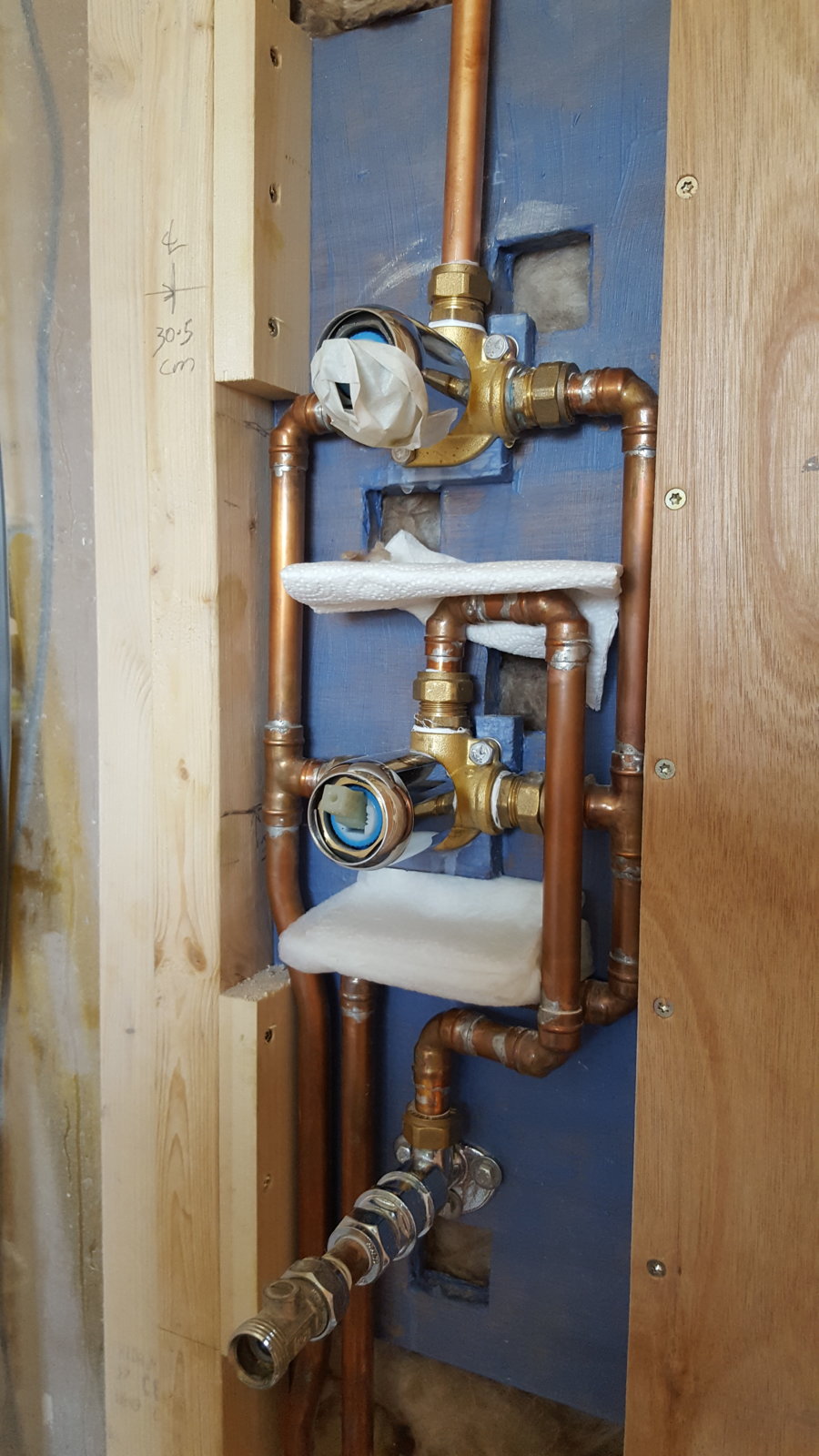

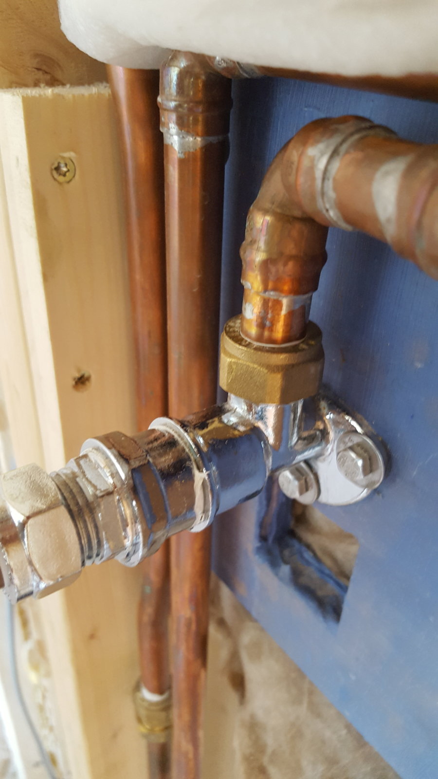

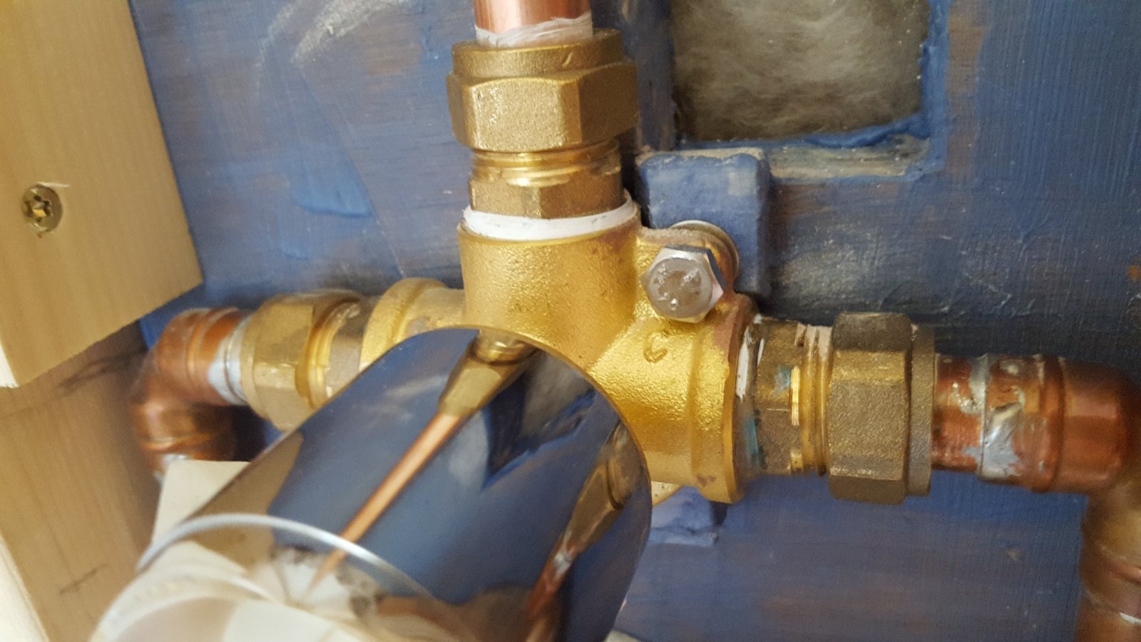

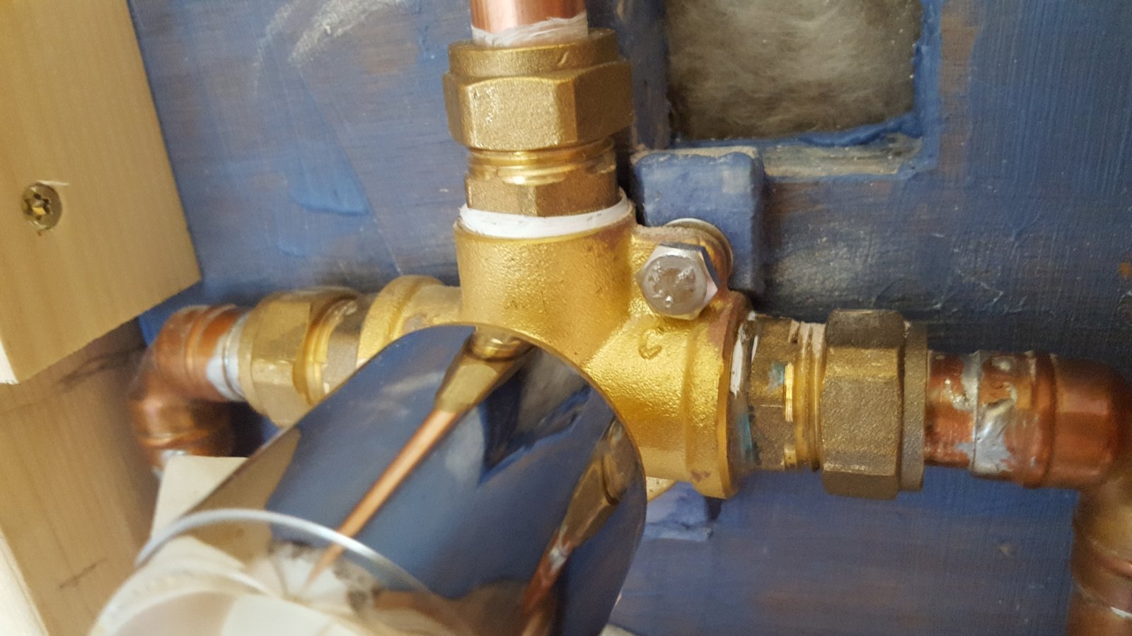

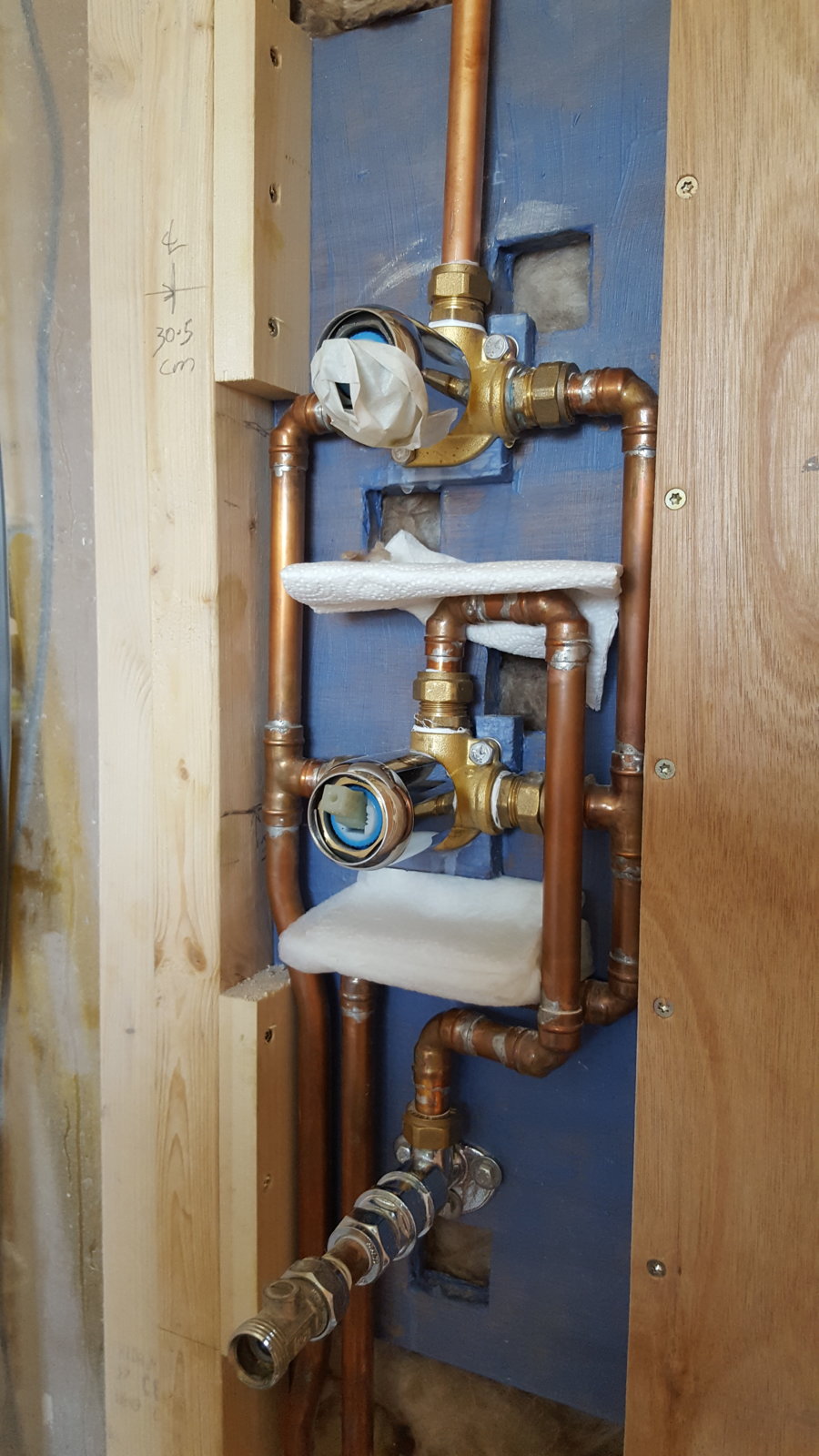

I have now assembled the pipe work and all seemed OK, but I have found the 1/2" BSP female connections drip leak however tightly I screw the male connector in.
I put 7 wraps of PTFE tape on, but the shoulders on the male fittings are not that big and they don't seem to make a satisfactory connection with the female shoulders on the valves or connectors.
I have ordered a 600 box of mixed fibre washers from ebay that, as part, contains... 20 pieces 27 O/D x 20 I/D x 1 thick, & 20 pieces 32 O/D x 22 I/D x 1 thick. For some reason I seemed to have difficulty sourcing fibre washers that would fit over a male 1/2" BSB thread. (They all seem to be sized to fit internal female BSP connectors.)
I am now looking for good quality straight 1/2" male PSB to 15mm compression couplers that have a decent size flange for the fibre washers to sit against.
The last thing I want to be doing is pulling the wall apart from the bedroom side to fix connections in sub-standard BSP couplers.
I included some pics to illustrate the problem. (You will have to excuse the unconventional configuration; I wanted the rain-rose and the riser-rose on their own individual single lever valves)
In the close-up I took of the valve and coupler you can see how small the coupler shoulder is.
Any further advice woul be welcome.
Did you use Gas PTFE tape? If not then you need more turns on the threads. The shoulder on the male fitting has no bearing on the seal, the tape on the fitting meshes in between the threads of each fitting, creating the water seal. Gas tape is thicker, therefore needs less turns, standard tape will need at least twice the amount of turns. If you then tighten the fittings in too much it will then strip the tape out from the threads and it will weep, so it's all about feel.
You wouldn't use a fiber washer like this, if anything you would place it into the bottom of the female fitting so the face of the male fitting can press against it, if it has a large enough platform at the bottom of the fitting to sit on and seal against, though these are usually rubber. You only use it like that, if it was a tap connector.

No, it was plumbers PTFE tape, though I do have gas tape. How many turns with plumbers tape? Is 14 sufficient?
My past experience with fibre washers has shown me that nothing seals a connection better, so long as they are trapped between two flanges with PTFE tape, but from your discription I can see why I couldn't source the right size.
I didn't know that if you tighten the fittings too much it would strip the tape out from the threads. This could be the source of my weeps.
I will dissmantle the valve assembly and re-make the connections trying not to over tighten them this time.

Again it's a trial and error with the tape. Normal tape is usually double the amount of the gas tape equivalent IME.
For sure, fibre washers are great where implemented correctly but they can only be used in certain circumstances, where 2 flat flanges/faces are mating together or with tap type connectors with a flanged shoulder.
The more you tighten a fitting with PTFE tape, the more the tape is compressed/spread, it ends up that the tape between the threads isn't thick enough to fill the gap and allows water to pass through.
