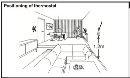

Hysteresis is always a problem with room thermostats old ones had heaters built in. Never thought about it much until I came to use a wireless portable thermostat to control my mothers living room.
I have two thermostats the original in hall timed to control at night and new one timed to control during the day and to start with placed on a writing bureau however it was noted there was a massive over shoot set to 23°C it would switch off and the room was still heating up plus the time for the heat to reach the thermostat which was centre of a wall 90° from the wall with radiator.
I have moved to tea trolley which would seem too close to radiator being only around a foot away however the hysteresis is massively reduced camera on bureau has thermometer built in it was showing 21 ~ 25°C now shows 21 ~ 22°C although the thermostat has to be set higher than required the temperature of the room is much more stable.
Until this I had never really thought about where the thermostat should be placed in regard to the radiator, well if anything I have always placed some distance from radiator to measure room temperature rather than spot temperature near the radiator, it seems I have been getting it wrong?
So is there any guidance given as to where it should be placed other than at 1200 mm from floor which the building regulations state is the max hight for items to be manually operated and min hight for items to be read which is to be frank silly anyway as able bodied people can bend down but wheel chair bound people can't rise up to read the device so 1000 mm is more like the hight required.
But I have seen nothing to say where to place in relation to radiator. Is there anything?
Honeywell's guide is about as good as ikea instructions....

Fitting a stat is just guesswork because houses vary so much in design, location and customer comfort expectations. Usually in an area that gives a fair approximation of the whole house hence often the hallway.
As far as I know it is just in free air away from draughts and direct heat, always a problem once a customer starts sticking a thermometer next to it (no offence intended :)) the thing I said to customers is, are you comfy? If so forget it.

locating a thermostat is generally common sense, there are number of variables to consider and some no nos!
It is not an exact science unless the stat has a brain and can compensate for certain factors.
Unfortunately, common sense isn't always that common! The single thermostat in our home here is a case in point: Somebody mounted it in the hallway right below the air return inlet for the HVAC system, no doubt because it was quick and easy to wire with the unit on the roof directly above. On my list of jobs is to install multiple thermostats and motorized dampers to turn it into a zoned system.
As has been said, it probably comes down largely to common sense and, if one can (e.g. with a wireless stat), experimentation. I have always felt that on any wall (inevitably where they are found) is probably non-ideal, and that one or more sensor(s) 'dangling from the ceiling' in suitable places (maybe suitably camouflaged!) might well be the ideal, functionally if not aesthetically!
