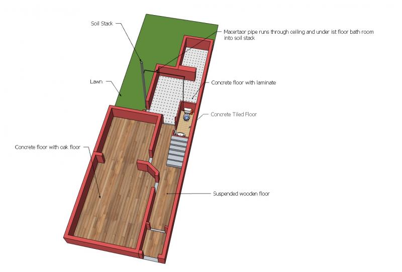

I'm open to suggestions regarding a 4" waste but at the time i was under the impression that a macerator was my only option as most of my floors are concrete and soil stack is at rear. I have attached a simple 3D of my downstairs layout if anyone has a soloution to getting rid of my macerator i would really appreciate it.

Good picture, thankyou! It wouldn't be the easiest of jobs, but a builder shouldn't have much trouble digging up the floor, laying a 4" drain and making good. It's a straight run across the kitchen floor, through the doorway to outside, then connect to existing drain run, either at an existing chamber or by provision of new if required.
Appreciate it's a lot of mess and upheaval for a few days, and will be more expensive than replacement of the macerator, but it is fit and forget. Done once and done right, and assuming nothing out the ordinary (e.g. toys.rim block cages) find their way down the pan, you should never have another problem.

A slightly less disruptive option might be to erect a raised timber floor in the rear room, if there is adequate ceiling height and a change in level is acceptable.
