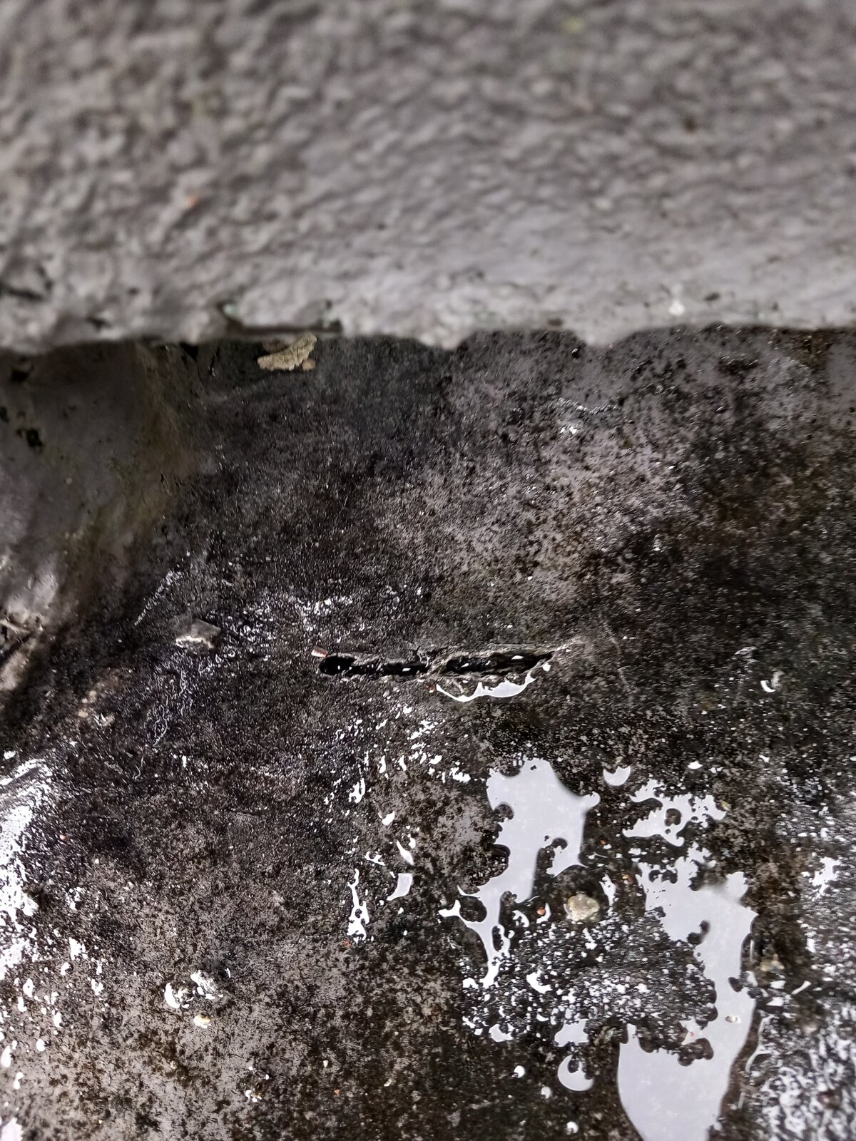

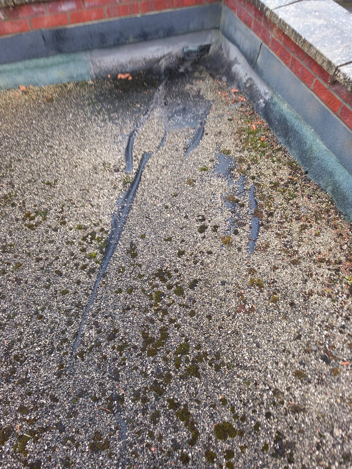

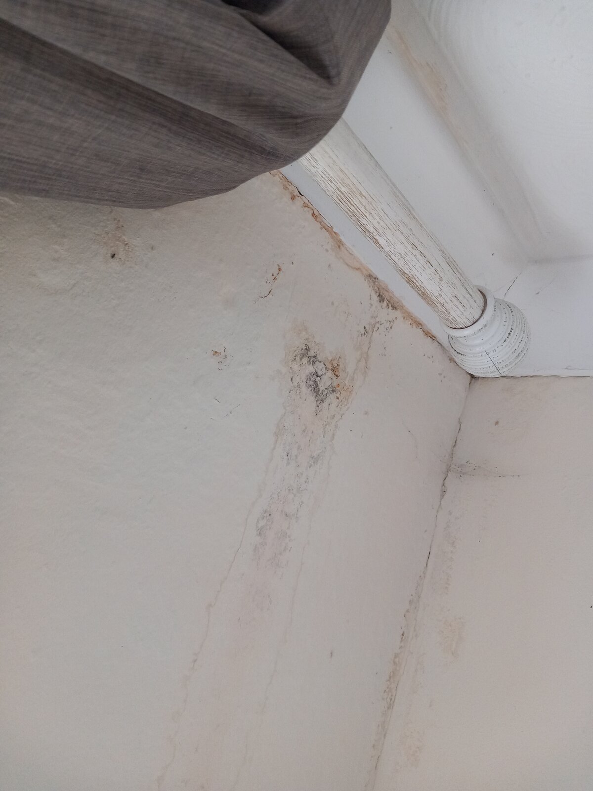

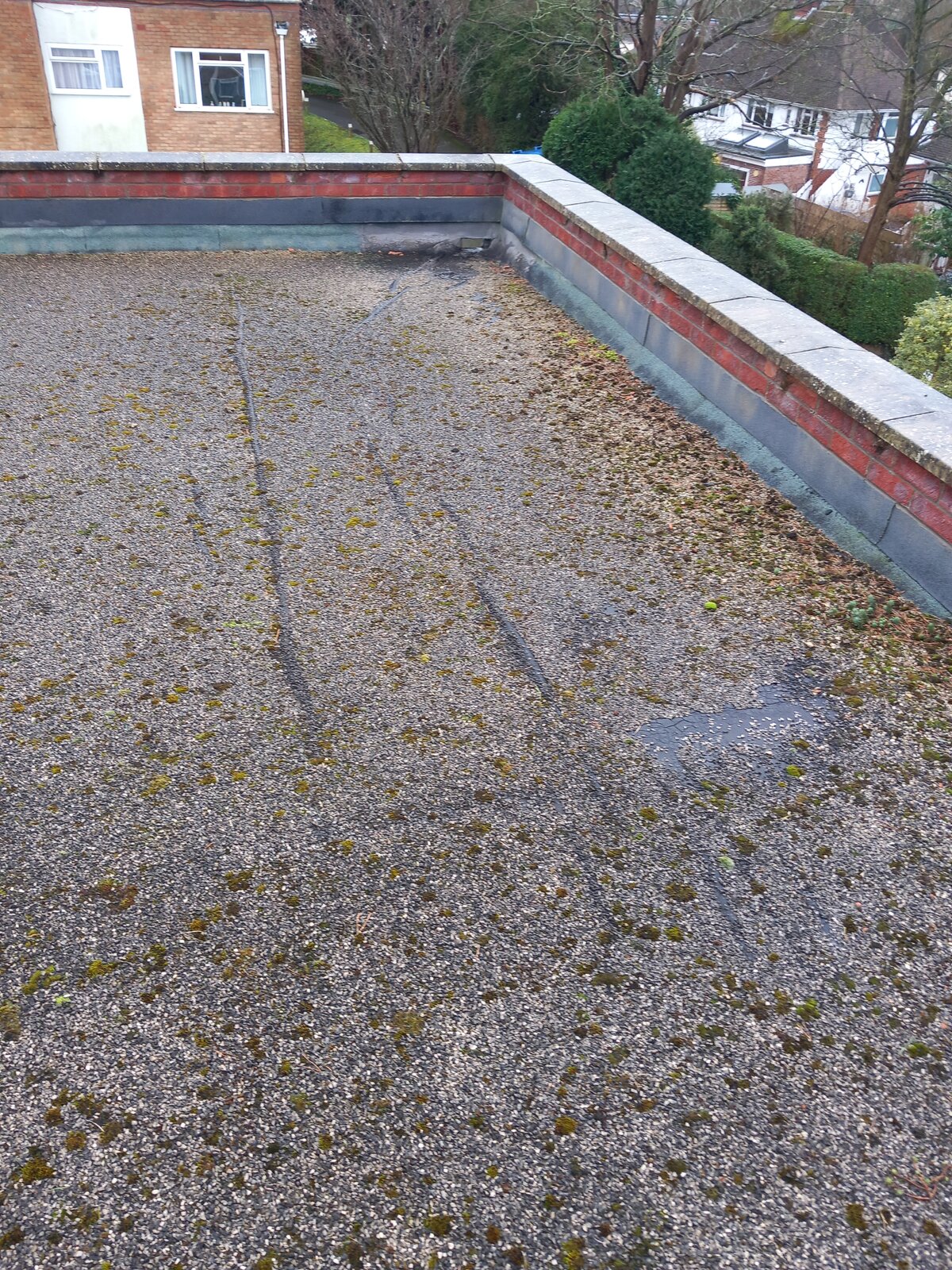

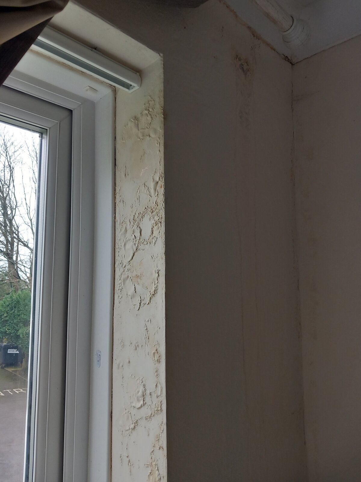

Is there a leak in my flat roof? got my interior walls bubbling up. I noticed what looks like a small crack (fourth photo down).

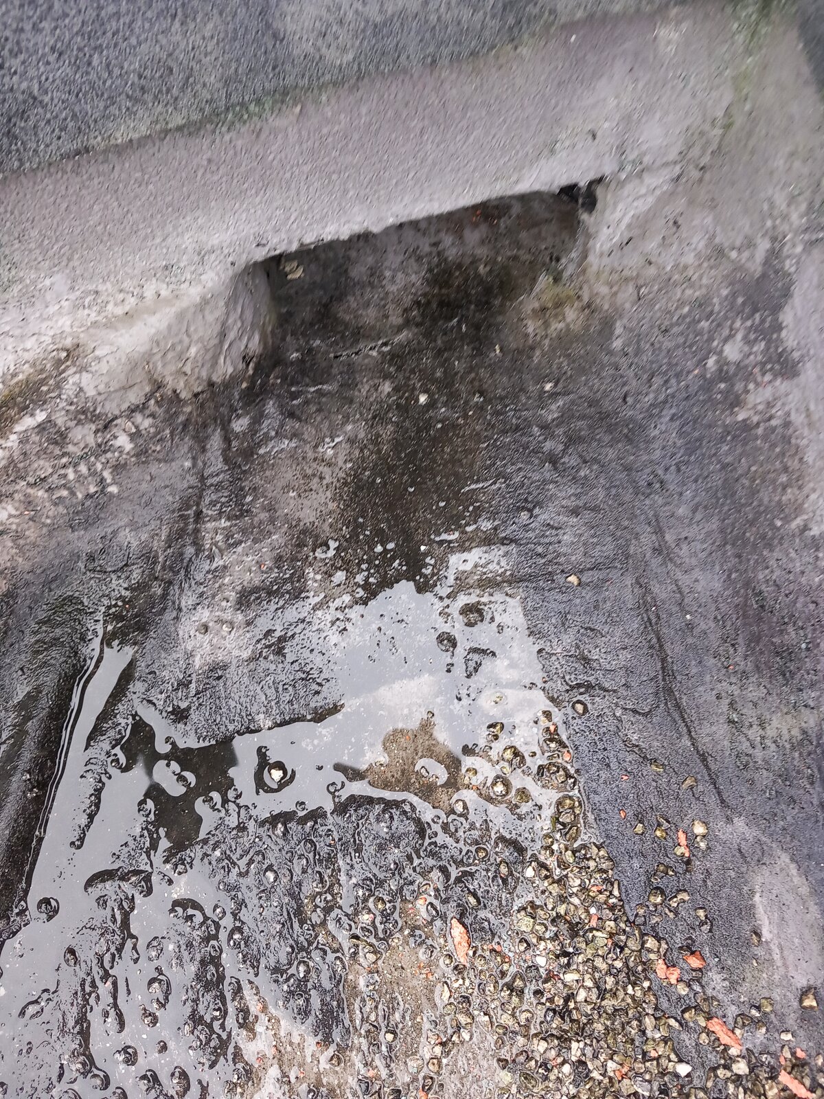

There‘s more than a crack, theres a gap in the corner of the parapet. Could be coming down the inner skin, hence bubbling.
