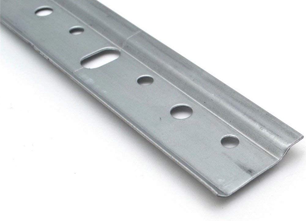

This is one application where instead of mounting cupboards on the individual kitchen cupboard mounting brackets, like these:
you might be better off using a long mounting rail, like this:
as they give you a bit of "shimmy" room, although you will need to notch the inner backs of the cabinets out with a jigsaw to allow the rails to run through. Once your cab is on the rails and levelled-up to the existing cabinet, take the doors off the existing cabinet and clamp the two cabinets together (this will need a couple of Solo clamps or QR clamps), remove the hinge cruciform plates from one of the two cabinets and screw them together using 3.5 x 30mm screws in the middle of where the hinge plate will be - flush the screw heads as you don't have anything to spare in terms of thickness. At the back put a couple of screws through to join the cabinets (I normally locate them just beneath or behind shelves so they are less noticeable/invisible). Replace the cruciform plates and rehang the doors.

I detest those little "tabs". They don't work on poor walls, they can be a PIA to get level (if you hit a hard inclusion when drilling the second hole) and they limit your ability to make adjustments. The long rails solve a lot of problems at a fairly low price
