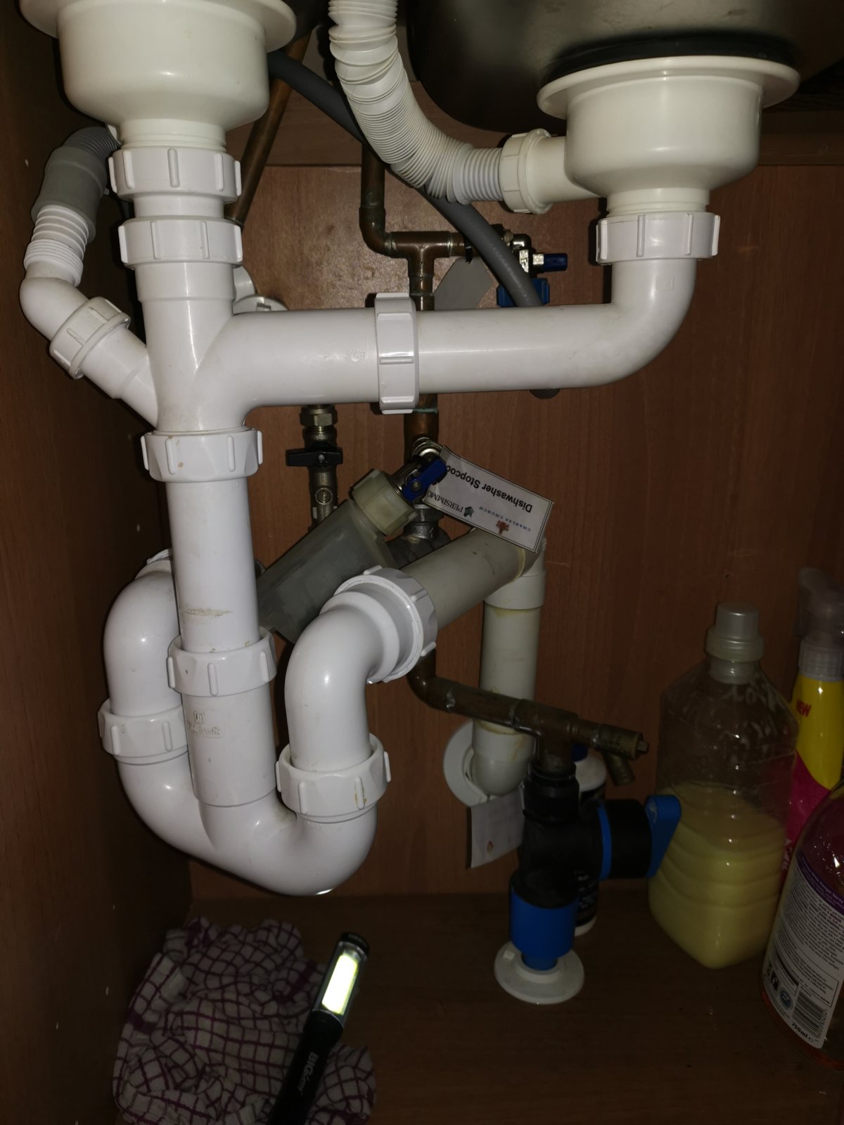

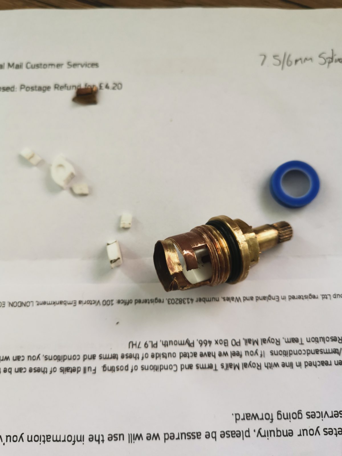

Long story short one of my tap valves is knackered

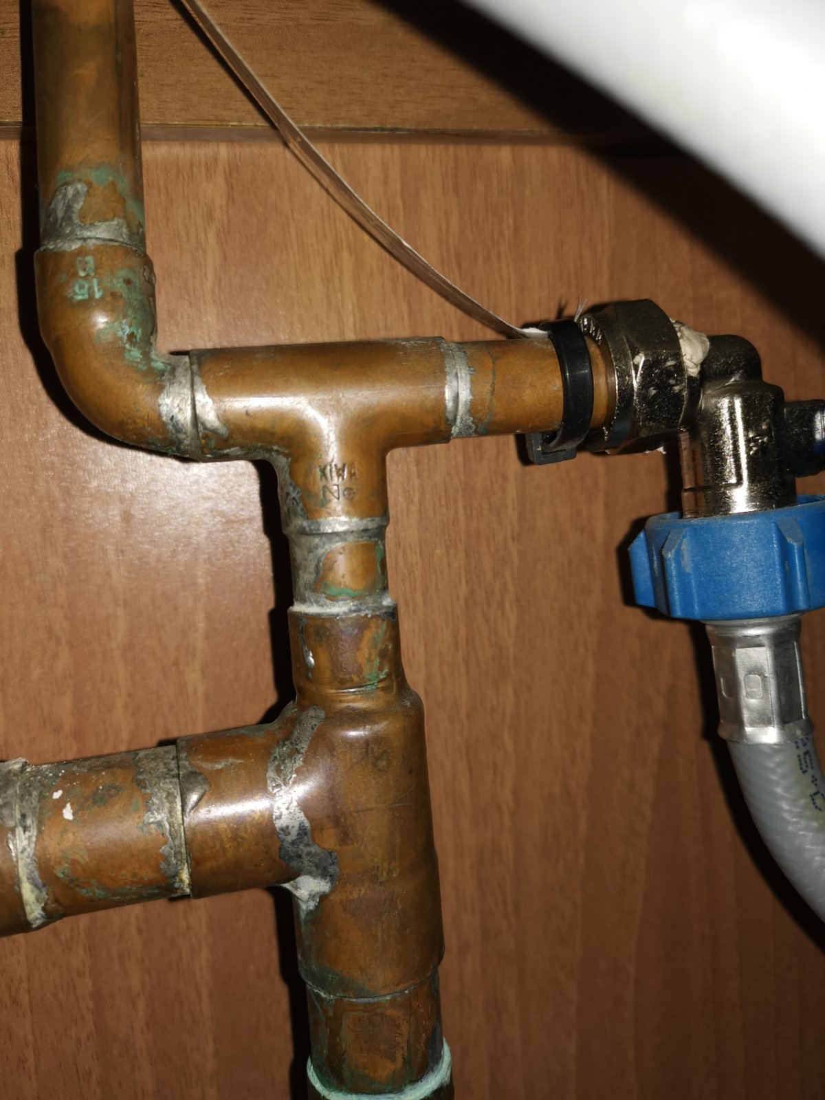

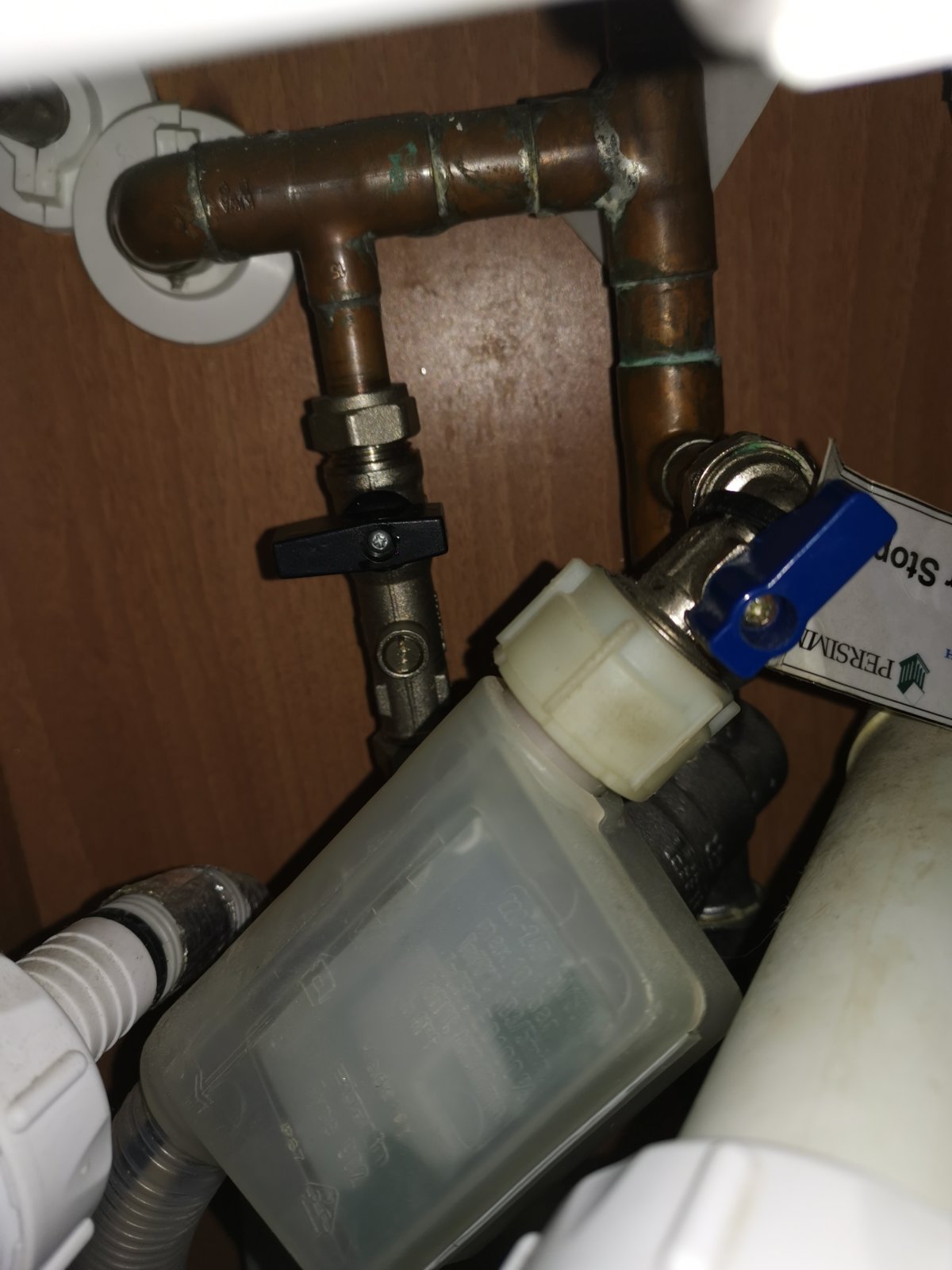

Which means i cant turn the water on at the mains without it creating a swimming pool in my kitchen :LOL:. I can't see any isolation valves under the sink only the main shut off
The main shut off in blue
Dishwasher shut off & outside tap
Washing machine shut off
Should there be a way to turn the water off just to the kitchen taps?:whistle:

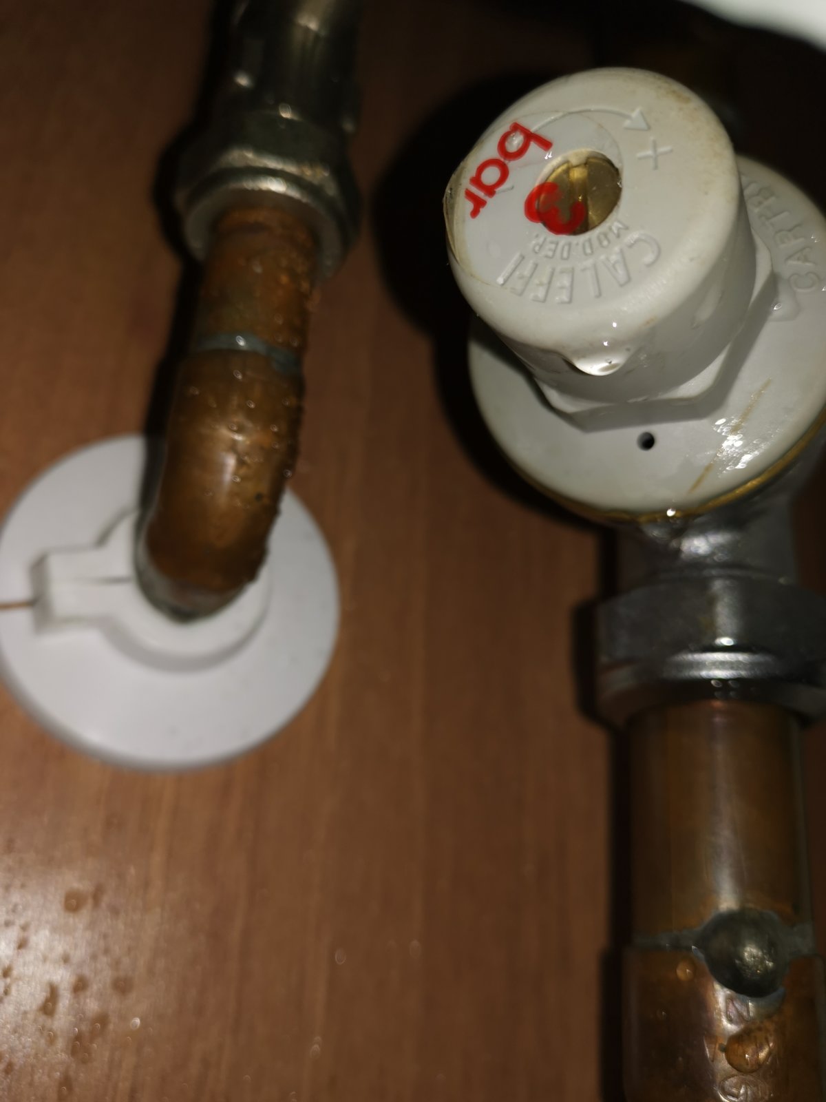

Not sure what this is
You could argue there should be but unfortunately there isn't. The bottom picture is a pressure reducing valve.
Would i be able to buy a blanking cap or something to stop the water for a day? it'll prob just come out the spout part if there was
Nothing obvious/easy that I can see, it doesn't help with all the solder fittings.

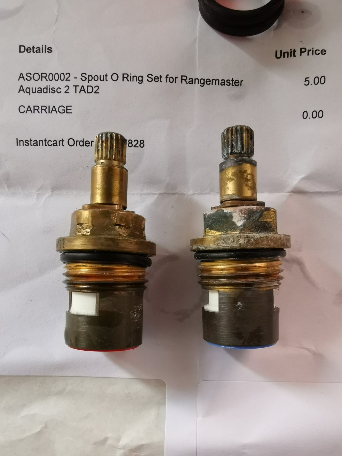

If you are going to buy a cap, why not just buy the part?
It can be annoying trying to buy the individual cartridge, as the spindle can differate (if there is such a word :) )
Just buy a repair kit and change both,if necessary. Something like this will be available at a plumbers merchant or shed.
The Home Store Lever Head Tap Conversion Kit (Pair) 1/2" 1/4 Turn Meal Chrome Head including Valves
Lever Basin Tap Reviver Kit 1/2" (Toolstation - probably open today)
Fit an isolation valve to hot and cold supply pipes going to the tap. Then repair or replace the tap.
How did you manage to take the tap cartridge in your pic out without turning the water off ?

Haha just got bk just picked these up. Is it worth changing them both or should it be okay just changing the knackered one

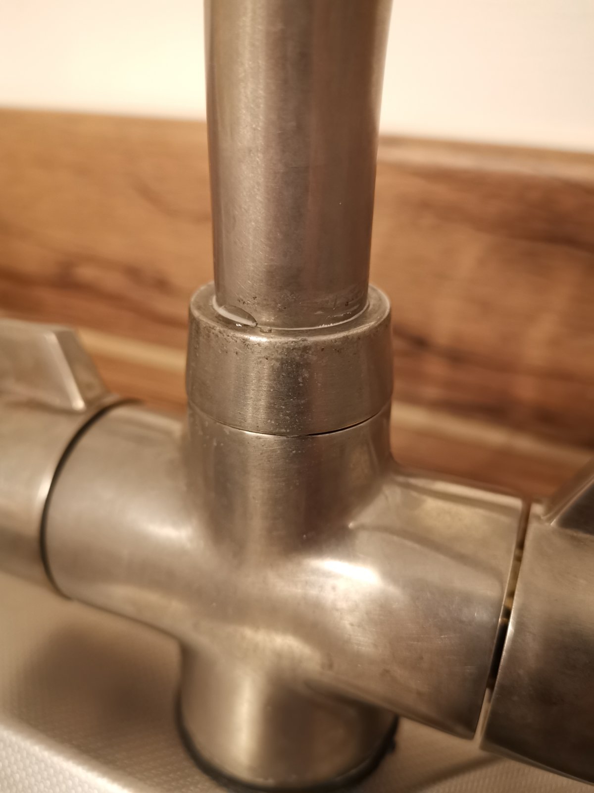

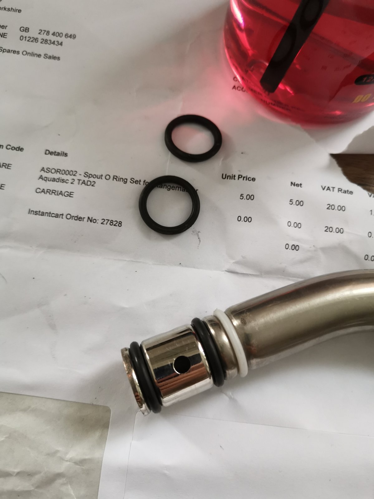

They've done the job the spout is still leaking so I've put some plumbers mate round it and it's stopped only thing I had
Hour later and it's still leaking bloody thing, I'll try a bit of loctite 55 2mos round the new o rings
You have misdiagnosed, mate.
The problem with the tap is the "O" ring - the new cartridges were never going to sort that.
The problem is identifiying the exact size of "O" ring - and you need to know the exact make and model, or buy a pack of rings to compare.
When I was SE, I refused these jobs the punter sourced the washer, as they always came bouncing back.
There will be a grub screw somewhere at the back.Loosen that off and firmly pull the spout up and out to reveal a spigot with two washers. As a DIYer, you could try some silicon grease.
The O rings were all new as well. The cold tap cartridge was def knackered
I've no grub screw at the back.I've definitely got the right model O rings
