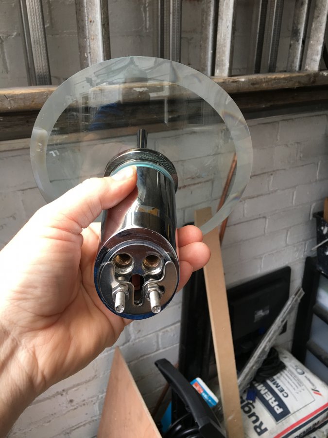

Hi is there a way to test a tap prior to fitting it to the sink or when fitted to the sink but the sink hasn't been fitted yet?
Like connecting it to a hose pipe to apply pressure to check for leaks?
Any kits, or parts I could use?
It will either be high pressure or low pressure, just make sure you buy the right tap for your situation.
Andy
But why are you worrying. Is it a second hand tap or something else that worries you.
why not try connecting it to a hose pipe to apply pressure to check for leaks?
Hi people, thanks for the replies.

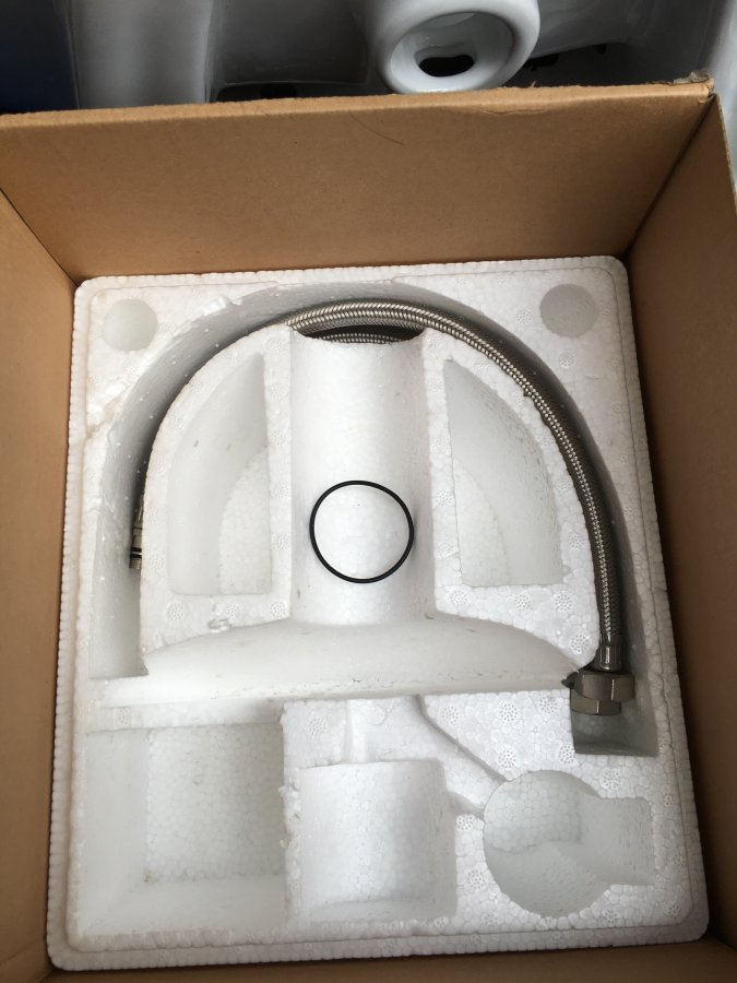

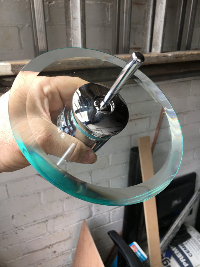

It's a fancy tap from eBay and I'm not 100% sure its good, it looks nice, but its going on a freestanding oak cabinet fitted onto the sink and if at all possible I would like to be able to test it first to find any faults prior to fitting the sink on top of the cabinet. just me being a bit OCD.
With regard to connecting it to a hose that was my primary idea but how to connect it up is the issue. I could do that in my garage and support the sink on blocks then run it as if its fitted.
I was thinking maybe jubilee clips some copper pipe and a shut off valve.

It will end in tears! Those taps are lovely looking but crap in normal usage.
Usage wise you will find that low flow will end up with the water running back up the plate due to capillary action and it will stain daily.
Had one fitted before and they were adamant not to remove it so had to make a "lip" out of milliput to stop the issues.

Note that if you connect just one of the tap's pipes to your hose at a time, water will probably cross over and come out the other pipe hole.
This doesn't mean it's broken.
