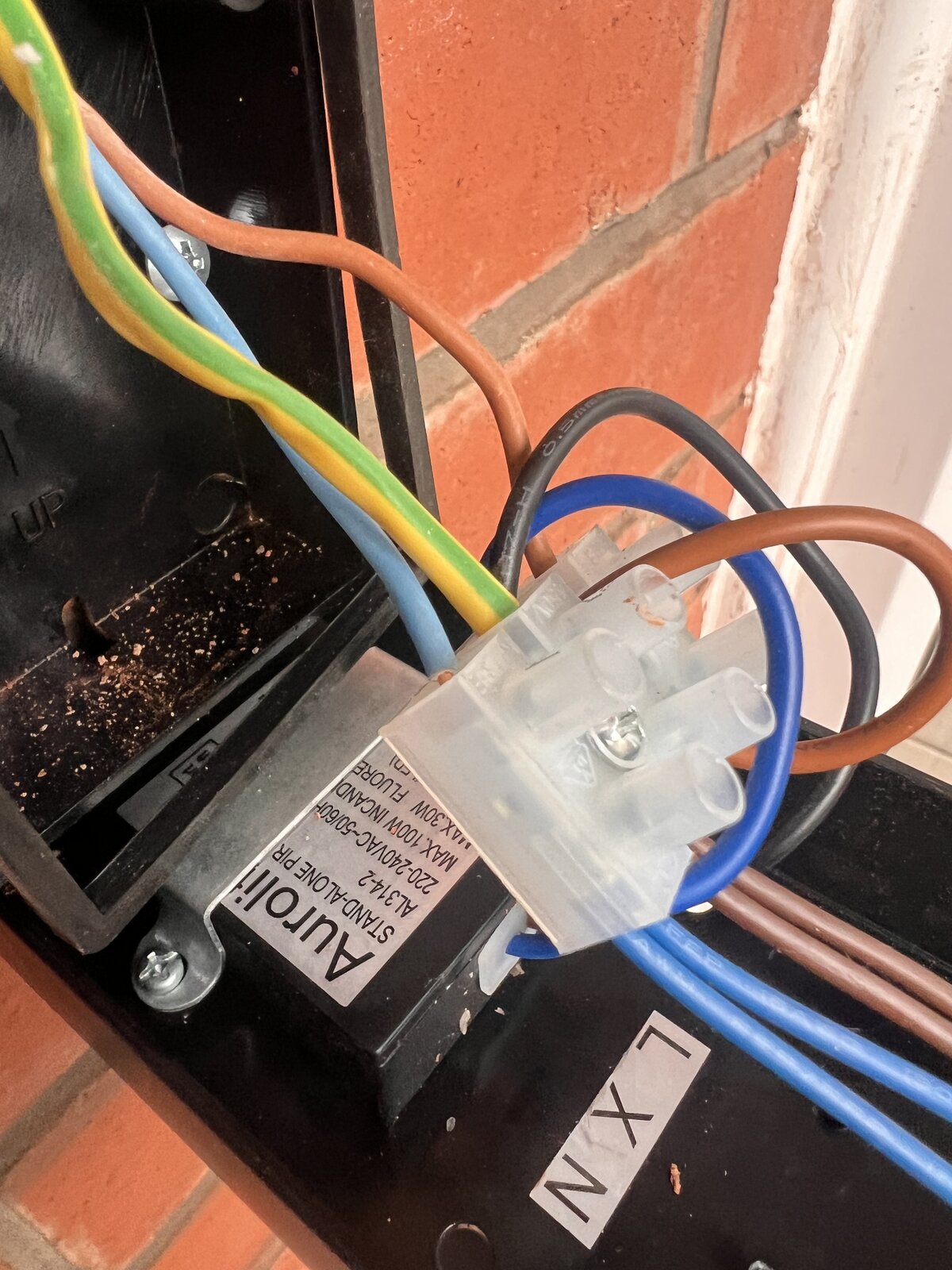

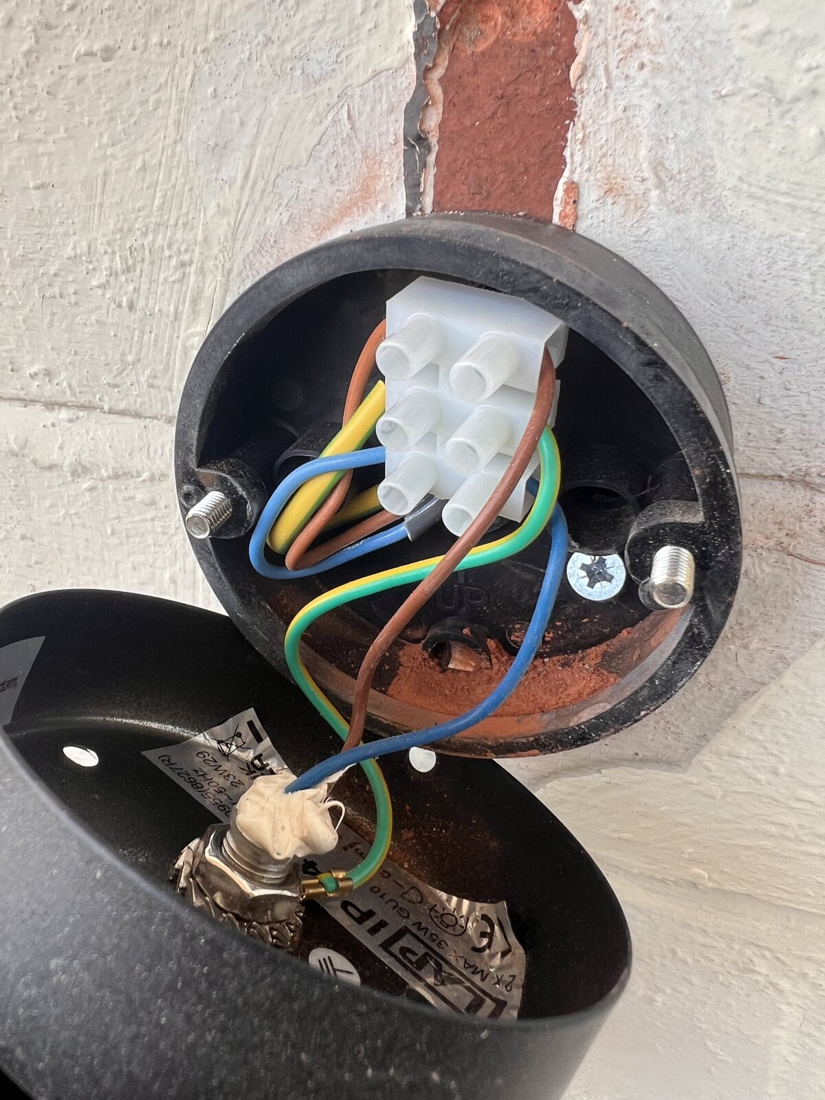

I bought this sensor light to swap for an existing one which wasn’t on a sensor.
The above image is the original light wiring
The below is the setup for the new light
Can someone explain what the earth arrangement should be on the new light?

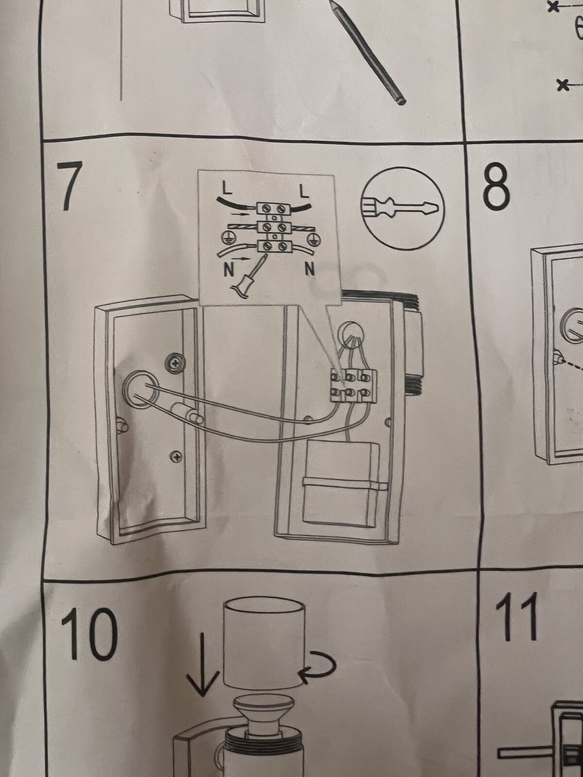

This diagram they provided only shows the L and N coming from the mains and not the earth.
Where do I put the earth from the switch?
Please not I have switch anything back on yet to test.
Picture 7 says earthwires go into the middle terminal of the connector block inside the lamp, though I do not see it in your photos.
Is there a symbol like this 1727171130423.png if so it is class II or double insulated and does not require an earth, otherwise an earth is required, I note the black wire, but can't work out from pictures where it goes, there seems to be another thread near identical to this, maybe you will find the answer on that one?
