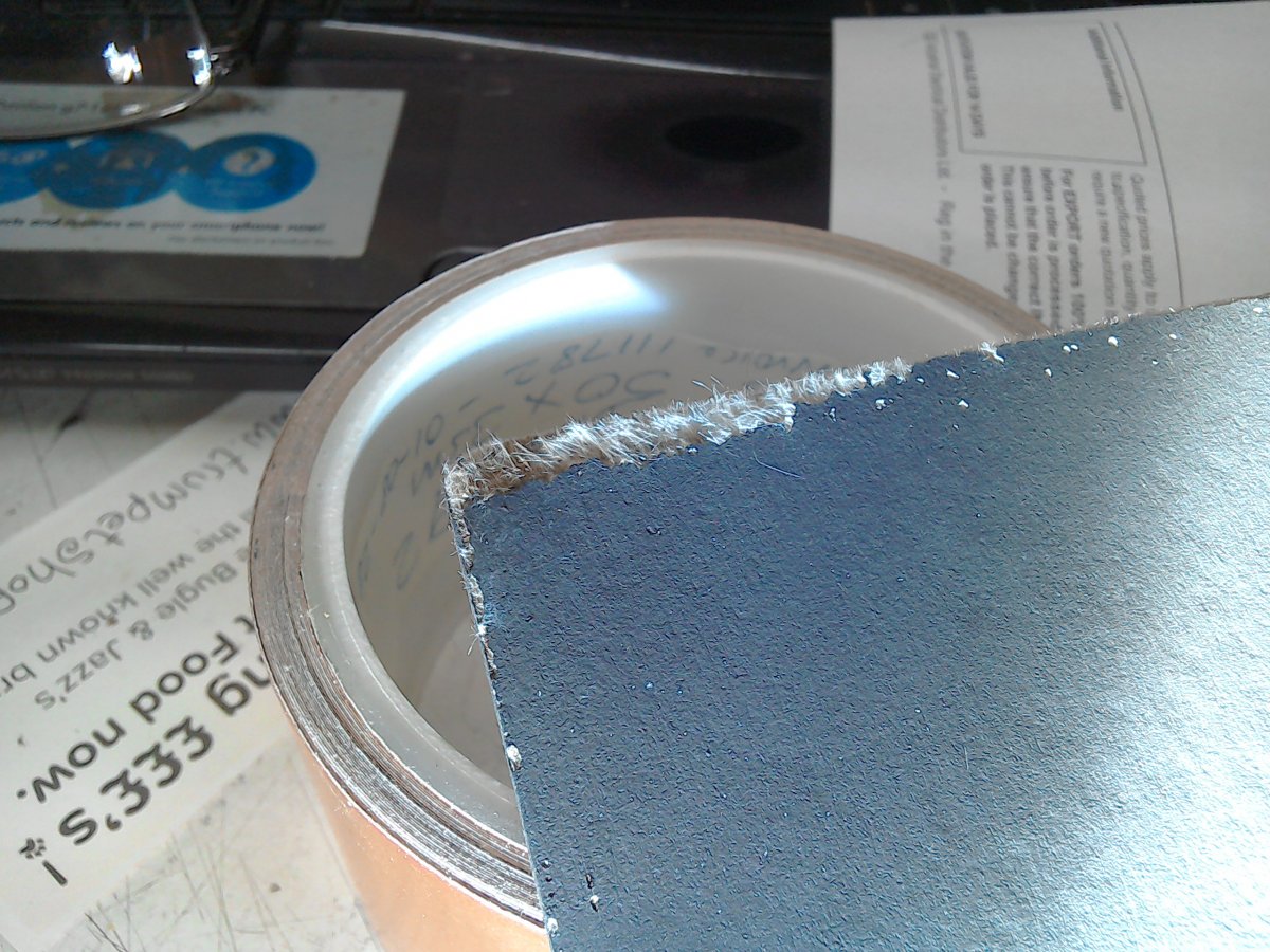

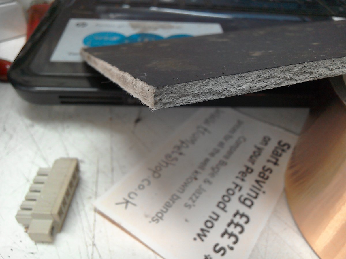

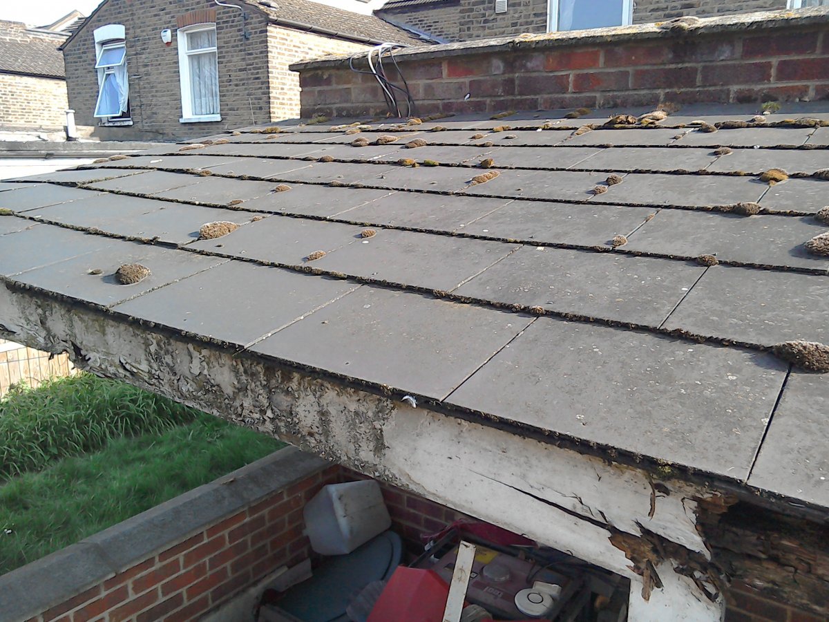

As per title, I took a small sample and heated it under flames on cooker, it glowed red hot but still it held together solid, good fire resistance material from the canopy over a shed.
I need to replace the timber supports as it is rotten bad and eaten away by wood lice, and wet rot, any time the roof could collapse and hurt or kill someone. So I need to strip everything out, is there any danger in stripping it all out and replacing timber supports? reusing the slates, they appear very fibrous. This was done in 1992.
Thanks in advance.

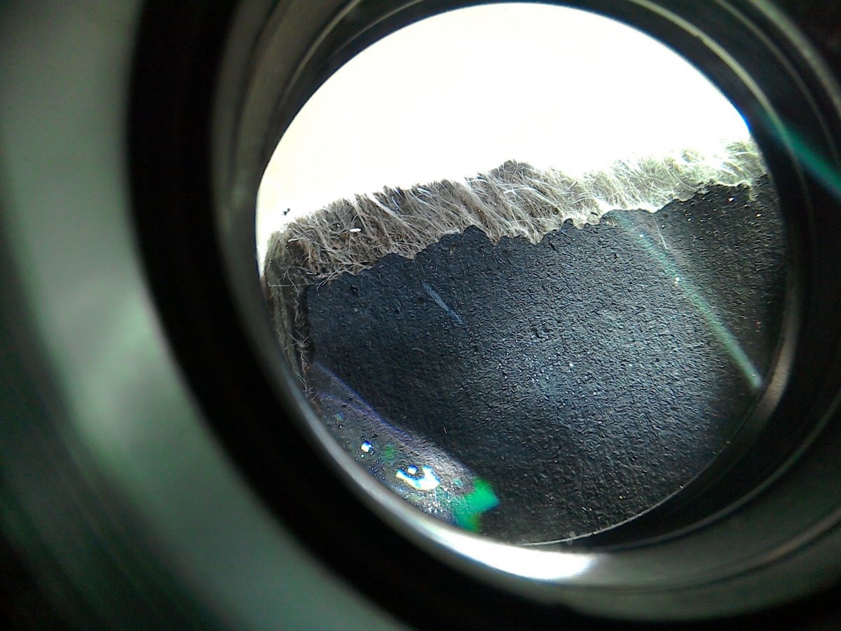

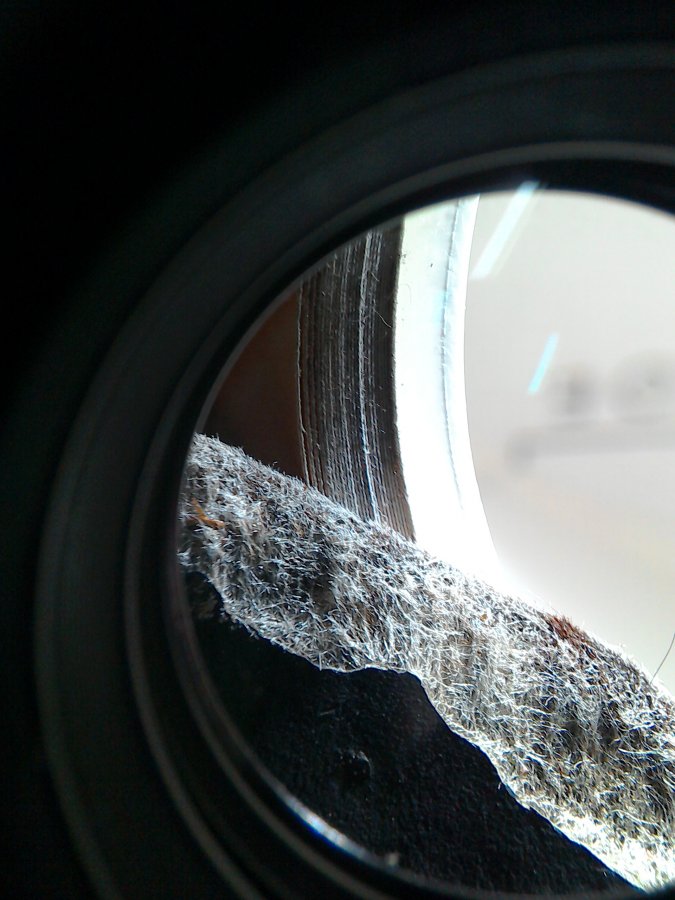

They look like modern fibre cement tiles to me, I think you'd need a microscope to see asbestos fibres not just a magnifying glass
Many Thanks, I just wanted to be sure, though I had my doubts, further more I think asbestos fibers are brittle, they would snap rather than stick out like tiny hair.
The Asbestos Awareness body says if you are not sure, then it is safe to assume it is asbestos. But even as it is, I am not so sure if any cement used in composing this material contains any or small amounts of asbestos component.
When I did the burn test, I wanted to see if it would burn to ashes or crumble away; by heating a corner under cooker flames, it got red hot, but it did not crumble away, or got soft. It remained solid, so pretty good stuff against fire resistance!

The only writing i can see on this is NABH. 03.03.93 (this looks like the date of manufacture, I thought it was build at the same time as my extension in 1992, but now I remember it was added short while after.
I think I am going to leave it alone and renew the timber supports from below, first by using braces, to hold it up and remove the front horizontal support that is what is rotted away bad as it did not have a gutter, and the 4x4 timber pillars could also be removed and replaced whilst temporary supports are in place, any 2x2 joists need replacing I could leave them in place and cover it with bitumen paint to seal and kill any wood worms inside, add additional joists if need be, and this could save me a lot of hassle, I can then jet wash the tiles to clean them out, also increase the slop by using slightly shorter 4x4" pillars.
I'm not sure that the "burn test" is the best way to test for asbestos.
How do you catch the microscopic fibres that are released by the heat, for examination?
I don't easily get scared from minor asbestos fibers floating around in the air, I have done much worst breathing of asbestos than this tiny 1 minute test, I used to be a car mechanic back in 70s and we used to use a compressed air hose to blow off brake dust from drum brakes! and I have also been a heavy smoker, for at least past 40 years, I will put any lung problem down to my smoking, however, wanted to see if it would crumble to a powder of some sort.
But let us see, those fibers you see in my magnified picture are not straight and sharp, they are curved and bendy, which would be a good indication that it is not an asbestos fiber, which would be more like a crystalline type of fiber, There is good chance that it has no asbestos, because those fibers in the picture hanging away from the edges got all burned off, so this indicated the fibrous material was some sort of non-fire resistant and got brunt off except the cement used held it all together. So therefore I am concluding that the material is safe, but always better to double check with other experts, just in case i could be wrong.
Secondly, if I were to remove and reuse these tiles, I took one or two, it was pretty easy, and no damage was done to tiles, just removing two clout nails in cross battens, they came off easy, and copper pins bent over were again relatively easy to take out. However to save lots of hassle I will be able to now replace all structural timber using acros and giving oit a temporary support, once done all the new facials will be of plastic board (dense board) as used in cladding applications.
A much better indication that they are not asbestos is that you can actually see them.
