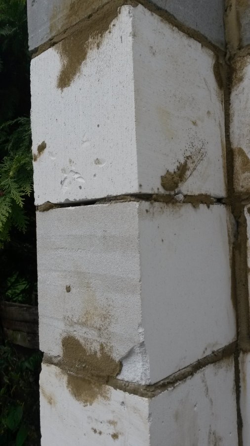

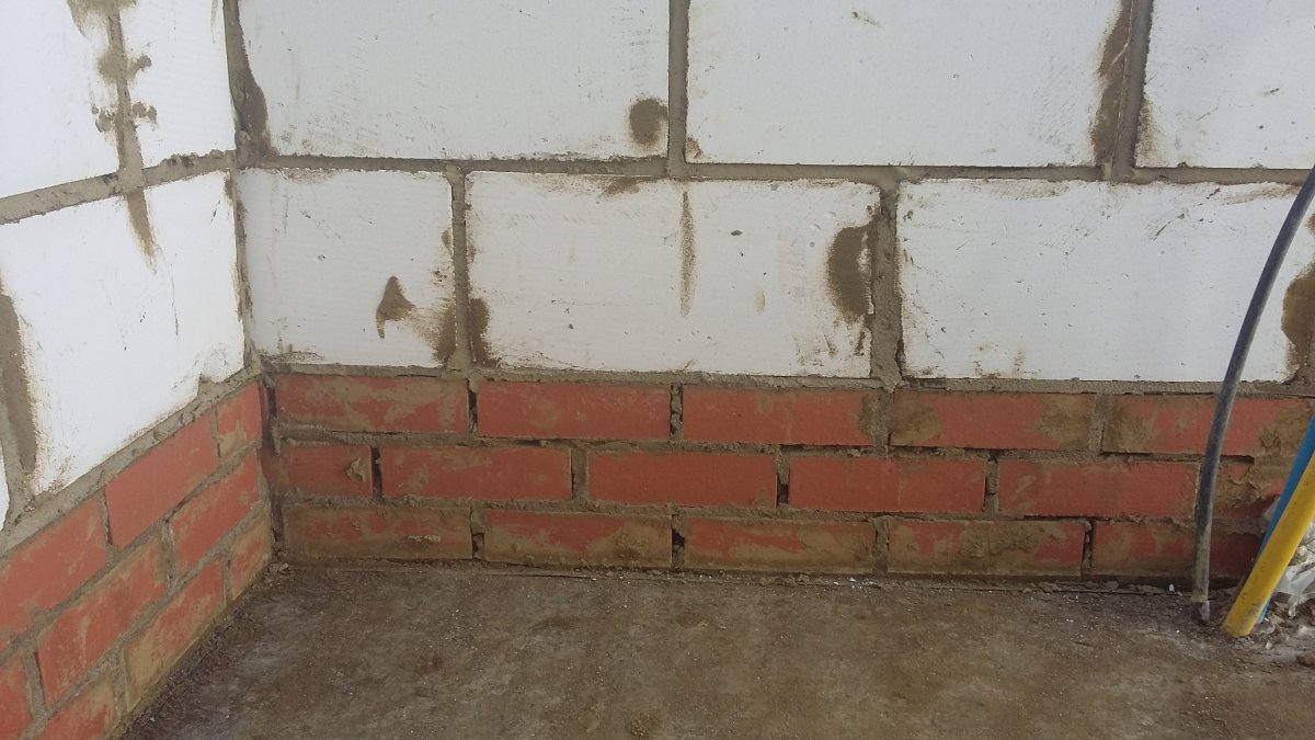

I'm building an outlet building at the back of the garden (5 by 6 and height is 2.5m), I'm worried about the quality of the work and any feedback would be much appreciated

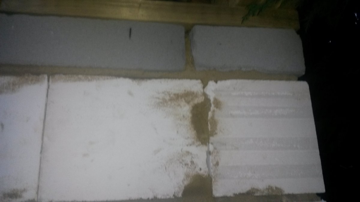

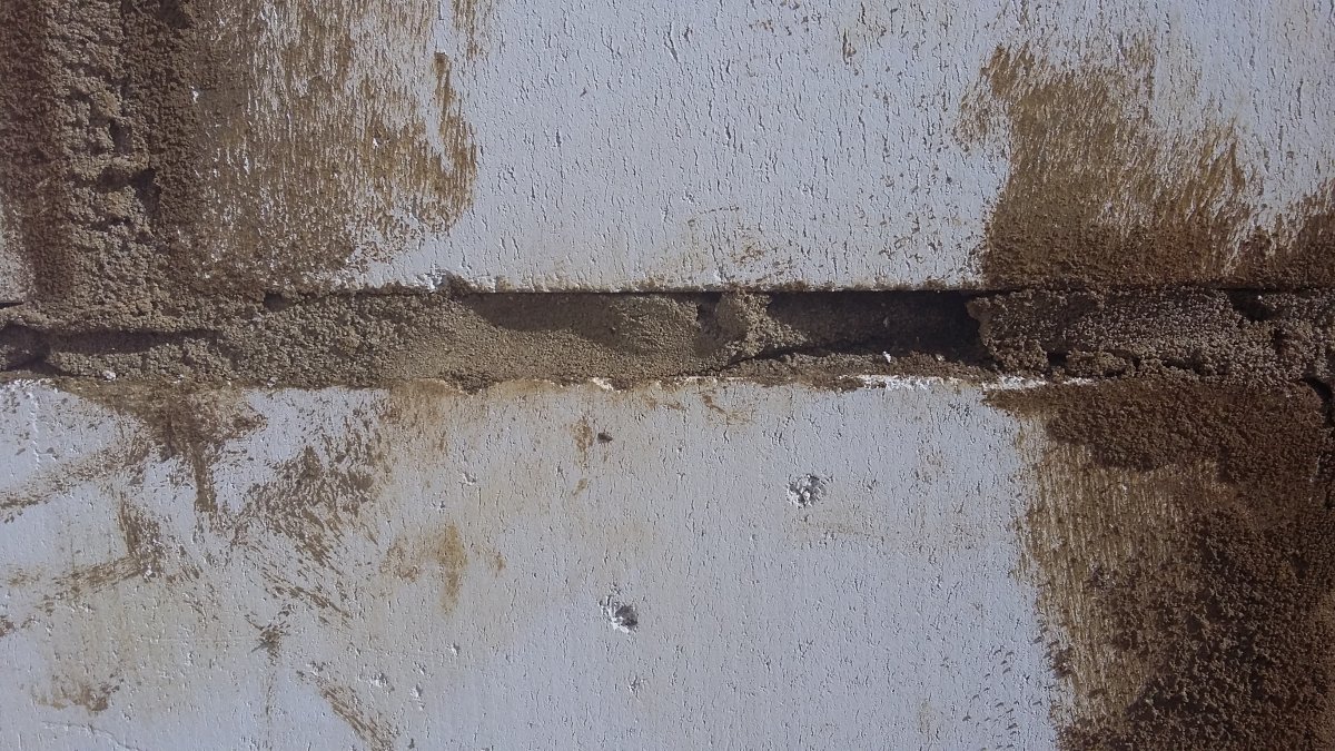

1. Bad brickwork on the walls? It seems quite messy and also there is two blocks beside each other that have no cement between them.
2. Are AAC "Thermoblocks" suitable for using as a wall in the building? (A single row of AAC thermoblocks are going to be holding the building)

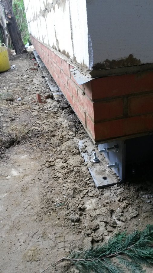

3. Does the foundation look suitable? It is a 1m foundation only at the corners of the building, there is a metal beam on the ground which is nailed into the foundation, and the bricks and AAC thermoblocks are ontop of the beam. This type of foundation was chosen by the builder because we have got big trees in the back.
4. The builder says concrete floor does not need air vent, is this true?
I spoke with the builder about the brickwork and he said he will just cover it all with cement so it's not visible, however doesn't the bad brickwork means bad stability for the building?

== Foundation ==
A metal beam with the bricks ontop, metal beam nailed to 4 corners foundation
(nail looks slightly bent already?! one nail missing?)

Easy one first- you don't need air bricks under a solid concrete floor BUT why the hell go to all that trouble of essentially pile and beam to support the walls and then groundbearing slab?

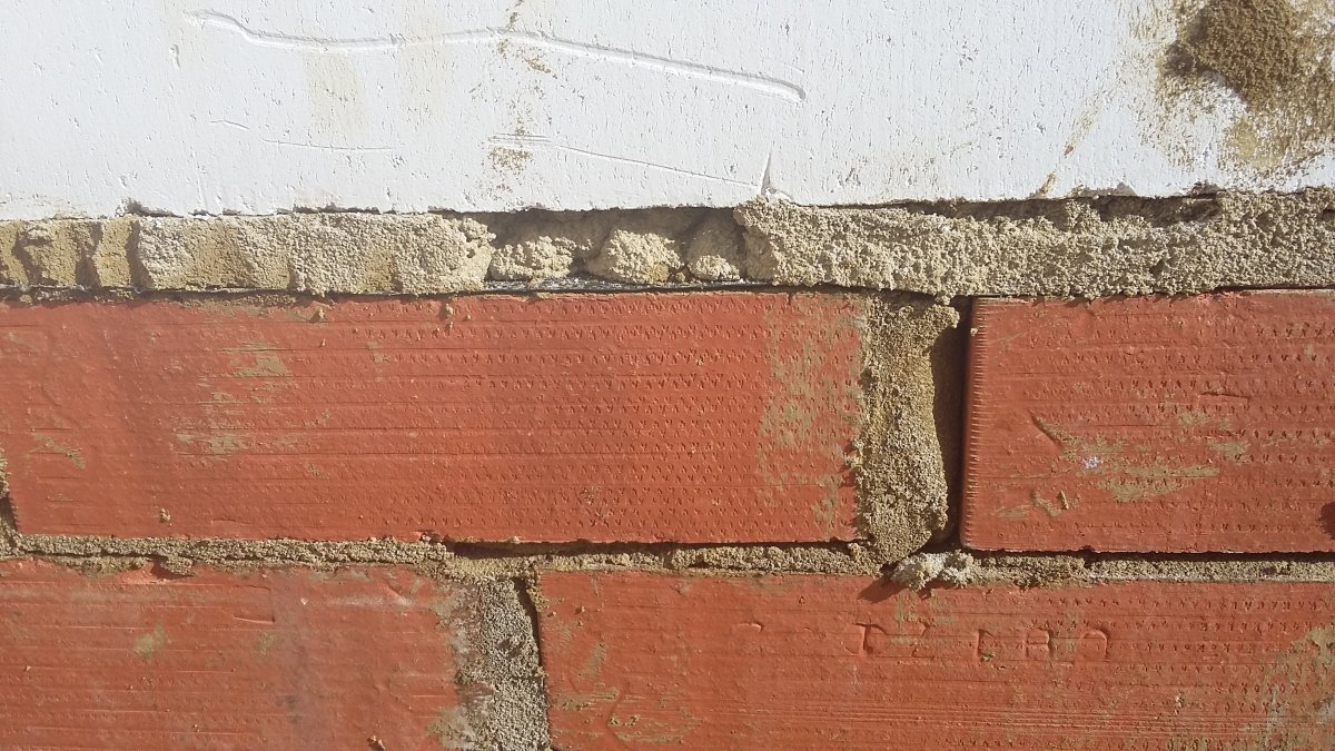

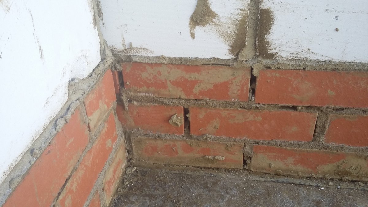

The mortar on the brickwork looks as if it hasn't been pointed- did you take the pics while he was working? If that mortar is dry then yes that's pretty poor, he's making work for himself if he points it from dry but the thing is unlikely to fall down. If the mortar was still wet then he'll point it up (usual to do that at the end of the day) and no worries. Actually, looking at those pics again the mortar looks dry and that brickwork is rubbish- bed depths all over the place and smears all over the blocks.
AAC Thermoblock- no idea. I Googled them, found the Indonesian supplier and lost interest. Try it yourself, sure there'll be a spec sheet on there somewhere. When you find and translate the spec, see how well they resist frost and what the recommended mortar mix is (might be something odd)
Oh your foundations by the way- they're not nails, they're bolts. There shouldn't be much sideways loading on them so don't get too worked up about the missing one.
Presumably you've gone for 5 x 6 at 2.5 to avoid the need for building regs? Pity, a BCO would be able to put your mind at rest re the foundation and block suitability.

Aaah, lightbulb moment- are you having the outside rendered? If so then that'll keep the rain and the creepycrawlies out (which are the main problems with crap pointing). Internally are you covering the walls at all or leaving them bare?

Yes a 215mm acc is fine as long as it's rendered.

They sound (and look) like thermolite blocks, so would need rendering on the outside, but I susect it might crack, so a mesh reinforced render might be better than a cement render. The pointing and finishing are crap, but the blocks look large enough not to worry about, but the builders being slapdash, so make sure you hold back some of the money for a few weeks to determine any problems.
If they can't get something basic right like laying bricks, blocks and the dpc, then I'd question their ability to do the other stuff correctly.
Btw, has that beam in that location been agreed by building control?
The cheap thin DPC they are using requires a mortar bed beneath the plastic layer. Seems they haven't bothered. They haven't trimmed it off either. Amazing smudging on the engineers.

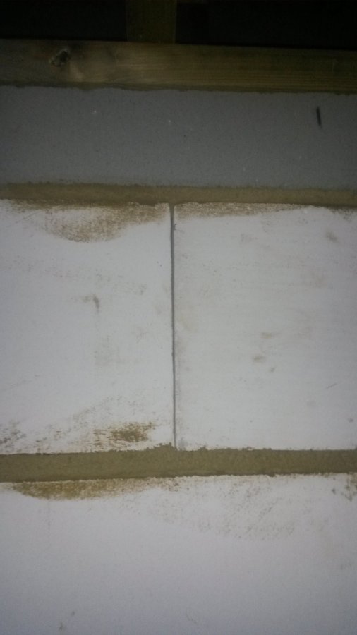

I saw these blocks seem to have no mortar between them?

Yeah the quality of the brick and block work is poor. I'd expect this from maybe the first or second time someone tried to lay them, most 'real' brickies would struggle to do this bad a job.

What is to stop that steel beam corroding in that location?

He said he would put a layer of cement around it, should that be okay?

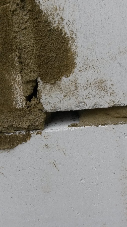

Checked it, some parts seem to have a tiny amount of motar and others dont
looking at the cracks in the blocks, looks like a bubbly texture
