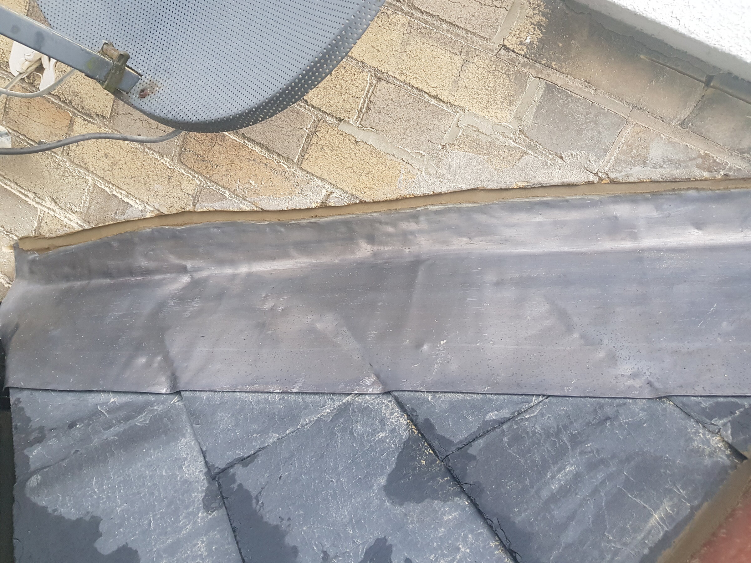

Is this a bodge job?
1 Aug 2021
2

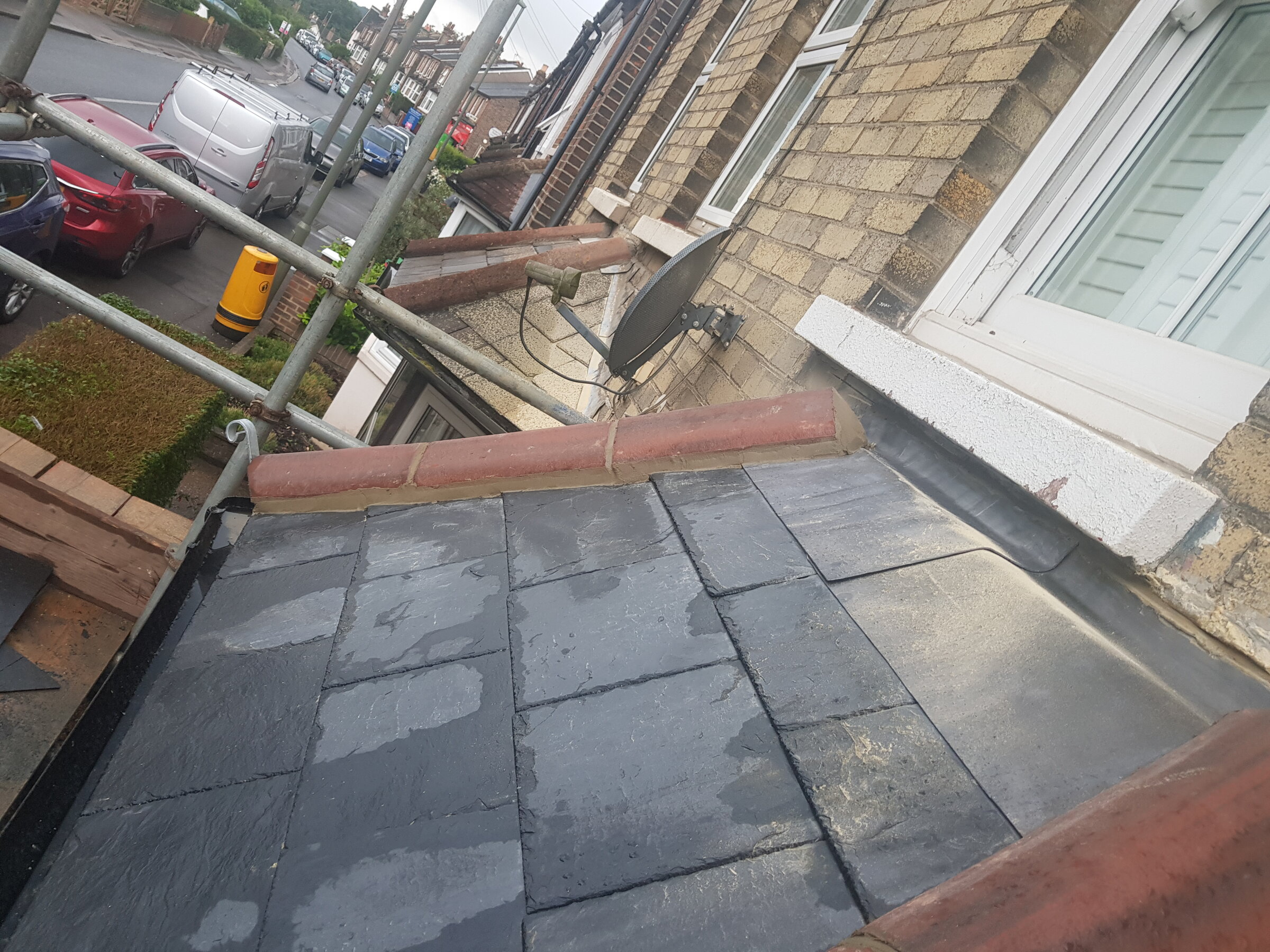

We recently had a bay window re-roofed. Does this look right? The flashing was done straight on the strong recommendation of the roofer that the mortar is too sandy to do a good step flashing. And one of the tiles is not flush. Finally the lead flashing is not completely tight on top of the tiles. It has a wobble. Is this normal? We feel a bit like we may have been conned which is distressing.
The total cost was £2,500 to replace two rafters, re-tile with battens and felt, and fit flashing, plus replace fascias and guttering. Lead was used for cover flashing (code 4) but aluminium for the soakers
We also feel this is excessive. Any advice would be much appreciated. This is a bit stressful.

No reason not to have had a step flashing and soakers .
Twaddle.
The straight chase isn't even straight .
The flat under the cill is a potential leak .
Roofer meant he didn't do stepped because it takes longer...

@datarebal what looks like a leak sorry? There are soakers, just cheap aluminium ones.
Don't need soakers with that job, need to cut 4 or 5 inches off that lead to make it look neater , as it stands it need some straps.
Reduce the lead ? And have no soakers ?
We always use soakers and we would have stepped that flashing .
The potential leak is the flat lead area under the window cill
Is it my imagination, or does the flashing under the window sill dip backwards towards the wall. And it looks like the overlap is only about 2".
I don't understand the comment about the mortar being too sandy. Surely the new mortar wouldn't be too sandy as well?
