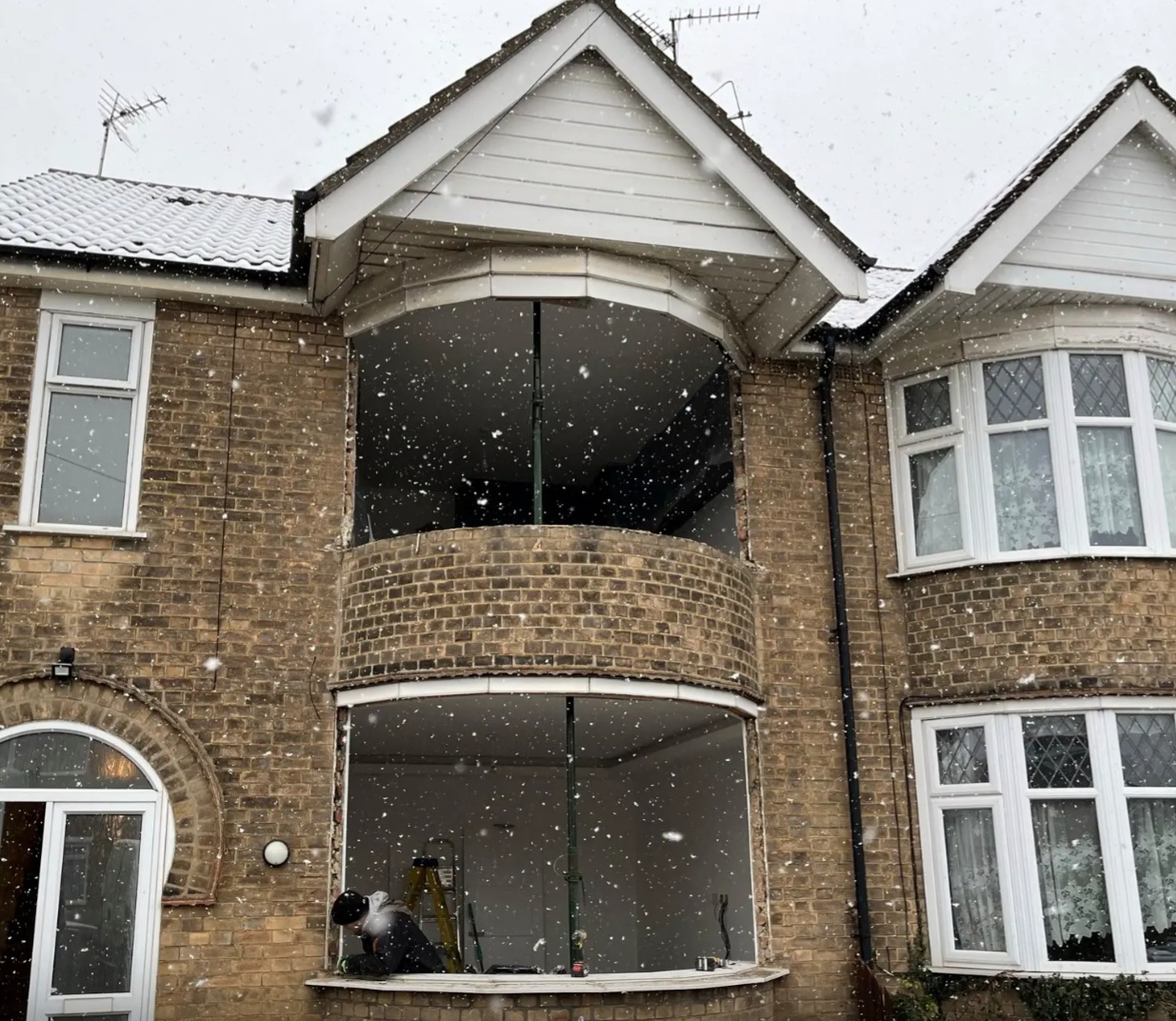

Is this a canterlivered roof
1 Dec 2009
5,985
1,393
Nationwide
Evening guys, theres a thread running over on windows that is nearly at a satisfactory conclusion but it depends on whether this is a cantilevered roof or not, any advice to the OP i'm sure he'd be grateful for
that has got to be a cantilevered roof
its possible a bit of load is being transferred from the ridge down by a post to the joists -but the window cant be supporting the roof, no way.
#IAintNoExpert but would the answer not be found if the owner ventured into the loft?
Been suggested but owner doesn't know what he's looking for
So he couldn't have gone up and taken x pics of the area to give folk an idea? Surely he could have pointed a camera in the general direction.
