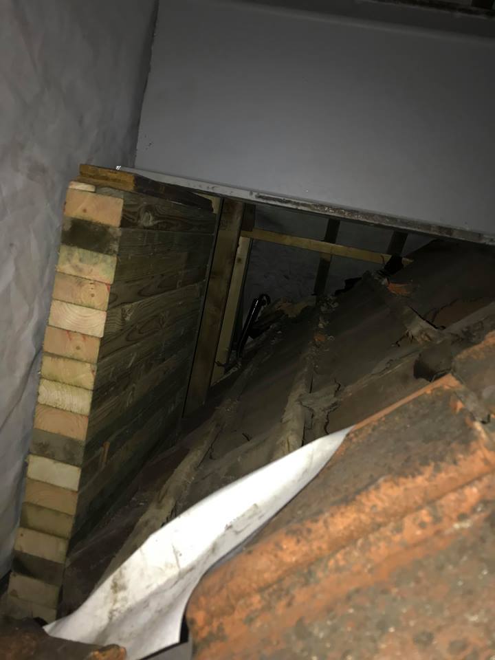

Is this a safe way to support an RSJ?
11 Dec 2018
5
We are currently having a hip to gable loft conversion done, and having the steels put in, the builders have built up the side wall with c16 carcassing timber. Has anyone seen anything like this before?
I'v checked the plans, which simply state "build up wall", but don't give a spec. I would have assumed that it would be a continuation of the inner leaf which is engineering brick.

It's probably a temporary arrangement. We often dry pack a steel then Acrow prop it and build under, once there is stabilizing weight on top.
Does your structural engineers drawings say:
'use 15no 5 x 2 timbers laid flat as a padstone' :mrgreen:
Maybe the builder likes playing Jenga? I really want to tap out that one five from bottom.
Seriously though that is a bloody funny temporary propping, I hope there are a couple of acros out of sight taking the weight of the beam if that Jenga pile does go.
I spoke to the builders today and its looks like that is intended to be permanent. There is a steel bearer on the top which is at to spec, and they have bolted the timbers together, and will put timber frames up each side. I've spoken to building control and they said it was "unusual", but that they would review the plans and the structural calcs before deciding if it was wrong or not.
If they have put a steel spreader plate directly under the bottom flange of the beam, it could well spread out the load so that the crushing strength of the timber is not exceeded.
But overall, it does not look to be a stable arrangement. Maybe they do it that way in Eastern Europe?

Whats stopping the pile of timber falling over towards the beam shoving it thru whatever is opposite? [What does the other end sit on?)

They are intending to build up either side of the stack with vertical beams into the dormer structure. This should (theoretically) secure the beams in place and stop any movement. The other side of the beam is on a 100mm steel bearing on the party wall opposite
Is the grey thing really a steel beam?? If so,it's a whopper.
It does look massive (y)
Judging by the 2" timbers its sitting on, it looks to be about 350mm high -seems awful big for a roof steel.

Thanks Pete. That was the first thing i did when I saw it. The builders are continuing work, but they have confirmed they wont cover or conceal anything before BCO has been out to examine the structure. I will post an update with what they say :)
Its 356mm. The span is quite long at 8m. I was a bit shocked when i saw them craning it off tbh, but that is what was specified.
