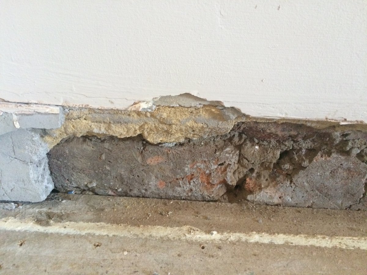

Hi, can anyone tell from this photo what materials have been used on my internal party wall? It's at the base of the wall where it meets the floor.
I've posted about damp on it and have been told by a damp specialist that the grey is carlite plaster which has been wicking up moisture and I need to hack it off, get a chemical DPC plus waterproof sand/cement render. However I have pulled a chunk out and wonder what the yellowish material is above/behind it (which he didn't see - he said the whole wall was carlite)
Is it just a plaster base coat or could it be a sand and cement render and might it have previously been applied to the walls to hold back damp? The carlite plaster only seems to run to the height of the lowest brick so might it just be there for the old skirting to attach to?
I can't knock picture hooks in up above holes have to be drilled so surely that wouldn't be the case if it was all carlite?
I've had the house 24 years and had the walls skimmed 10-12 years ago. The damp is manifesting itself as a dark patch - no salts, no yellow stains so I'm wondering if it's coming through the carlite up the face of the plaster skim without touching the assumed sand/cement render below? Might it explain why there's no damp on the other side in my neighbours house?
If so, could I avoid the need to have it all hacked off if the origins of the damp was resolved (currently assumed to be damp in the hearth/chimney breast and it was allowed to dry out? Thanks.

So I had a plasterer round who said it is a sand/cement render and could be tough to remove. Do I really need to get rid of it only to re-do it?
With the 3month drying out time plus the minimum 2 month notice for the Party Wall Act, would it make more sense to do a chemical DPC then batten and plasterboard the wall?
You won't need a party wall agreement for replating the wall. Cutting and inserting a dpc, yes, but not plastering.
Also you needn't wait 2 months, on the template letter there's a clause they can tick so you can start straight away.
Even if my neighbours save me the 2 months on the Party Wall notice I'd prefer to avoid 3 waiting months before being able to redecorate. Is the idea of plasterboarding feasible? Thanks

Looking at that wall I think a couple of hits with a hammer would take it off with little effort.

If you've got bonding on the lower bricks, then yes, it's crept up the bonding, and then up the plaster. But did he damp specialist do a drill test to determine if the bricks above the normal dpc level were dry or wet, because if the damp is coming up through the bonding, the DPC may be fine.
If you knock off the bonding, then apply sand and cement with a waterproofer in it, you may find that that's all you need to do.

Doggit - no, no drill test, but in other more saturated areas the brick dust seemed moist so that probably closes that avenue.
Tomfe - it's been pointed out that there's a damp course on the front external wall and also under the floor on the other party wall. Also they are not the original joists and they're also on hangers. The conclusion was that the house has had a damp problem which has been treated, presumably more than 25 years ago as I've had it that long.
A plasterer not a specialist pointed out that there's no through ventilation from front to back of the house because my front garden is only a brick lower than my living room so I understand that a French drain will be needed. Another thing to factor in...

The damp specialists don't tend to do a proper inspection because they might find the problems localised, and they'd lose work. If there's been a problem in the past, then it may well have been eradicated, but someone just messed up putting bonding behind the skirting boards. A drill test uses isolated probes, so avoids picking up moisture from the plaster. It might be worth getting a couple more companies in, and ask a few more searching questions to show you can't be bulsh1t.
My partners house was built 1930, and has cement rendered walls, and it seems to be a common way of doing things back then, because it's upstairs in the bedrooms as well.
You'll also need a few telescopic airbricks to get the airflow through, as this was very likely why the old joists needed replacing. If the joist end rot due to damp walls, you tend to cut out the joist end, and bolt a new piece on.
