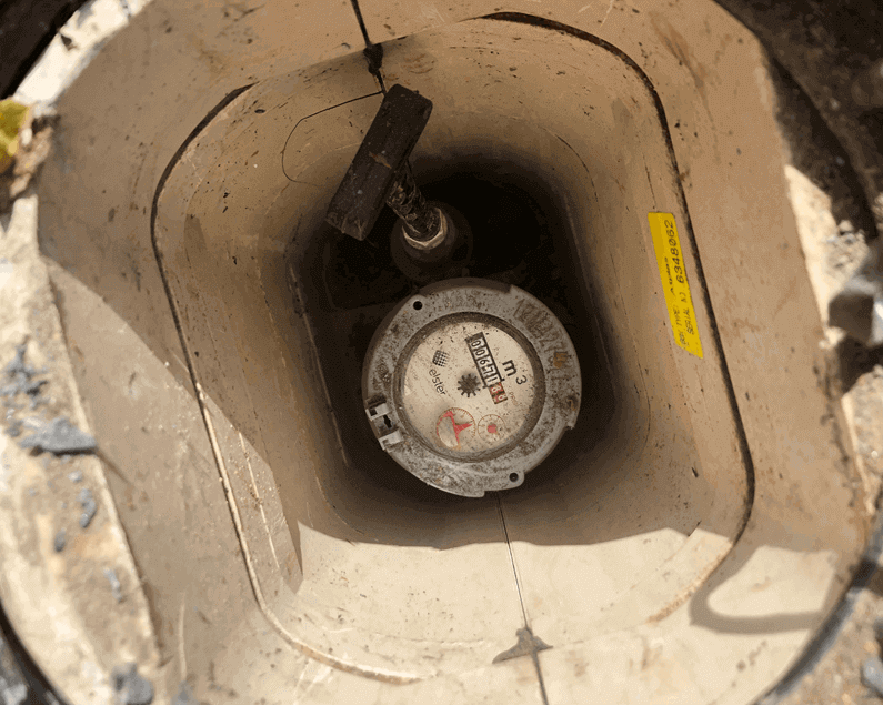

My parents have just had a massive estimated water bill, which has upset dad, who’s 80 and got severe depression.
A few weeks ago, the stop valve/water meter on the pavement outside their house sprung a leak. They reported it immediately and Thames Water fixed it, but only after it had gushed out water all down the road for a fortnight.
I went to read the meter today so they could submit an actual reading, but was met with this… Is this even a water meter any more?
I can’t see anything obvious, and the white disk with a hex head on it doesn’t want to come off.
cheers.

But the images online show the meter connected to where that hex head is!
So the workmen removed their water meter without their say so?!
They’ve been metered for about 20 years, and it’s saved them loads as they hardly use any water.
No it’s not a meter, and it’s also not his responsibility to pay. Thames Water would be liable for the boundary stopcock as it doesn’t appear to be his side of the property.
Possibly, if it was the source of the leak.
Reinstating a water meter may take more administration and time to sort out, than carrying out an emergency repair with what they had on the van?
...and the water meter is their property. But as @CBW says above, it is not his bill to pay! :)
The "administration" is irrelevant, the companies WANT us to have meters. But , yes, it may have been a temporary repair using materials to hand and the follow up work has been fouled.

Thanks guys, that's brilliant. Nice to have it confirmed that I'm not going bonkers and their water meter has actually vanished. And thank you too for all the helpful suggestions to get things resolved.
Mum and dad were using about 4m3 per month previously, as they've always tried to be pretty frugal with their water and energy usage.
In contrast, my wife and I and 3 kids use about 10m3 per month, and we shower every day and run the washing machine and dishwasher a lot.
For unknown reasons, Thames Water are now estimating my parents' usage has shot up to 15m3 per month.
All I can think is that the crew who repaired the leak on the pavement and removed the old meter submitted the reading from the now-vanished meter on their "paperwork" and that this was artificially high because of the leak.
