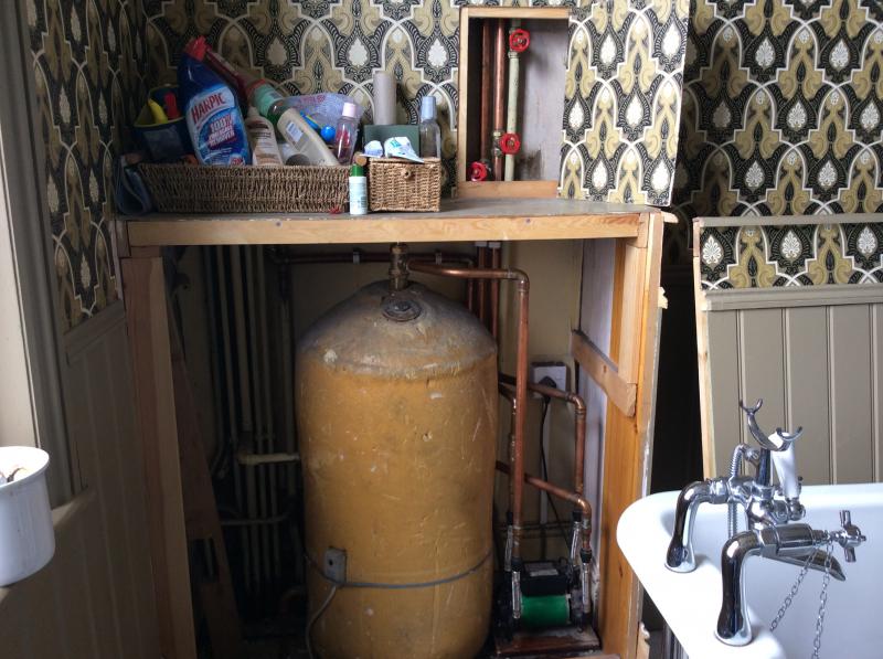

Hello I hope someone out there can help me.
My power shower has started playing up, the pipes either bang loudly or no hot water comes through at all. Could this be a airlock and how can I fix it if it is?
Here is the pump and hot water tank:

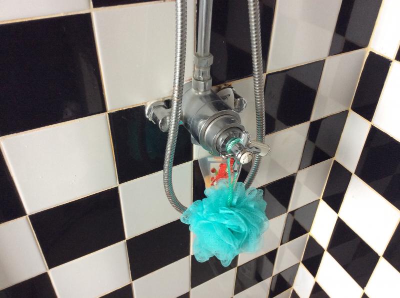

The shower mixer:
We have a cold water tank in the loft (2floors up) and the shower is slightly higher than the pump but on the same floor.

You can first try running the shower with the pump switched off
Check to see if the pump filters are blocked
Remove any air by removing the flexi connectors (after shutting off the isolating valves) and then flushing into a bucket
Check to see if there actually is water in the tank

Try the following:
Isolate pump.
Isolate cold and hot supplies to the pump.
Remove shower mixer valve.
Slowly turn on the hot water valve and check flow through to valve.
Repeat for the cold.
Reassemble and reinstate water supplies and electrical supply to the pump.
If these are ok, assuming that the pump is fine, the shower mixer valve may need some maintenance work.

I was thinking that the mixer valve looks a little lime scaled. So I might start there.
I have not taken one of these apart before so can someone check my thoughts:
Isolate water coming from the pump.
Undo the two pipes that come through the tiles to the mixer head.
Pull the mixer unit off the wall, dismantle and inspect for corrosion and lime scale etc.
Fit as reverse.
Is it that simple? What is the larger diameter part of the mixer that is sunk into the tiles? I'm assuming this will just pull out... Is that correct?

I have removed the cartridge from the shower mixer, cleaned it and replaced. Now that the cartridge is back on the temp dial ( which has never really worked very well anyway) makes the shower run from full cold to pulsating the pump and very little water coming through when it's turned to hot....
More tinkering: I removed the mixer valve as suggested earlier in this thread and with the hot water on full only a dribble comes out and the pipes are banging gently.

If you look at the hot water outlet on the pump, there is a brass valve. This could be sticking, restricting the flow through pipework. As for the banging, hard to say without being there.
James.
Hi james,
Thanks again for your reply.
I don't think it is a valve, seems to be a bleed nipple.
When I open it water squirts everywhere.
I'm sorry but it looks like a check valve as the screw is used for testing. What should have been fitted, (if required) is a non-return valve. The main difference is that a non-return valve has less resistance than a check valve.
James.
