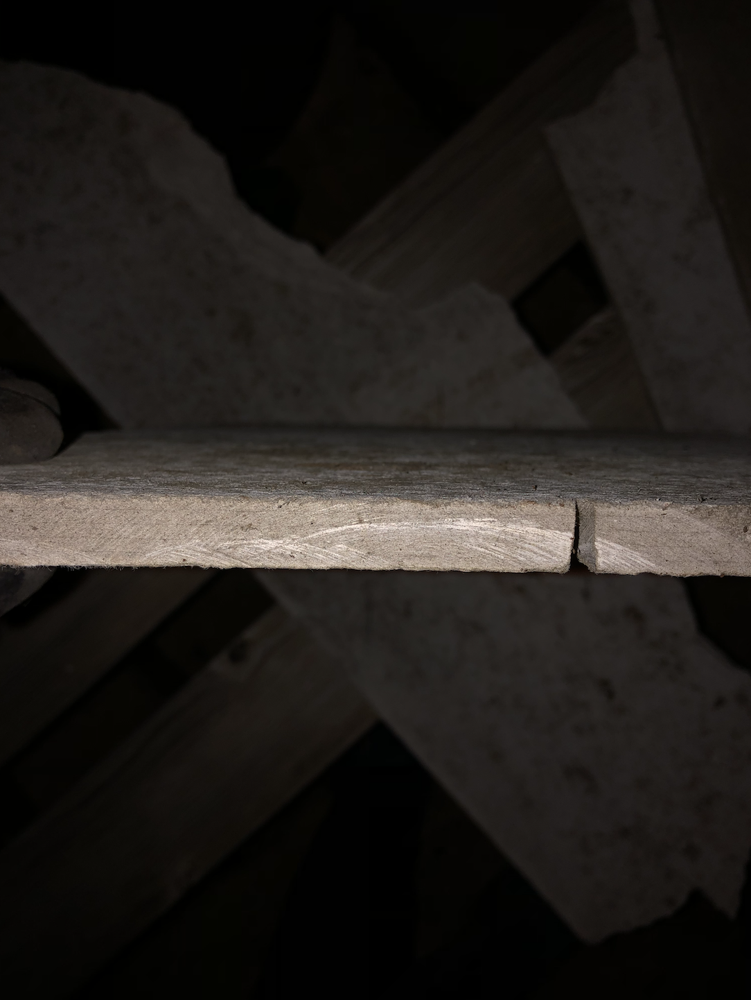

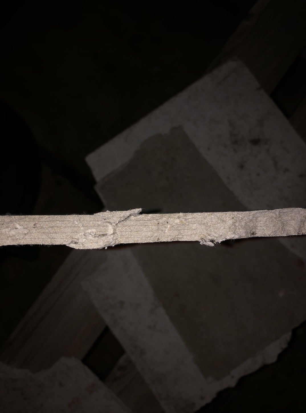

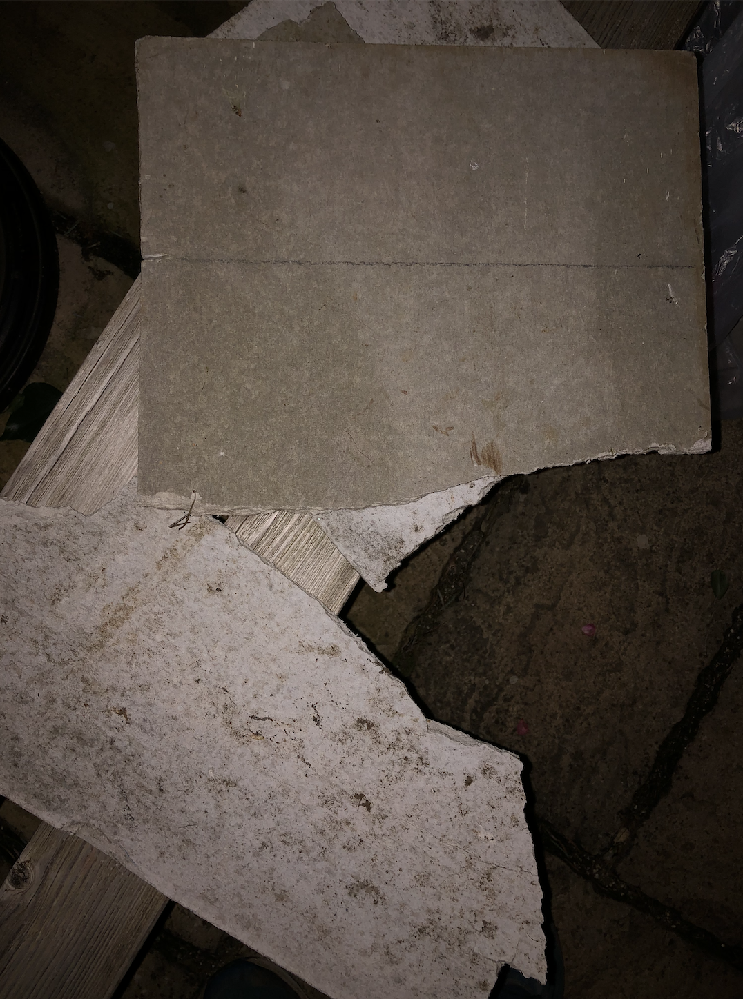

Is this an asbestos board?
5 Mar 2021
2
Hi. I found what I thought was a normal plasterboard behind my shed, which I moved there from our garage a little while ago. We moved into our property in 2017 and had some work down and assume it must have been left from then. I used it a few weeks ago as a solid base to chop some wood on for our fireplace. When it cracked after chopping several bits of wood on it I saw that it was quite fibrous on the inside and now I'm questioning whether it had been in the garage previous to us moving in and is an asbestos board. I imagine it's difficult to tell from these images, but the only defining aspect is the layers in the board and whether that's a clue as to whether it is asbestos or not? Thanks for your help in advance.

The clue would be the age of it or where it came from. In the absence of those the only way to tell would be to have it sampled and tested.
If it is asbestos it will be the more hazardous AIB, so be careful with it in the meantime.
Thanks for your reply. I have contacted the company that did the work at our house at that time to understand if they recognise the boarding and identify what it might be. Failing that, a test for peace of mind might be the best way forward.
Looks as if it may well be asbestos. Many local councils will let you dispose of it. It needs to be double bagged and identified. If you don't know what you are doing or what PPE to wear get professionals in to dispose of it.
I got rid of a garage roof for £400 so it shouldn't cost much for your bit.
It looks as if it could be asbestos, from the photos. Keep it outdoors and undisturbed, preferably wet. Put a sample in a double plastic bag to take for analysis.
The firm would be foolish to admit any knowledge of it if it is asbestos.
AIB is different to cement sheet, and councils may not accept it, and private removal costs are greater for AIB.
