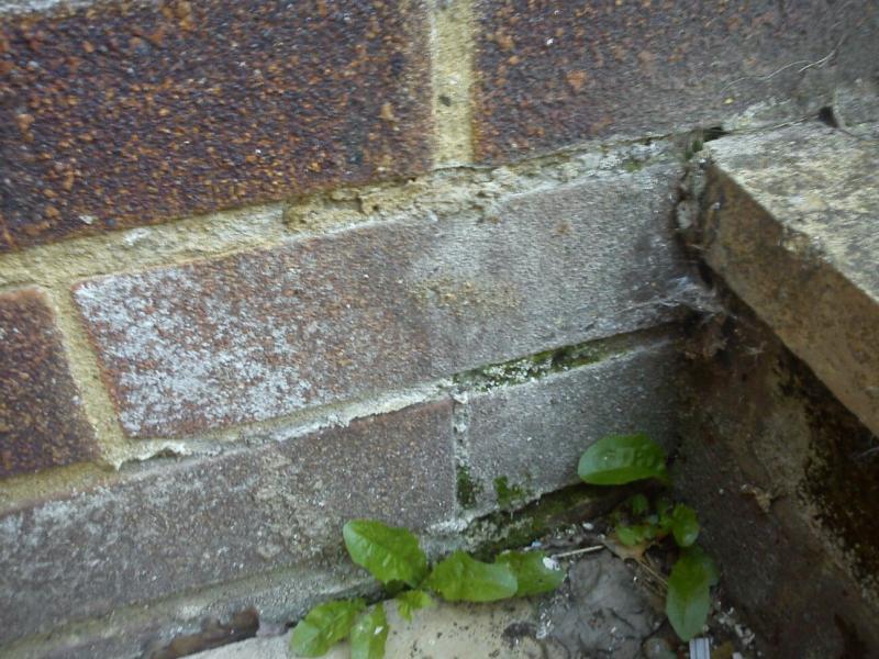

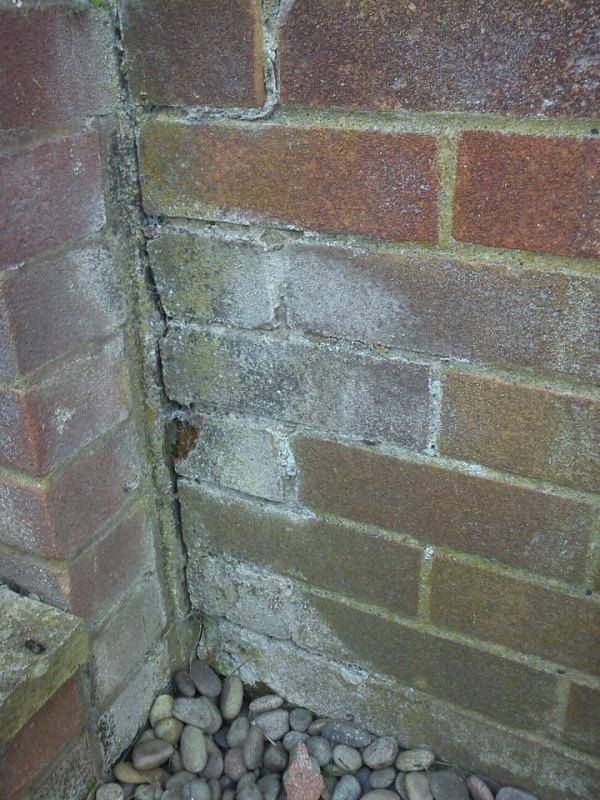

Hello, I recently moved into an end of terrace house and have subsequently noticed some damage to the brickwork below the damp proof course in the back bottom corner of the house, where it meets a raised brick/slab patio in the back garden.
The survey I had done made no mention of this, but as I have no idea about these things I thought I would gauge some opinion to see if it's likely to be a problem at some point/worsen.

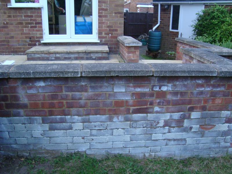

The patio brick wall itself has plenty of efflorescence on the bottom half and - on the far side, away from the house where the patio brick wall is visible from the rest of the garden - has a fair number of bricks that have become calcified, which is what led me to noticing the brick damage visible on the house.

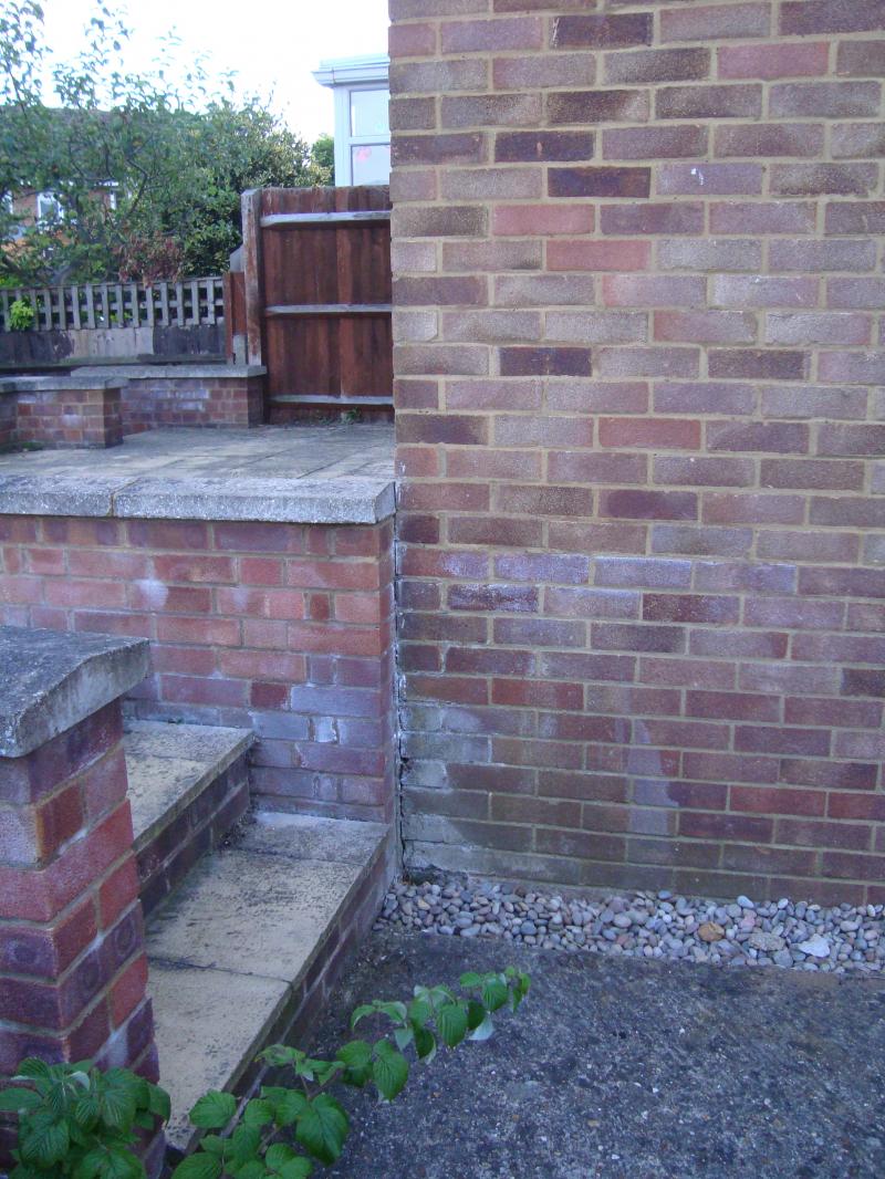

The first pic shows the house brickwork, right, where it meets the raised brick patio, left (the first step up to the patio is visible, bottom left)...

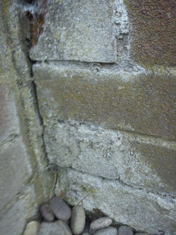

The second pic shows a close up of the brickwork from the first pic, which is below the damp proof course...

Efflorescence. Not a problem
Thanks Woody. Are you saying it looks like efflorescence in the pics? Ordinarily that wouldn't bother me, it's just that some of the bricks in the picture have lost part of the edges - look a bit like they have crumbled somehow.
They look like London bricks, which are the worst bricks in the world for frost and water damage leading to blown faces and edges
It looks like someone did not take care in protecting the patio walls/bricks from damp when being built
Thanks for the reply Woody. Is it anything to be concerned about in terms of the house bricks? Obviously it looks unsightly, but it is any repair work that may be necessary on the house that is the real concern.

It looks like you have london bricks on the patio walls and the house
On the patio, most of the staining is because of the higher retained ground level causing the wall to stay damp
The bit on the house is probably dampness related too, but it seems to stop at the DPC level. It may be damp leeching across from the higher patio ground level near to the corner
Efflorescence is always just cosmetic
Don't mean to jump in here. But thought i should point out that this patio seems to have been built well enough but there is no weepholes, as far as i can see, for water that falls on to the patio to escape. If this is the case then the water will soak right into the surrounding walls And much of it will stay in the walls.
Does the patio have a fall on it ? Or does the water just lie there until it dries up ?
If you are thinking of renewing this at some point anyway i would just drill out 4 or 5 half brick size holes in selected locations where the water could run out. It will at least stop things getting any worse.
I'm only giving this advice from what i can make out from the pics.
I don't think this will have damaged your house. I do think you're right to get rid and start again.
