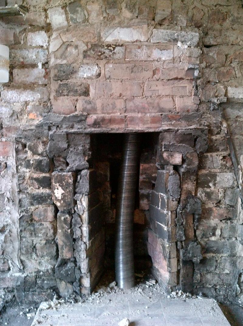

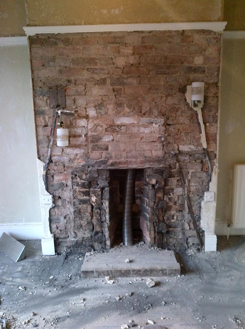

Those bricks are to messy to point up.
Cut out the opening then get some reclaimed bricks and build the surround in front of the existing, it would look good done with some black dye in the mix, then rake the joints back a bit.
