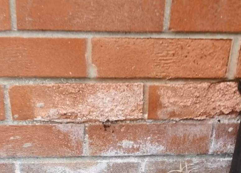

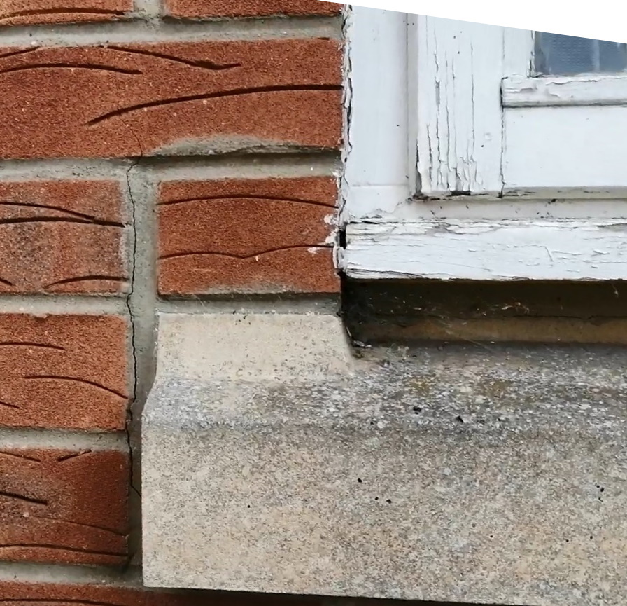

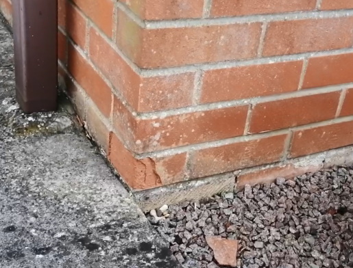

Is this crack anything to worry about.
4 Apr 2021
22
2
1994 Bungalow. The crack, although fine, does go through the brick vertically. There are also a few assorted spalled bricks. None of which exist on any of the other properties built at the same time.
You thoughts are most welcome :)
There crack its nothing. The spalled bricks is frost attack on unsuitable or bad bricks. Common.
